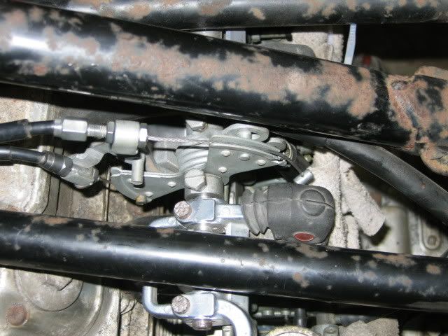

While reassembling, and working on my bike today I decided to mount my carbs so I could see how much extra space I have to work with.  I also decided to hook up the throttle cables while I was at it so I could check operation as I tried to dream up my electrical box, when I realized that I think I got the wrong pull cable.
The cable was from a 72 750, I have a 74 for the most part.  Well this cable has about 4 and a half inches of cable past the end of the housing, which seems to be way to much for my application.  Me thinks the cables are not interchangeable, can anyone shed some light on this for me please.

I have decided to go with drag bars on this bike.  And i do have plenty of slack and have them run to use up as much as i can.  They are stock length cables.  I am,also using an aftermarket Emgo throttle handle.  The push cable seems to be fine but when I hook the pull cable to the carbs and then pull it thight the treaded barrel is so far behind the cable mount I can't secure it.
If pictures are needed I can get them tomorrow.  I'm just a little comfused.  Fabricators' 75 750 is sitting right next to mine and it looks like there isn't near as much cable showing as mine has (and his has clubmans on it right now, and works fine right now).

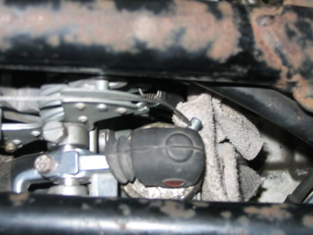

It might be a fitzall but I doubt it.  But here is what I don't understand I thought there was only one pull and push cable for all bikes up until the carb change.  These were supposed to be off of a 72 750 but I'm not so sure.  I have tried everything I can think of to shorten the cable in the housing but nothing has worked.  I measuered a different set on a 75 750 and it had about half the length of cable showing as mine does (that had about 2 and a half inches my current cable has 4 and a half inches showing).
I got some pictures to show what I'm talking about hopefully this helps, if not I hate to say I think I need to buy another set of cables. >:(

What I was refering to was the length of the cable in the housing.  I measured the length of the cable after the housing stops it measured 4 1/2 inches.  The 75 right next mine only measured 2 1/2 inches.  They are both overall stock length but the internals are on my pull cable are double that of any other I've seen, but the push is the right lenght... go figure.
