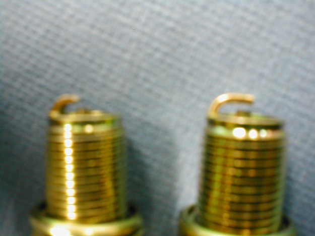

Modify Your Spark Plugs For Free Horsepower.
There are many gizmo's that have claimed power increases through out the years ( splitfire spark plugs, indexing spark plugs, etc ).
Here is a modification that works:
Bend up the negative electrode on your spark plug and cut approx 3/16 off. File the sharp edges edges and bend the negative electrode back to your desired spark plug gap.
Essentially turning your spark plug into a side firing plug.

Iridium's have a very fine center electrode and small ground strap...I'd use them first. I have filed back the ground in the past and while it had no negative impact I don't think it made any more HP. I didn't do back to back dyno tests which is the way to compare( to see if the A/F ratio changes and/or HP). I'd say you need an ignition system in good shape if you do do it.

I ran this past a drag raceing buddy of mine. According to him they been doing this for ages. The only thing is that the plugs wear much faster. That drag racers replace them after  every run. It doesn't seem practal for any road going motor.

The only drag racers that change the plugs every pass have some form of monster power adder. Like blowers, nitro, nitrous, or various combinations. I make 965hp on race gas and run the plugs all season. I could run them longer but I just start fresh every year. We do file the electrode quite often too. You can also use plug washers to index the plug gap so the electrode does not shroud the fuel and air coming from the valves.

I had wondered about this when I saw it also, I would think it would open it up to the fuel/air mix just like indexing because you don't have all that ground strap in the way, just my .02 cents.
