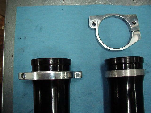

I used a 500 Interceptor fender and made up these clamps to attach. Just turned the leg round in a lathe where the clamps attach. It can't be considered as stiff as a purpose built fork brace, but certainly does work. I laced an 18" front rim and the longer fork legs are from a 78 model so no issues with tire clearance.

Thanks for the pic..
 similar to that but thicker & rigid enough to work as a brace & to take F dust seals..
