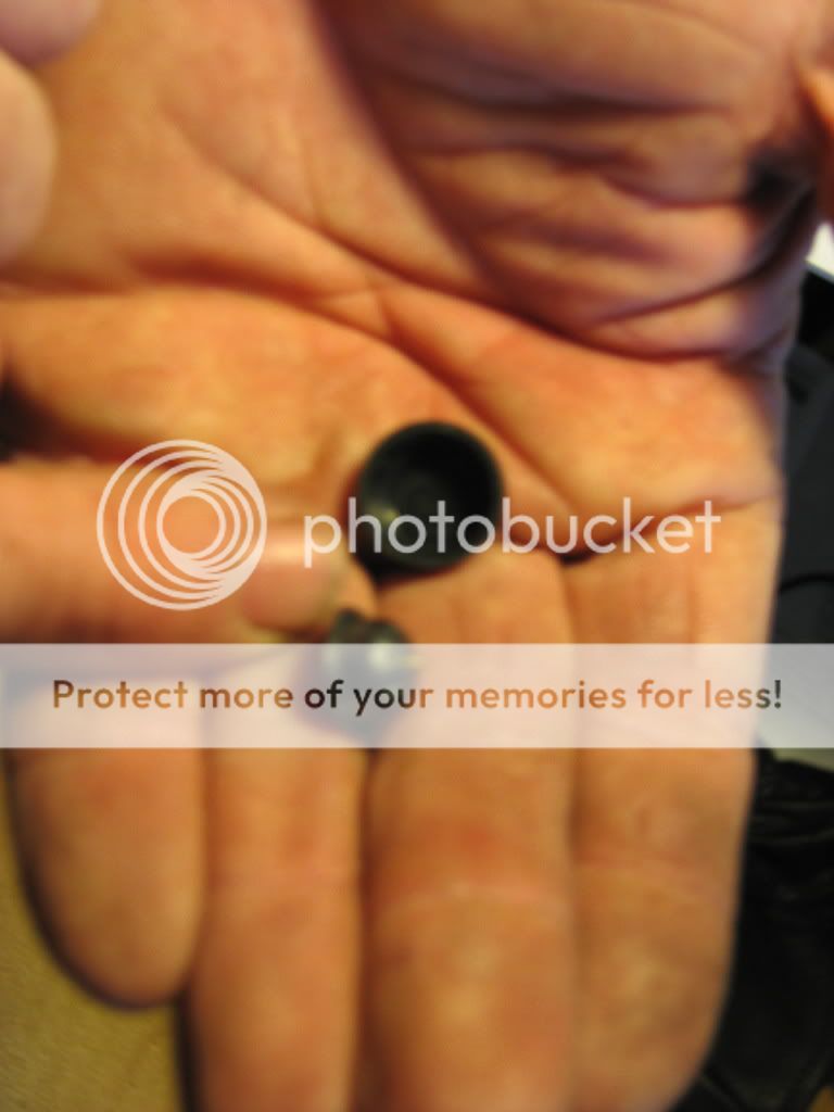

I'm just about to rebuild the master cylinder with this kit i have here.
One of the parts in the kit didn't exist in the MC when i disassembled it. The small metal "cap" seen here on the bottom.
Can anyone describe it location in reassembly or identify it by name/  If i knew its name i could find the location from the parts detail.
Any help is as aleways ... appreciated.

Probably the same beast as my 750 sooooo...
Cup goes in the end of the spring. Part number 14 - VALVE SET,CHECK

« Reply #2 on: March 29, 2009, 01:14:06 PM »
perfect, thanks!
