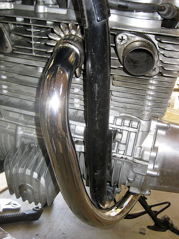

Right pipe aside, I've been having a heck of a time with getting the left set to fit. It's exacerbated by lack of documentation, which leads me to think this must be supposed to be easy, which doubles my frustration... I have the Clymer book and Hondaman's My CB750 Book, but neither seems to address installing the pipes. (Clymer has 750F which is no help anyhow.)

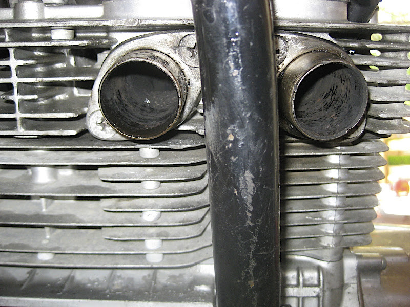

I did get the parts schematics from a parts store, so can kind of see from that how they're supposed to fit. My problem is that when I install the inside pipe, I can't seem to get it to align with the frame for the pillion bolt to seat.
I am re-using the flanges that were on there -- they seem correct, but perhaps they aren't?
I'm not positive how the pipes are supposed to fit with the frame. They seem to have to push up against it at the bottom front:
Anything obvious I'm missing? Are these the right parts? Do I need different flanges? My fear is that there may be something wrong with my frame... Thanks for any and all tips!!

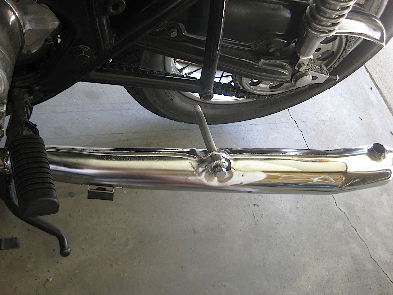

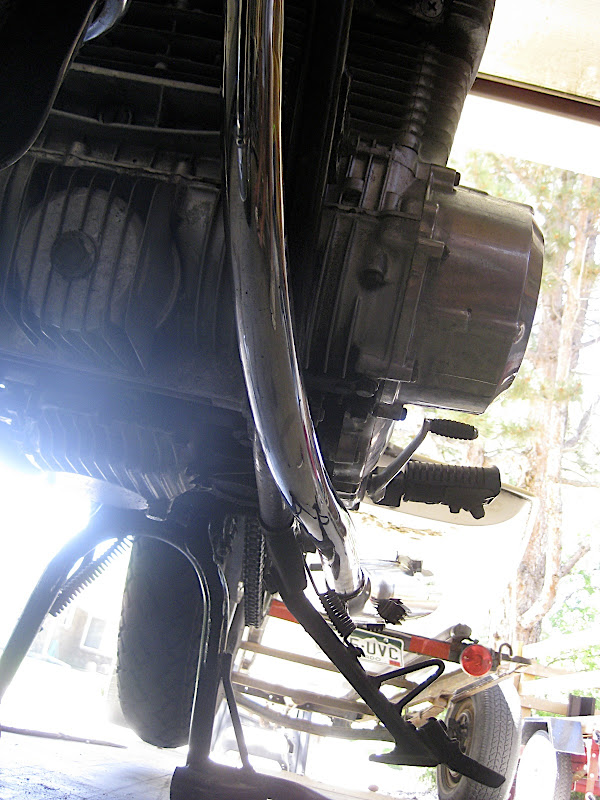

The 75 should have all HM341's. That HM300 is for 69-71 CB750. I am not sure if the sizing of the holes will be the compatible to combine a 300 & 341 on the same side. I can tell from your pics you are trying to position the #2 pipe to far to the outside. It goes on the backside of the frame. I will load up some pics that might help. Click the pic to enlarge it. The flanges look correct for the bike.
« Last Edit: July 05, 2010, 02:58:50 PM by Johnie »

You will need the rubber bumpers that go on the bottom of the exhaust for both side stands to rest against when they are in the up position.
There was a thread that some of the OEM exhaust built in the last year or so were not properly bent to specs. I hope you did not get one of those. Do not tighten everything up until all is seated. You may have to slide a pipe off the flange a bit to get all to line up. And still you may have to push a bit to get that long rear foot peg bolt into position.

Glad to see I'm not the only one to run into this, same thing happened with me the first set I put on. The inside pipes (2 and 3) come of the flange, go down to the INSIDE of the frame then they work their way out so when you run the bolt thru the upper and lower pipes and finally thru the frame they align vertically.

Johnie, thanks so much for the pics and info! pdrides, thanks for the confirmation and commiseration -- nice to know I'm not the only one. Threading that inside pipe behind the side stand was the key.
