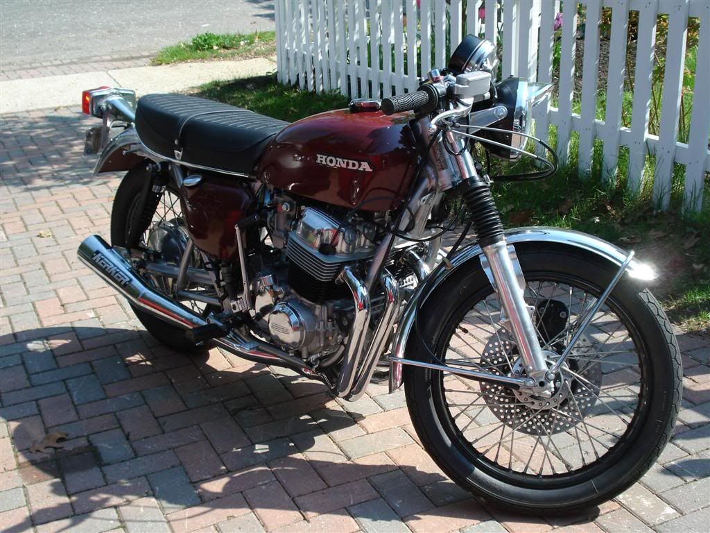

So this is your motor? '76 cb750K Wiseco 836|ape crank/head|Carillos|CR29s|Dyna 2k|Kerker
Pretty nice, bet its quick? Or you haven't had it running yet?

Yes this is the bike, the motor and tranny are perfect so now I just work on other details.  I'm concentrating on brakes, controls, suspension, and electrics but the bike runs and I ride it for pleasure.  The bike is scary fast, made more so by the comparative weakness of the rest of the bike compared to the monster motor.  I've got so much money and time into this bike now that I have no problems spending $$$ on modern brakes and suspension upgrades as I can afford them.

Very nice. You mention tranny, what did you have done there?
Oh nothing major but I did completely rebuild it and go over it to spec.  I replaced some gears and shift forks with better OEM pieces.  I also have a Barnett clutch and springs.
I see. That second gear shift fork can wear over time. Results in second gear jumping out.
I've had mine undercut on the 1-2, 2-3, and 3-4 upshifts and the 3-2 downshift. (budget) by APE. Haven't installed it yet.
I with I did it now but I really was at my max expenditure at that point.  I have almost to qualms about pulling the motor to do it in the future.  I've done it before, just pull the motor turn it upside down and pull off the bottom of the crankcase.  The gears work well for now but once in a while in 3rd or 4th I forget which it will slip out if I haven't put it into gear with enough authority.
Yeah you may be in line for an upgrade, but like you say it can be done easily later.
