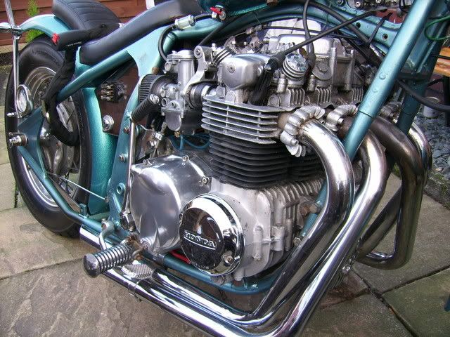

well ,  my 75 550f has K&N pods, a mac 4-1 , and 110 mains.
chopper550
Re: Jetting with individual filters and exhaust...
« Reply #16 on: February 07, 2009, 03:35:08 AM »
550f
straight through drag pipes
125 main jet
pods
boyer electronic ignition
Iridium plugs
needle up one notch
Runs like a dream fires up first time ticks over perfect top end awesome never misses a beat......

I can't tell you how many dyno tests include this definitive data point on their power output charts.  ;D ;D
Interesting bike, though.  But, number two exhaust color says there is/has been some sort of tuning issue.

The pipes are off another chop i had issues with so the colour is nothing to do with this bike...hense getting a new set of drag pipes for the summer lol
ooopppppssss i meant Iridium plugs lol...hahahahhhahaha
