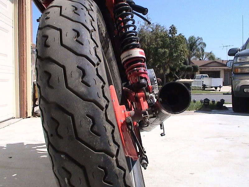

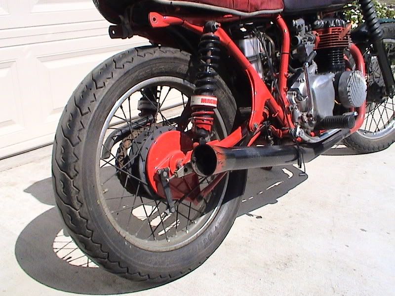

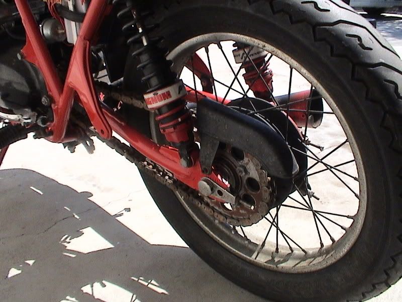

On my '72 CB350F, I have a Dunlap Sport Elite 120/80/18 on the rear which messures 4.75 in. across.  This is a wide tire made for what was considered standard width rims back in the '80's.  The bead and side walls are constructed in such a way that the tire retains it's proper shape and grips the rim tighter.  No interference with the chain, the bike corners nicely and is stable at 100mph, without a steering damper.
 From your pics the 80 series tyre looks well over a 100 series on that rim.
 It also looks like you have at least inch and a quarter unused either side (aka, chicken strips)
 Whats the overall height of tyre when fitted?
 It should be about 24.5 inches or less on correct rim.
I have a 110/80x18 on WM3 rim for CB360 and that measures about twenty four and a quarter inches high which is pretty close to the 24" stock tyre/stock rim.
 Pic is my Katana front with only 10mm oversize tyre, (120 instead of 110) cant get to edge although I have managed to get as far as the direction arrow since pic was taken
 Not best angle as it makes tyre look flat when its really extra tall, second pic gives better idea of what it really looks like, its a long way over to get there
PJ
Dont mean to be rude, but that tire looks like its never seen a corner and lives on straight roads.Im guessing youre idea of handling isnt one to go by ;D
Taymar, to answer your question, if your not worried about optimal handling. ( and i say that with a smirk on my face ;D,we are talking about a 30 year old bike thats handling capability are fairly average). Put the biggest tyre that you can get to fit on there, it will still work and will get the looks your after.Just be a little cautious next time your out scraping your knee around the corner ;D

In response to the "chicken strips", I haven't had the chance over the last 20 years to use the bike to it's full potential.  I didn't ride, nor continue to work on the bike for the 12 years of my first marrage.  One reason she's my ex.
