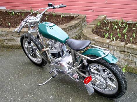

Re: Leper Messiah- '78 CB750k Street Tracker
« Reply #13 on: June 27, 2009, 01:42:45 PM »
The green bike has flat track bars, and forks and tank & more..
 yours has  motocross bars, and what looks like a 60s chopper seat... I am hard to fool.. I was there when every 2nd bike had  a seat covered like that in usually metalflake colors..
 Perhaps you could hunt up some alloy trees, number plates, dirt track bars, alloy rims, fat front tire, that sort of stuff..

    • FallingApartArt
« Reply #14 on: June 27, 2009, 03:06:54 PM »
yeah-I'm digging the track snowflake rims and fatter tires. I'm planning on doing a rear disk swap of a cb750f-maybe there's something aftermarket that's more appropriate/lightweight? My concern about the track tires is highway wear; how does that work out? And can you give me some info on the alloy trees-will the fit the stock forks? Peg-wise, it looks like the dirt track bikes use pretty much stock rubbers-is that really the case?
and you got me on the seat (as the you probably did on the headlight). It definately has chopper influences, but no chopped frame...yet. I might try to add some Trackmaster style frame accents later.
« Reply #15 on: June 27, 2009, 03:18:38 PM »
look for Betor forks off early CanAm, if they have the ears you are lucky, otherwise more work. just the trees might work, holding one of my set,  in my hand, I got last week for 20 bux. ;D
 Cerianis are nicer but way more money.
« Reply #18 on: June 27, 2009, 10:00:36 PM »
Dont pick one of the most expensive HTF wheels..
BMW mags are not the same as those, and you may be thinking of Rokon, they used the ones in the pic.
 most dirt tracker, at least a lot of them, use Ceriani or Betor front ends, and many use knockoff hubs with alum rims and rear disc.. front are usually spool wheels unless used for TT.. But for street you want a disc.. usually a single so you can still see the wheel.
 The reason you see so few 4cyl trackers is the frames are so wide, that none of the real tanks & seat/tailpieces will fit the stock frames..
« Reply #21 on: June 28, 2009, 01:24:40 PM »
Yup, that what mine will (does) have.. ;D
 A reasonable front wheel choice, Yamaha mag used a lot on trackers, Morris looks good too with single disc. Tam & Honda 4 pattern should be same.
 Rear some use Yam mag, or Morris if you can find(some are quite narrow.
 Disc wheels, the 750 f type does not have the lean look of the QC hubs.. Might find a nice rear disc wheel off a dirt bike at a wrecker, or just keep looking.
 Running a tail section like the trackers use will really change the look of your bike, as will dropping front fender & running fatter tire/wider rim..
 If you can incorporate legal lighting into a number plate, it will help out the look..

Easiest I found was to use a dirt bike rear setup.
Rear caliper is easy to mount and the sprocket carrier has loads of different sized sprockets available for gearing.
Plus the minimal look goes well with the rest of the theme. ;)
'48 HD Panhead - Exxon Valdez
'78 CB550K - Fokker CB.3
'78 Honda CB750K - Mavrik
09 XL883L - No Name
« Reply #24 on: June 29, 2009, 10:53:19 AM »
Some Suzuki RM or MX  aluminum tanks are close in looks, but will still need a lot of modding.. cheaper still than building an Alum tank fron scratch.
 Yeah, fender is an on & off thing.. we can get away in the summer here without.., just try to get a quick on or off, the metisse style glass one (wider) would be cool if you can find that style..
