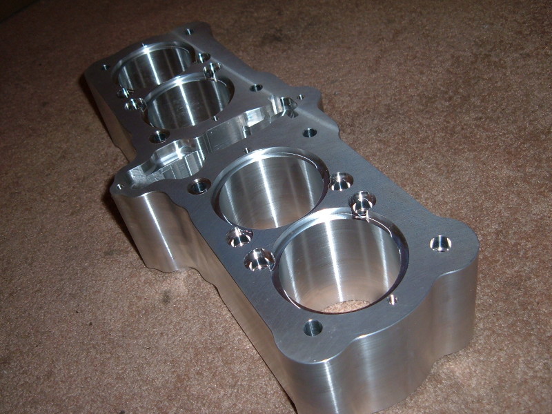

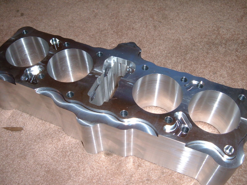

Did you guys see these new blocks on Ken's CycleX site...
Interesting.
Also, how do you think he gets these cases so clean? Just hot tank?
I would give him a buzz and ask, but he's so busy all the time he'd probably tell me to get bent.
-Mike

Very nice mate, I haven't heard from Mike so I might give Ken a call, I've bought a few parts from him over the years and don't have any complaints, and his stuff is fairly priced. Those cases don't look like they've been blasted, so they probably have been "hot tanked". Cheers, Terry. ;D

Hey Terry, are you watching this thread?  http://forums.sohc4.net/index.php?topic=49438.msg694946#msg694946
I think Mike's block may be worth the wait.

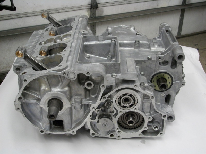

That drive seal is in backwards
Not according to the parts manual Mike, and I just checked my K0 (that hasn't been rebuilt) and the seal is in the same as Kens. That's a newer seal with the metal back exposed, but it's orientation is correct. Cheers, Terry. ;D

After some checking I'm stumped now too....
I thought it was backwards as well.
