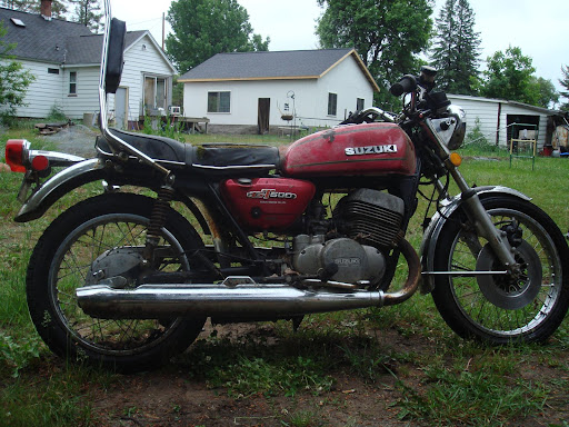

Here she is as of tonight.

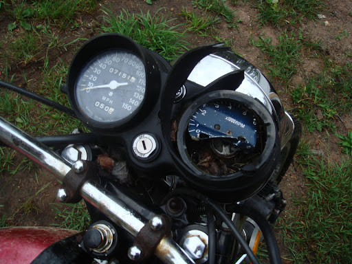

Stainless rotor?
It's growing stuff.
Peeling chrome, typical.

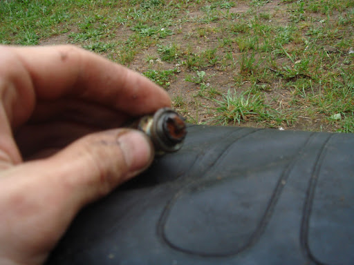

Read this plug! Rusted, electrodes pushed together (how would that one happen do you think?)

jeepers  :o
You have vegetation growing from the seat!  It's like a mobile salad bar  :D
I loved working on and "testing" the two stroke street bikes.  Its a good project you have there  ;D
Fuel air and spark... If you can... check the compression
mix up some 2 cycle fuel and clean the carbs.  get new spark plugs and try to fire that puppy up

make sure to keep it watered or the moss will die.  ;D
step one- wash.

Everything is seized up on this thing, it's been in the woods for something like 15 years. My first step will be un-sticking the engine and pulling it apart I think. Impressively, even the choke is seized. I'll be waking up early tomorrow to clean off the leaves.  :D
There's still oil in the oil tank and it's not rusted in the least! Score one.
So, how should I go about unsticking a 2-stroker? This is the first 2-stroke engine I'm ever going to play with.

PB blast the cylinders... worth a shot
I'm pretty sure those had oil injection... don't trust it until you can service it.  Be careful what oil you pour where  :o
2 stroke engines are a lot... lot lot lot less complex then a 4 stroke... if you can work on these SOHC you can work on a 2 stroke.
