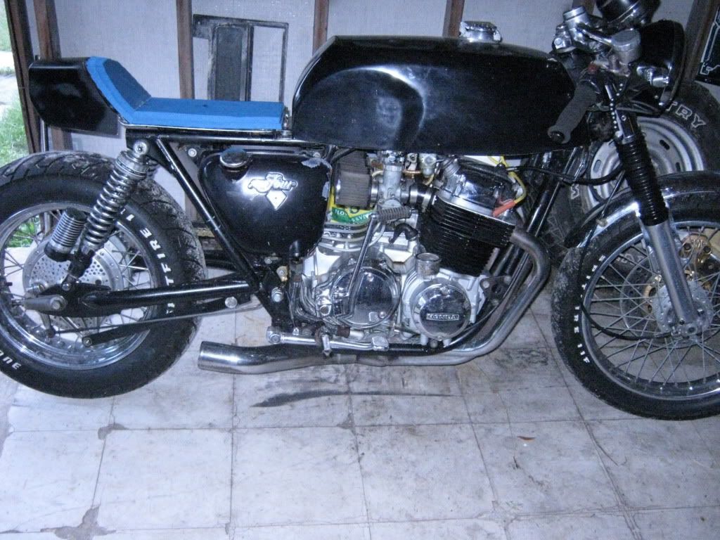

« Reply #30 on: August 19, 2009, 10:25:07 PM »
ok, so.
zzzzz zzzzzzzzzzzzz zzzzz tick-
mock mock mock
it's just sitting on the frame, I'm gonna cut the points up front off the thing and screw the cowl part to the aluminum seat part.
so far I think it goes with the tank alot better than the old one.

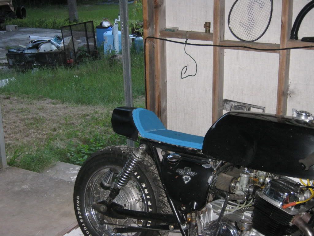

« Reply #34 on: August 20, 2009, 07:40:46 PM »
I cut the seat pan down some more and bent it to the contours of the cowl as much as possible for now.
also, I cut front points off because it wouldn't fit the frame with them on.
I feel like it's sitting to close to the tire (might hit the tag) but the suspension bottoms out just inside the cowl, so I don't think it'll be an issue until I put a bigger wheel in there.
not sure what to do with that little gap
probably just hammer the pan to fit...

« Reply #35 on: August 21, 2009, 03:14:30 PM »
I think I'm gonna have to raise the rear by relocating the shock mount on the swingarm.
when I sit on the bike it drops too low, and looks ...funny?
Chin
Re: I'm making a seat (attempt 1.0) 10 oz.canvas
« Reply #36 on: August 21, 2009, 07:32:41 PM »
You could try and raise the dampening, or trade the shocks for longer ones. Relocating the shock mounts will affect how the bike handles.

« Reply #37 on: August 21, 2009, 08:23:39 PM »
I mocked up a shock relocation -forward 3 inches- looks terrible.
my shocks are off a cb1100 and are already super long and on the stiffest setting.
I think i need to figure something out....
it's a matter of about an inch and a half, maybe the cowl needs to come up an inch or 2  :-\

« Reply #38 on: August 21, 2009, 08:34:29 PM »
ok, so I think i figured it out, I raised the cowl on the seat pan a little over an inch, and when I weld on the seat mounts it'll be about an inch and a half higher.
