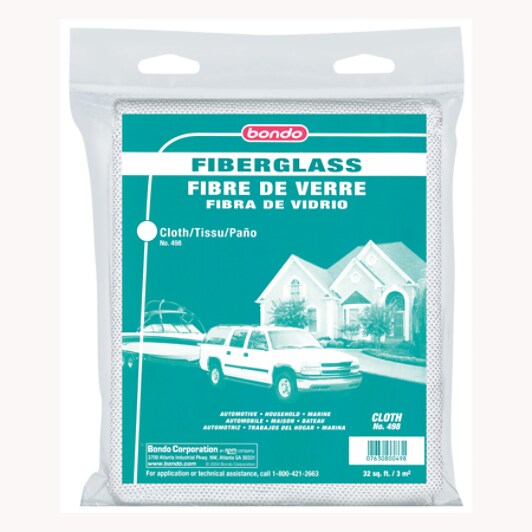

To ‘glass it up, I just use plain ‘ol Bondo cloth like you can find at any Ace/Napa/whatever:
Just need to let it cure for a day or so and we’ll see how she looks:
