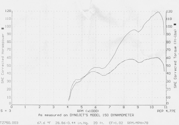

Put my 750K4 on a dyno a few weeks ago and this is what it did.
if you cant see it you can make your browser zoom in .

Maybe you can provide numbers for the "why peak torque can never appear after peak HP" question. I get it, as RPM is always increasing at the moment torque peaks (and therefore more power is made at least for a short part of the curve past peak torque), but like to see it written mathematically. I plugged some random numbers in to find limits, but that's a pretty backwards approach.
I think you have the right idea.  On the dyno graphs, RPM is always plotted on the horizontal x-axis (and torque or hp on the vertical y-axis).  The 'after' in the question "why peak torque can never appear after peak HP" means higher RPM.  Okay.  It's late, and I can tell the more I try to explain it in words, the more confusing it'll sound (perhaps I'll try to explain it in words tomorrow).
But anyway, here's the math...
First a little calculus tutorial:
A derivative is a measure of the rate of change of a quantity.  The derivative of a function f with respect to some quantity x is a measure of the rate that the quantity f changes with respect to the quantity x, and is written as df/dx.  Here is the important part for this discussion; the derivative is either positive (increasing), negative (decreasing), or zero (not changing at all).  (We will use this fact later.)
All right.  We have a function (equation) for the horsepower:
hp = torque*RPM/5252
To make this function looks 'nicer,' let me write it as
h = T*x/c
where h = horsepower,
         x = RPM,
         T = torque, and
         c = 5252.
Now, bear with me...
let's take the derivative of h with respect to x (in other words, we ask, how does hp change with respect to RPM):
dh/dx = (x*dT/dx + T)/c
To get that, I had to use calculus, and something called a "product rule."  (Anyone interested can find these differentiation rules in any first-semester calculus text.)
Okay... remember when I said that a derivative is either positive, negative, or zero...
it turns out that when it is 0, it is at either its maximum or its minimum.  One quick look at myhondas' graphs (or anyone else's) and we see that it would be a maximum (i.e., where it rises, just levels off, and starts to turn down).  We could justify that it's the maximum (as opposed to the minimum) with a little more math, but we might as well use common sense to spare us the work.  So when the derivative is zero, it's at its max (another important fact we'll use later).
All right.  Either I'm getting rusty, or the above equation, when equated to zero, becomes a complicated differential equation that seems hard to solve.  My hunch is that I'm rusty.  But it turns out with a little cleverness we can avoid that.  Let's look at the equation again:
What happens when the torque (T) is at its max.  Remember, when it's at its max, its derivative is zero (dT/dx=0).  So let's plug that in the equation above and see what we get:
dh/dx = (x*0 + T)/c = (0 + T)/c = T/c, or simply
dh/dx =  T/c.
This tells us what the horsepower (h) is doing with respect to the RPM (x) when the torque (T) is at its max (and remember 'c' is just 5252).
Ahah!
Remember what I said about derivatives?
Is dh/dx positive (increasing), negative (decreasing), or zero (not changing)?
The torque (T) is at its max (hence, a positive number), and c is just 5252 (also a positive number), and thus T/c is positive, which means dh/dx is positive (and remember, dh/dx is the rate of change of horsepower with respect to RPM).
So when the torque is max, the horsepower is increasing (its derivative is positive), which means that it must peak after the torque peaks.
Whew!   :)
I was thinking about this some more.  Another way to see it is this:
Going back to this equation
Remember, this equation describes how horsepower (h) changes with respect to RPM (x).  It is the derivative of hp with respect to RPM.  Also recall that it gives the maximum when this equation is equal to zero (i.e., hp is at a maximum when this equation equals zero): dh/dx = (x*dT/dx + T)/c = 0.
This can only equal zero if
x*dT/dx + T = 0.
So hp is at a maximum when x*dT/dx = -T.
Notice the negative in front of the T.  x is the RPM, and is always positive, so for x*dT/dx to be negative, dT/dx must be negative.  But dT/dx is the rate of change of torque with respect to RPM.  This can only be negative if the torque has already peaked and is coming back down.
So that is another way to see that hp peaks after the torque has peaked.
But...
The above results are clearly true if torque and hp increase somewhat smoothly to only one peak for each (see first graph below).  In mathematical terms, it is said that the functions increase to the peak monotonically.
If, on the other hand, the torque and hp increase, then come down a bit, increase some more, then back down, then increase again (see second graph below), then it is not as clear that the above results are true (i.e., that hp peaks after torque).  Sure, hp always has a peak after the corresponding torque peak, but it is not clear that the absolute maximum of hp is peaked after the absolute maximum of torque (see this link again about 'global' and 'local' maxima).
My hunch is that it is absolutely true that hp peaks after torque (and is definitely true if the graphs only have one peak), but it will take a little more work to show the general case mathematically.
Below is a dyno run with only one peak (the choppy stuff at the high RPM is instrumental noise, not a bunch of peaks).  The light gray line is torque, the black line is hp.
Here is one where there are several local maxima.  Light gray is hp, black is torque (reverse of the color scheme of the other plot).  It looks like hp peaks just after torque for each local maxima.  The first peak and last peak look pretty close though.
[Edit:] Notice on both graphs the hp and torque cross at 5252 RPM.  This will always happen when torque is in ft*lb and power in hp.
