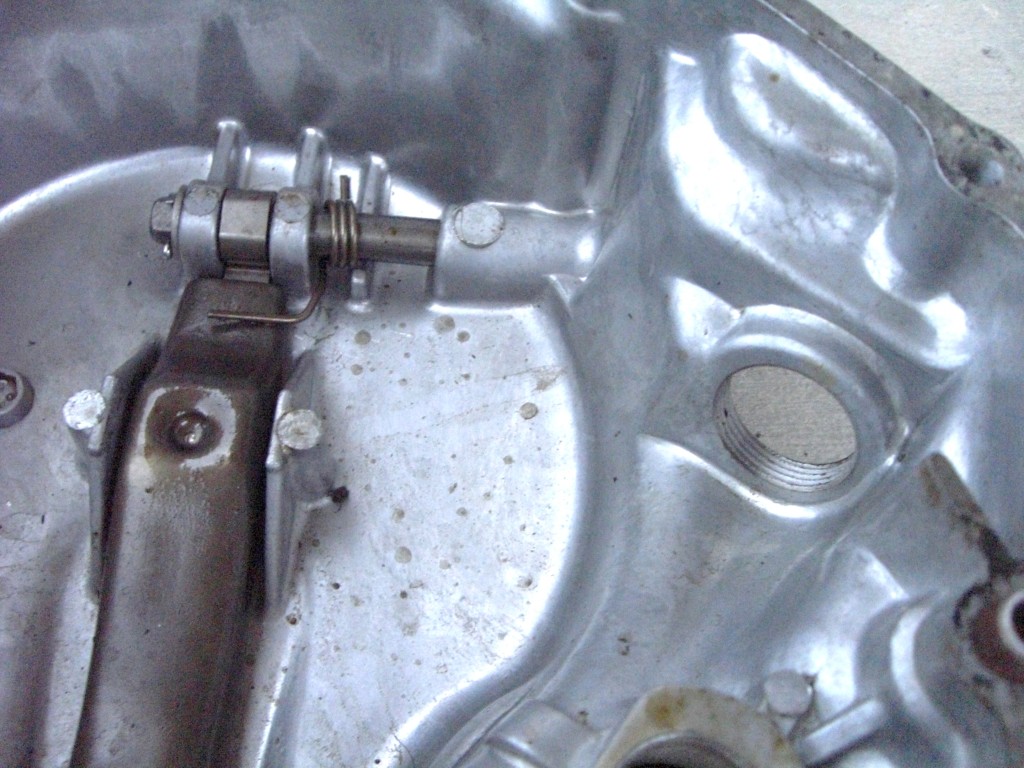

Just saw this image and immediately noticed something
The actuator arm should have constant tension due to that coil spring.  Mine doesnt, so I'll check that first
it won't if that cam has flipped up past the lever...

« Reply #35 on: October 02, 2009, 12:59:44 PM »
Yeah thats what Im saying.  Looking at that pic I can tell something is definitely wrong internally.  At least I know Im not 100% stupid/crazy :)

« Reply #36 on: October 02, 2009, 01:12:30 PM »
If that lobe is on top of the arm, I am going to feel really good.  First time I have helped someone else!
