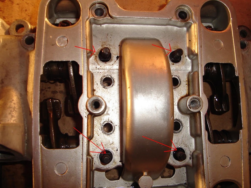

I'm in the garage right now with the head cover off.  I'm in the process of checking my rocker arms to see if everything is ok for my project build.  Clymer states to take the threaded cotter pin washer and nut off.  Check.  It then states to gently tap out the threaded cotter pin.  This is not happening.  First off, which way do I tap.  And secondly, how much force is needed, because the adjectives gently and slightly forcefully are not working.  Any help would be appreciated since i'm trying to get these fools out right now...
Pic attached

The cotter pins are (as the name suggests) keyed to the rocker shafts.
They attain a very high grab in their mounting hole. They are removed by tapping/knocking the threaded end back down thru the hole.
Perhaps use a nut on the thread end to protect the thread etc.
Is there a real need to remove them?
Does the rocker action/condition exibit unacceptable wear?

don't forget to remove the rocker end bolts first, then as stated put a nut on those cotters to protect the thread and tap away
yup, i removed the rocker end bolts.  I'll put a nut on tomorrow and try again.  I don't want to break anything I don't have to.  This is my first stab at taking a motor apart and rebuilding.   ::)
