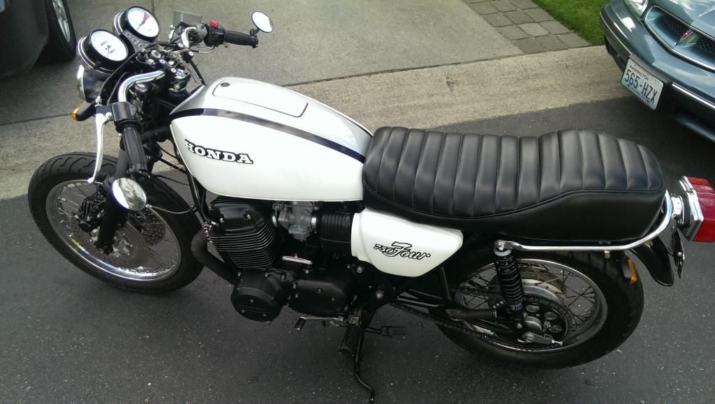

Finally took time off from riding with all the recent rain we had lately to install some different bars.

Looks good Chris.   Consider modifying that exhaust mount, instead of going up to the shock, have it mount to the rear peg instead.  Never did like that mount that Kerker supplied.

That is next on the list. I was trying to remove the baffle one day and noticed it was pretty stuck. I heard that after removing the muffler, I could take a bat and knock out the baffle in reverse. Long story to a short statement. The muffler doesn't want to come off and looks like I could do without the supporting strap all together; I don't think it will fall off.

It may not fall off but still good to have support to keep it from bouncing when hitting a bump.

I would think the muffler would work itself off.
And if you don't support the muffler, the whole leverage of the exhaust will be working flanges and studs in the head up and down and that is not a good thing.

Great point.
