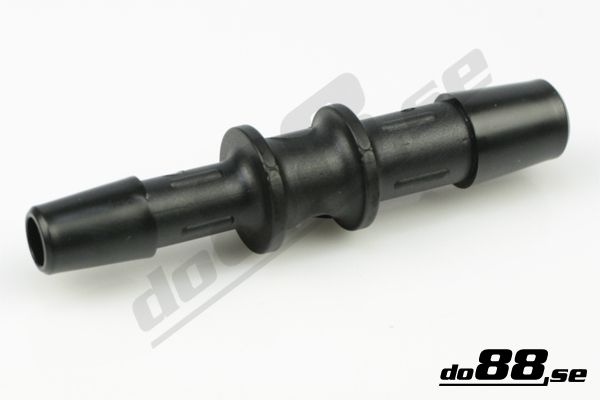

One issues is the 2 fuel pipes on carbs for 8mm hoses, pipes on tank for 6.3mm hoose. I'm currently waiting for reducers 6.3mm-8mm. I'll use the thinner hoses from tank and use the reducers/adapters before hitting the engine case. http://www.do88.se/bilder/artiklar/zoom/NR6-8_1.jpg
Fuel filters with entry hose diam 6.3mm from tank and secondary side 8 mm to carbs would be a good alternative.
