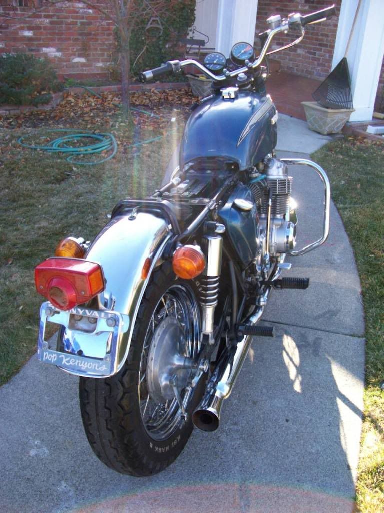

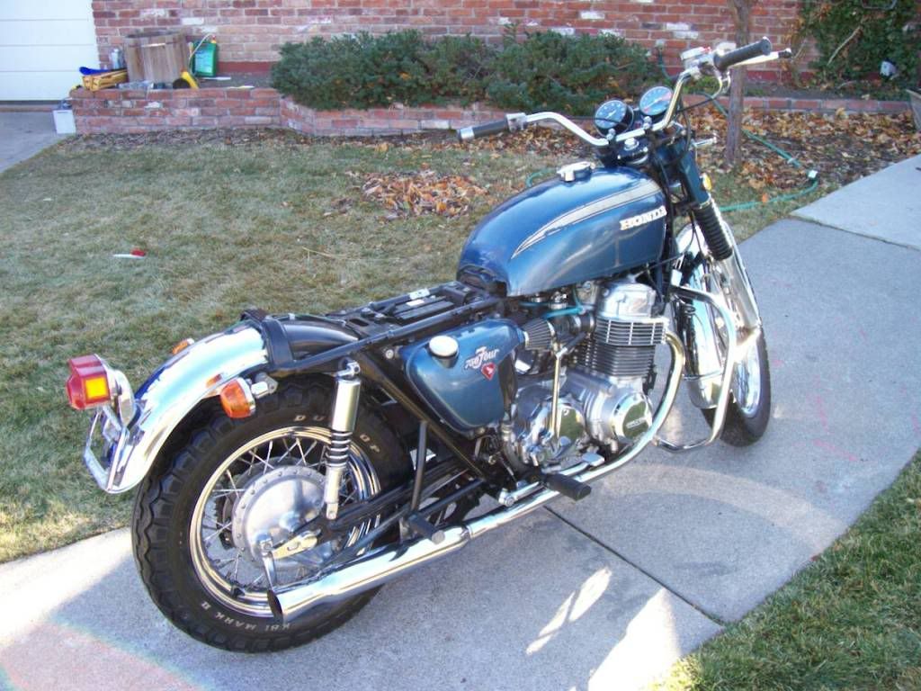

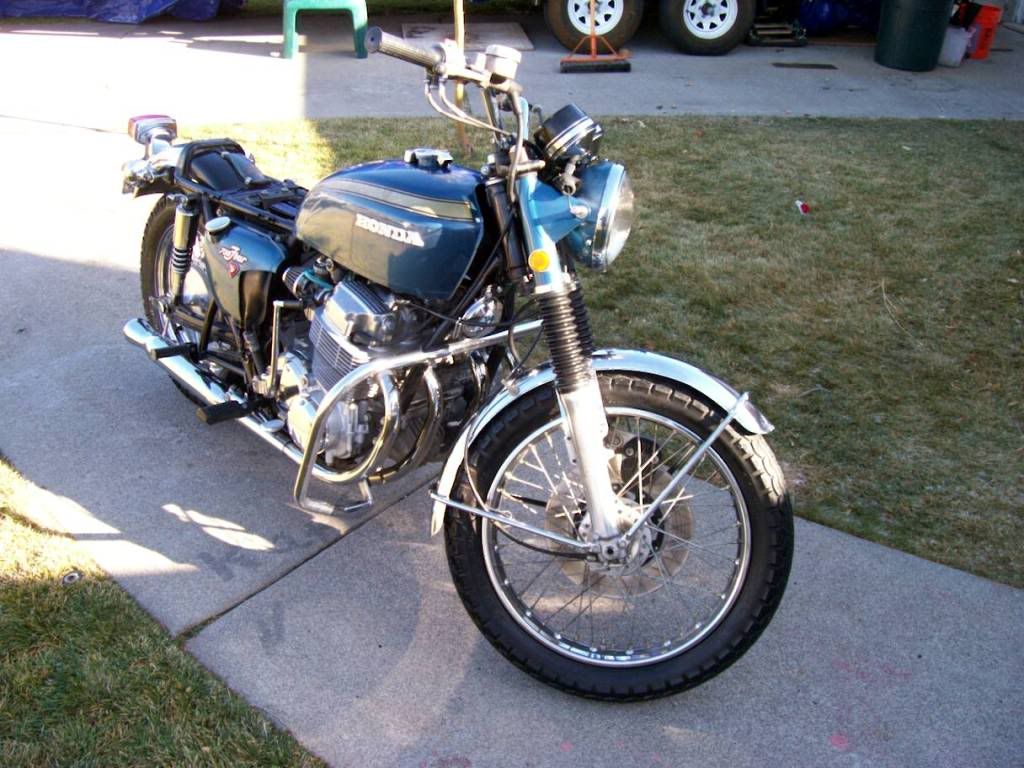

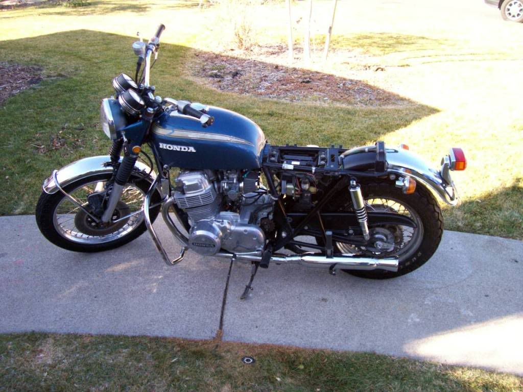

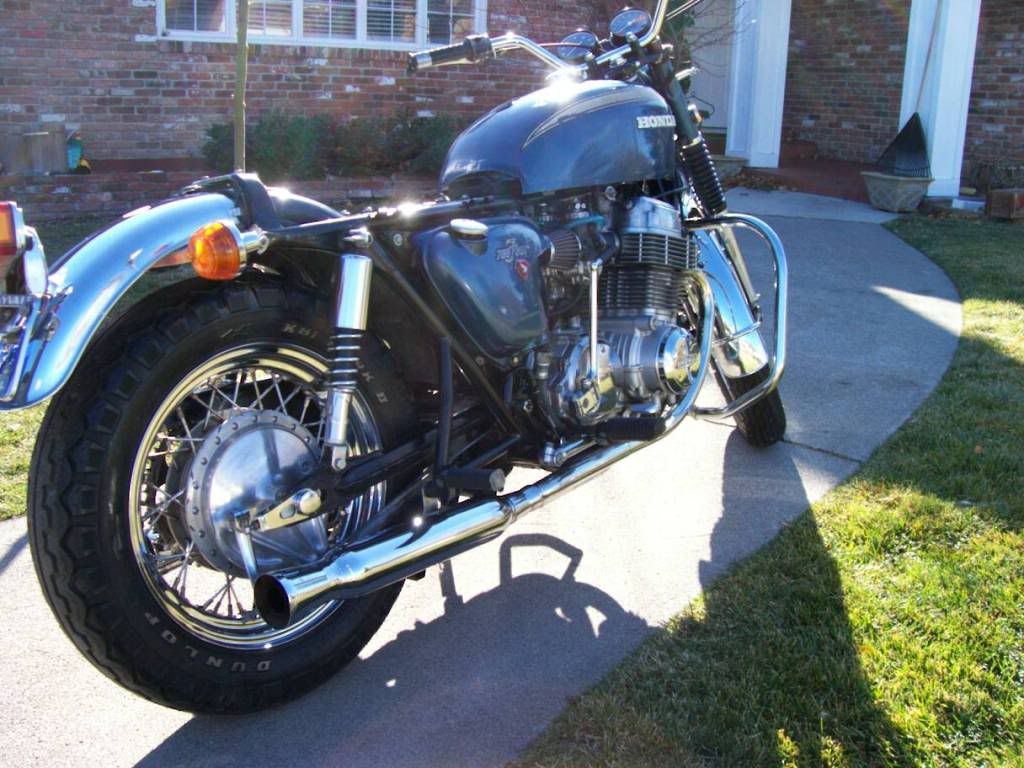

Hi all, I own a 71 750 K1. Was not sure where to post this, as its a project I guess, but I am perplexed by a couple of things too. Anyhow, here it is... bought from original owner, original title, sales receipt and warranty paperwork, 8K miles.
Here are some pics and a video.
Oh, anyone ever see a little red light between the speedo and tach? any ideas? You can see it in the video, at is about 1/2" diameter domed red cover, with japanese writing on a sticker above it.

I'll bet that red light comes on at 55mph. Japanese speed limit I think. Sounds like a Japanese bike imported to the states.
Don't get into rejetting just yet. It worked before probably. Make sure you have a good air cleaner so air will pass through properly and maybe it won't be rich. If you haven't ridden it do so before jacking around with the carbs.

that bike looks fantastic.  i want one!

Sweet bike. Enjoy. Are the other stickers in Japanese also? I bet Rxman is right. I saw one ( japanese domestic bike) at the Davenport swap meet this year. It was newer but looked like that.

the sprocket spinning in neutral is normal, you can grab it with your hand and let off the clutch and it wont spin but you'll feel some pressure against it.  I think all bikes are like that.
sounds like you still have a miss, possibly the idle jets clogged or the air screws arent adjusted the same on all 4.

looks nice man.

That's a nice looking bike.

Very nice mate, I'm guessing it had one of those goofy touring seats that were so popular in the US "back in the day"? Jerry is spot on about the light, I had a K3 that had the same japanese speed warning light, although it's strange that youve got one on a bike that the PO bought new in the US?
Like Jerry said, leave your jetting alone, but give those carbs a good cleaning, like IC says, it's still missing and farting, so pull them off and strip all the jets and mixture screws, fuel valves etc out, and use a spray can of carb cleaner and some compressed air to clean them, and particularly flush out the idle circuits in each carb. Don't forget, new oil, filters, spark plugs and give the points a clean, valve adjustment, cam chain adjustment and carb synch, and it'll go as good as it looks! Excellent pic up mate, how'd you find it? Cheers, Terry. ;D

it also has the yellow side reflectors on the tail light lens. a while ago I was watching a k-0 on ebay that the guy said was sold through the px in guam to someone in the military that is equipped the same as yours. it is a domestic model bike with a different speedo face. are the forward footpegs spring loaded or solid? is the po a vietnam era vet?

the front footpegs are spring loaded, you can see them on the video.

Affirmative IC, spring loaded. Yep, I need to do all of the above for tuning. Ill sort it.
Well, interesting... Im holding on my hand an actual sales reciept from Pop Kenyon's Cycle in Sunnyvale CA.

The red light for the Japanese market was originally in the chrome steering stem nut---I got a new one in a bag!! so unless its been moved its something the PO put on there

There should be a device between the speedo cable and the speedo with some wires going inside the headlight and connected there,there is also a part attached to the frame top tube that looks like a blinker unit that goes with this.If you decide you do not want these parts ever I would love to have them to get mine working again.

That is a rare color too I am thinking.
 I found a headlite ear in poor shape at a salvage yard, same color, and small reflector, .. I was thinking a scarce export  color.

Yeah, I love that darker blue green. It is rare from what I'm told and it was not listed as an available color in this brochure:
http://www.spookytoms.com/Brochures-1971CB750.html
But I have found reference to the one year only 750 in 1971 showing up in Polynesian Blue... I have a guy whos selling cans off of the UK eBay site, I may try and source some from him.

If you unscrew the big chrome nut on the top of the steering stew the wire from the red light went down the hollow tube and came out the bottom and the nut with bulb just screwed on insteas, i dont have any of the other bits either and they dont show in the japanese 500 parts book i have!!
