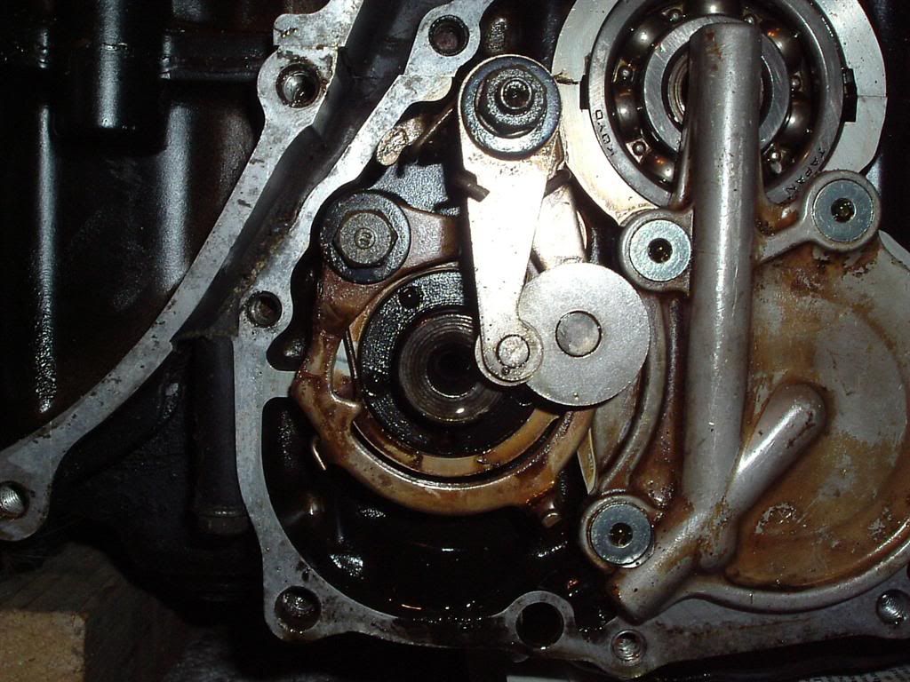

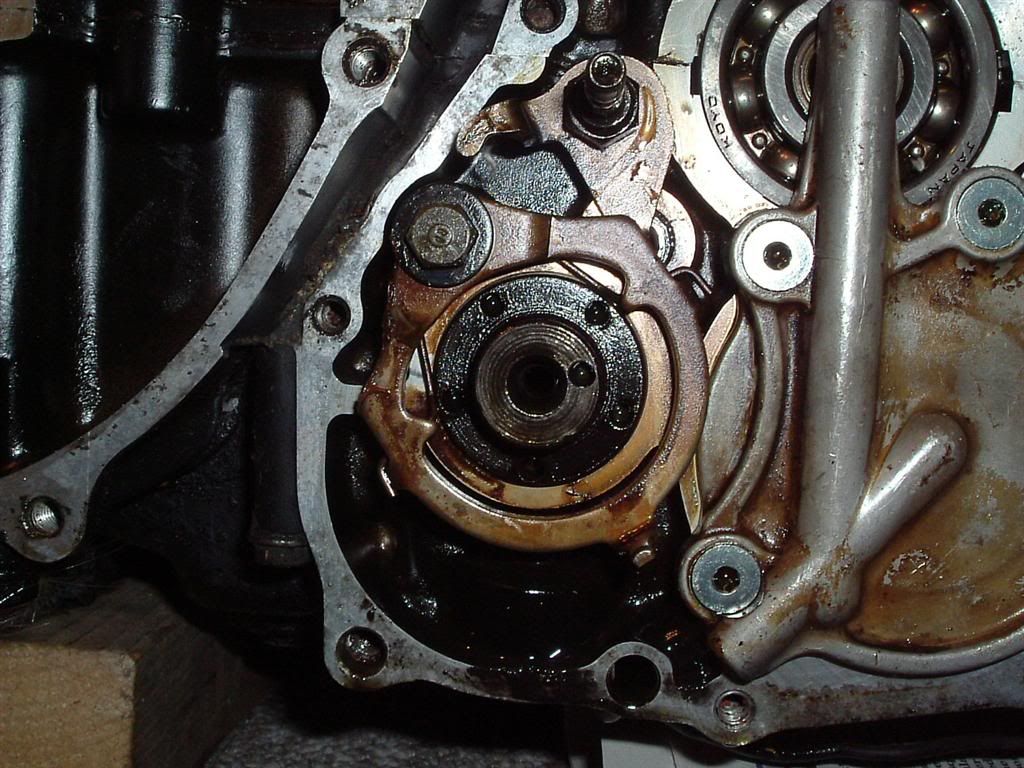

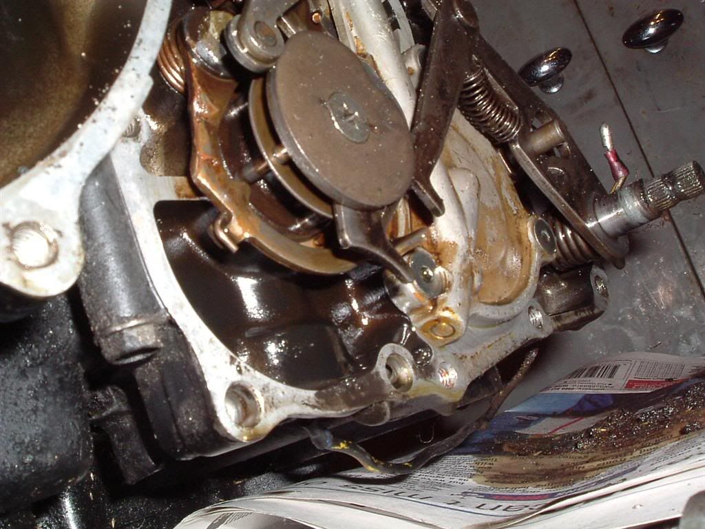

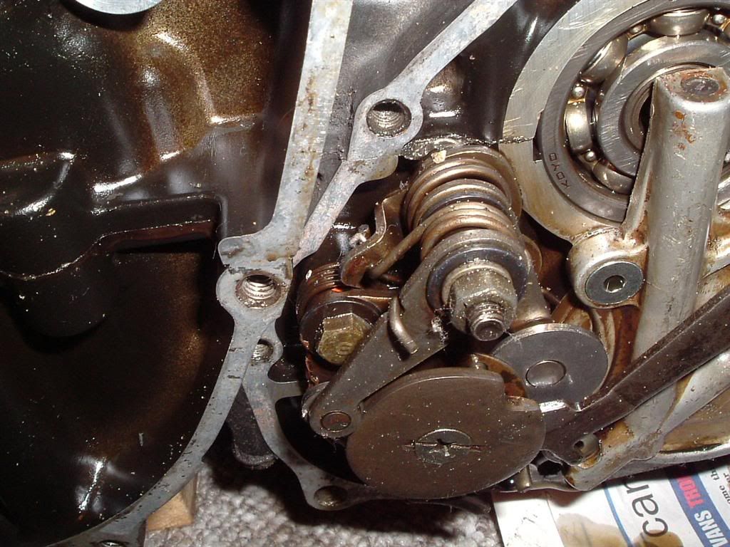

+1 go slowly. Can't remember it being too much of a problem when I did mine, but probably worth waiting until you're finished before cracking open a beer! Here follows (I hope!) some pics of my stripdown which you may find helpful. Good luck!

I just had linkage apart yesterday to get the rear most spring back in place, as it was causing some shifting problems for me.  I did all mine by hand slowly.  The springs are not that hard to overcome with fingers.  Plus just keep refering to pictures in this thread, that's what I did (also how i realized I had a spring out of place) these pictures are great.
Also I left the pins and cover on the drum when I did this, first I got the inner spring and arm on first, it was a little tricky but once in place it sorta stayed by it self.  Then I put the outside arm and spring on (alot easier then the inner one) then i put the nut back on, as i tightened it up i kept moving the inner arm until it fell in to place.  Now it hits and stays in every gear (something it has not done before) :).
I hope some of this will help, good luck
