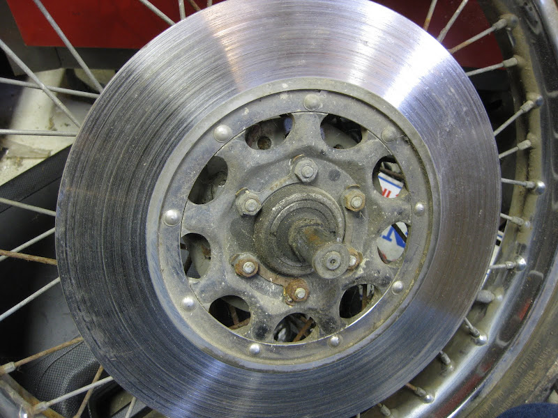

I just measured a K7, K0 and K6.  They all seemed to be between 7.5 and 7.7mm
K6
K7
I have a 75F that's much thinner. Maybe it was just the Fs.
Any other difs between the early and the late Ks? K0 v K6/7?
Maybe as 754 says it was a cosmetic change on the carriers?

« Reply #5 on: January 08, 2010, 09:34:35 AM »
Here's a few pics:
K0:
K8:
K6
K7
