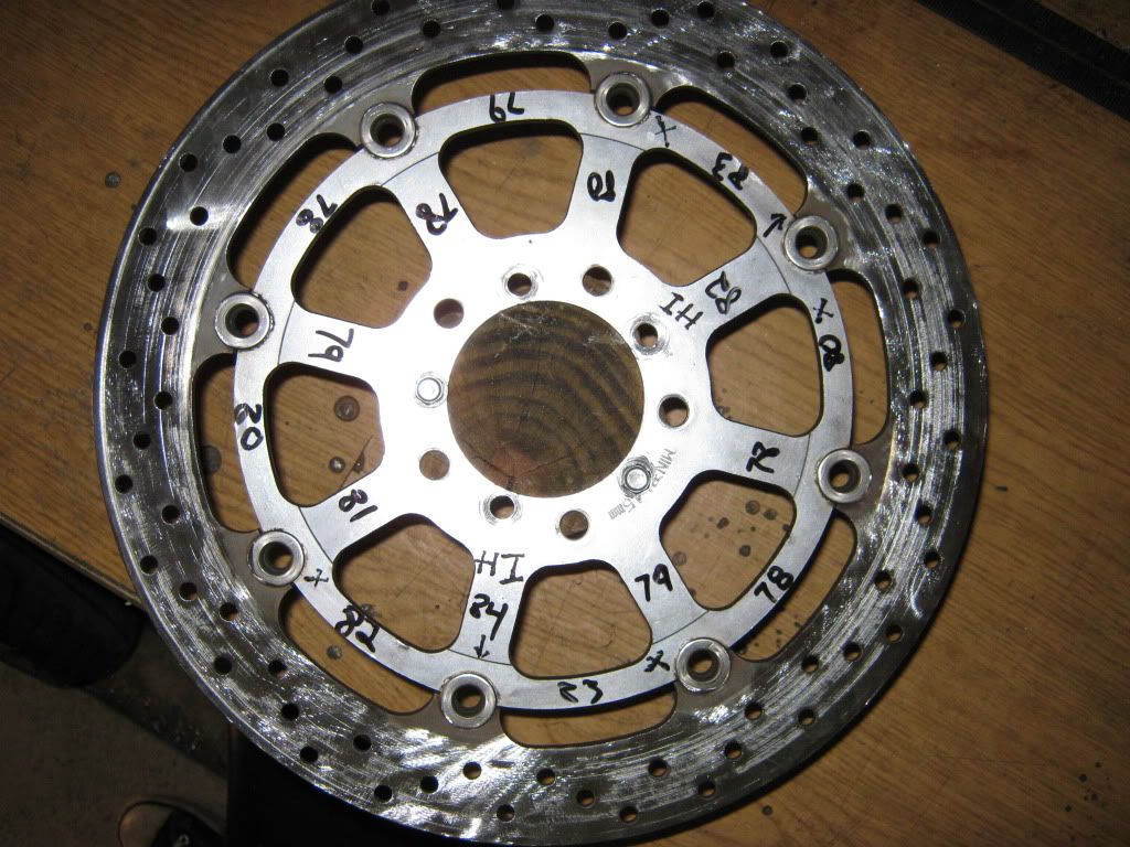

« Reply #267 on: April 10, 2010, 03:37:08 PM »
OK, here's what you do when you don't have a dime to spare.
First I measured the thickness of the rotors at 1 inch increments.
      I started to grind them down with a die grinder and a 36grit roloc disc
Then my bit broke. I rode it around and after I broke my bit and it's better, but not fixed.
here's what's on the bench-
  Just so you know, the rotors are different.  One is thinner with 10 bars.
                                                            The other is thicker with 8 bars.
 probably one hayabusa and one gsxr600. (who cares they're the same size)
I'll end up getting replacements some day, but I want to try this experiment.
                the rotors have been re-measured and marked
rotor A- (0.160) has a very thin spot, at least .010'' thinner than the rest of the rotor. ???
rotor B- (.179) has 2 minor thick spots that I still need to work out.
so that's what I did today.
     if you feel compelled to tell me "brakes and safety bla blee, replace bla bloo" read this first.
Quote from: automated reply
Oh, really? Did the guy at the dealer$$hip tell you that? ::) ;) ;D
« Last Edit: April 10, 2010, 06:43:45 PM by Industrial Cafe »

I forgot to post finished pics, it's pretty stable.
     - but like you said, my fender is pretty light... so, we'll see.
I used stainless bolts, countersunk screws, and lock nuts.
