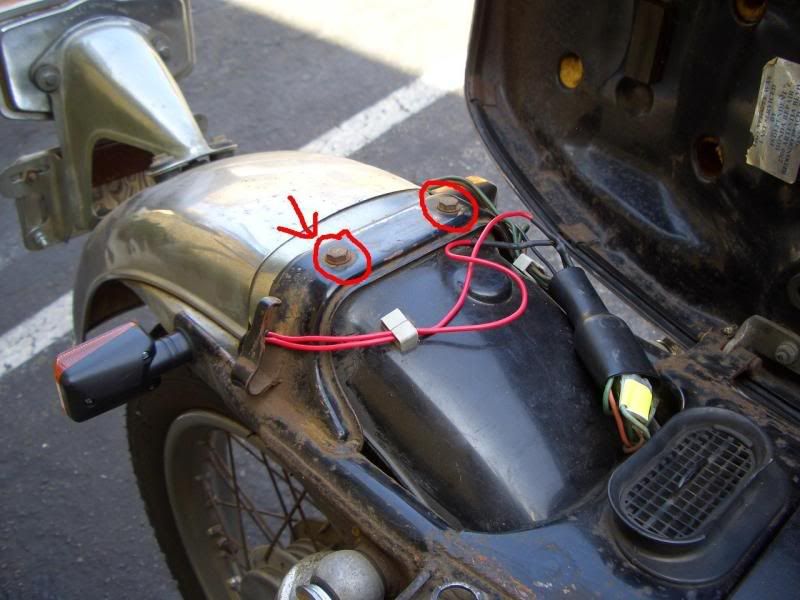

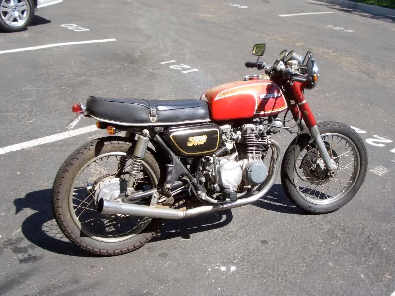

here is where and how i did mine....
i need to remake it in 1/8 steel so it will stop vibrating so much...
as for clearance it might be worth taking the springs off and letting the rear wheel cycle all the way thru the travel to be sure it wont hit....
the license plate will give and rip before anything else...calis are made out of tinfoil
where i bolted it down
shows the bend a little better
« Last Edit: January 13, 2010, 12:20:13 PM by socalenduro »

yeah i know... i wish i has a way to weld a support piece.... on the plus side i shortened the seat by about 2.5 inches, so thta gets rid of alot of material off the bracket
