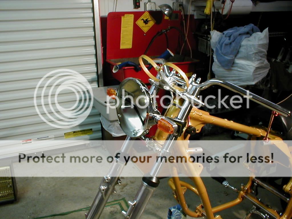

I've got them posted to my build thread, but here's a few.
Here's the concept
And here's the mock up with the headlight.

here is a pic:

Nice looking so far Nokrome, like the frame color.
I also would like to go sans signals, but mine is for street use, and I need them at night to be legal.  I've bot these minibullets which really hug up close.
Back to the OP, if you scroll way down you'll see what's called "P" clamps. These could be used to mount signals lower on the fork tube, as low as the lower tree, or even below the lower tree, so they wouldn't detract from the headlight area so much.
