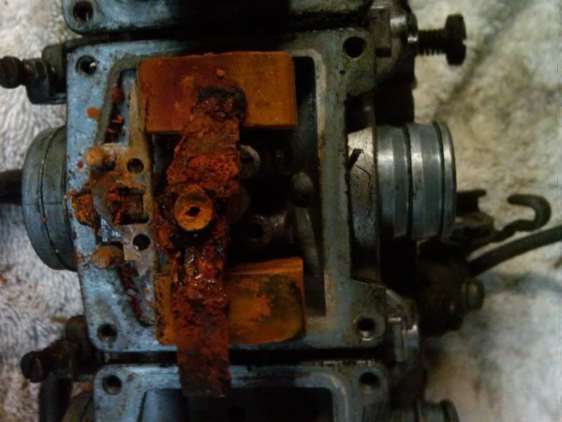

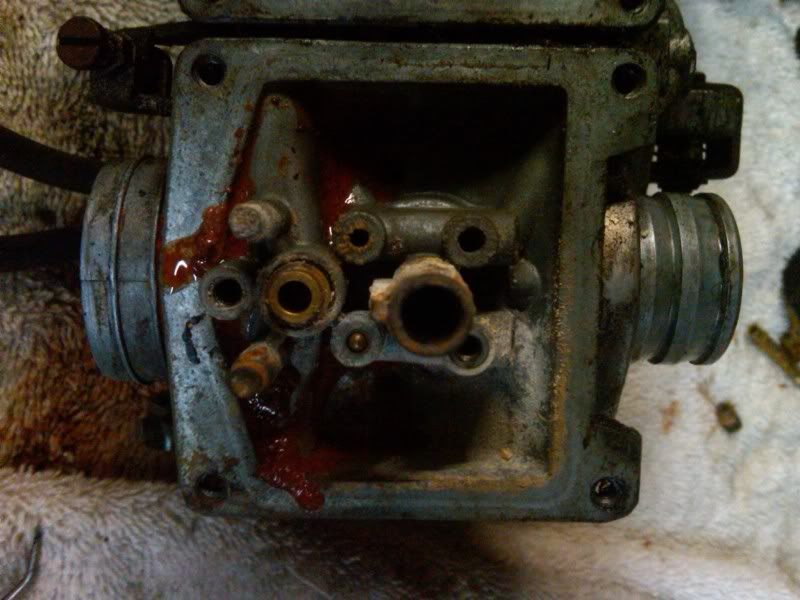

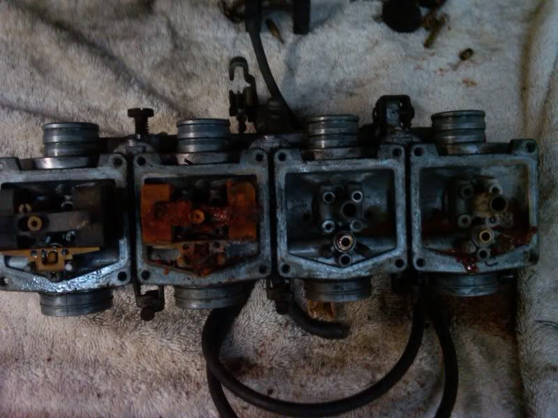

Offline vames
  • Posts: 806
It’s a runner! Definitely needs a carb synch, which I haven’t done yet – the idle speed is some times a bit sticky near 2000 rpm even though it eventually settles down to a nice 1100 rpm. I don’t think it’s an air leak, but that’s something I’ll have to check too. I ran around the streets of Williamsburg and it runs and rides pretty nicely. Time to clean this thing up, put on some new tires and start zooming around town.
Here is a video from a few minutes after I started it up. I didn’t have the camera out to document the leaves and nut shells and manky smoke that initially came out of the pipes, but soon it settled down and idled. The sound on my Blackberry's video recorder sounds a lot messier than it really did -- the bike sounded very clean running for something that sat outside in the elements for more than five years. It has a throaty growl like a vicious german shepherd. Notice the bird#$%* that is still on the seat….
[youtube=425,350]FJCXxQBIFSA[/youtube]
Here is the rack of carbs just after I started to break them down. I found it weird that two were relatively clean while one had some rusty grime inside and one was packed with rusty crap and the main jet holder rusted away to dust. Shouldn’t all the carbs be equal grimy? Everything went into the giant ultrasonic cleaner at the shop and came out clean an hour later. I didn’t replace much – just rubber rings on the main jets – and all the other parts cleaned up fine. Sorry – didn’t think to take an “after” picture of the clean carbs.

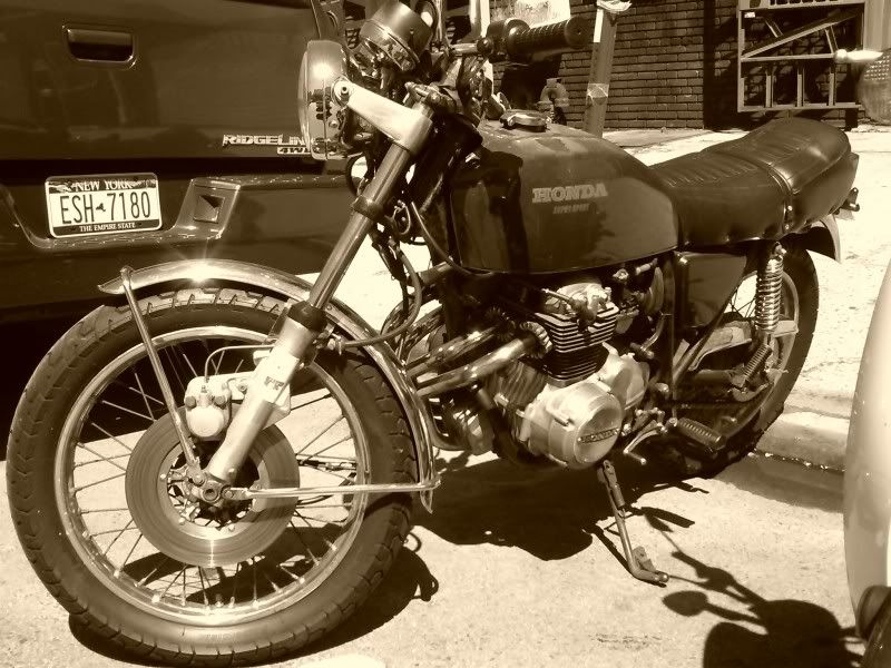

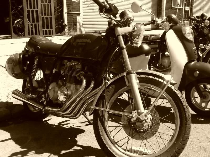

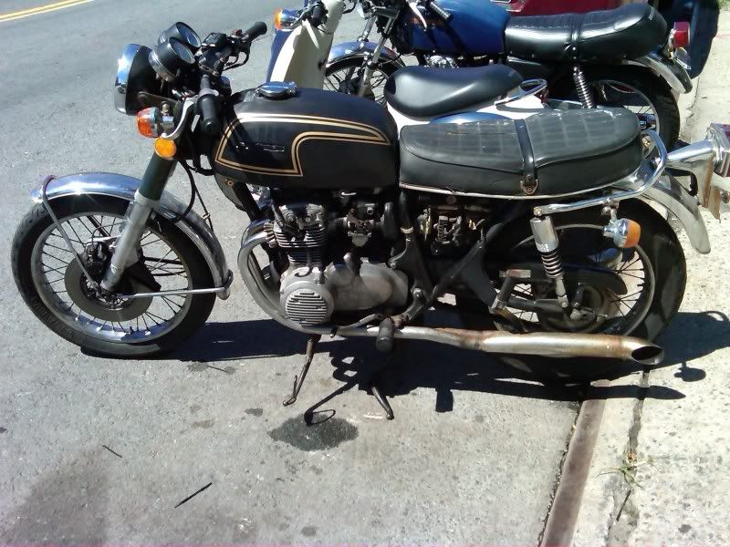

Here’s a couple of shots of the whole bike:
And just so it doesn’t feel left out, here’s a shot of my trusty and beloved 400F, done in my Blackberry’s sepia tone setting for maximum artistic effect. (I think the 400f may be jealous that the crusty 350f has working blinkers.)
