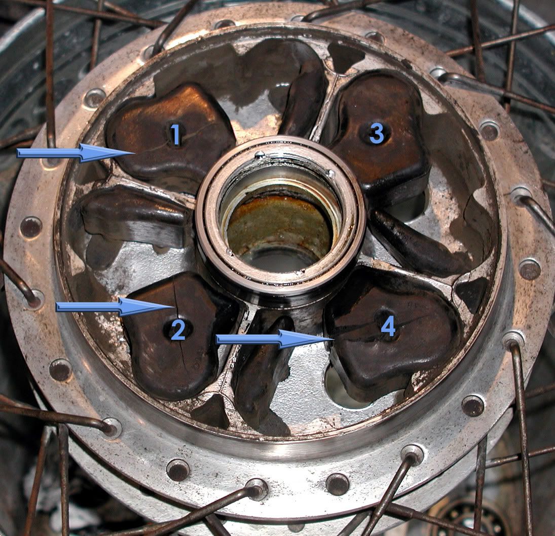

This is my first motorcycle and I'm not familiar with this cush drive.  Three of my rubbers have cracks, I assume I need to replace them?  Will I just need to replace the three that are cracked or is it recommended that I replace all eight (large and small)?  Does anyone recommend replacement or better than replacement rubbers?
Thanks, I attached a photo...

Those are totally shot and you should not even consider using any of them. You can order new ones from Honda. They really help with take off since the clutchs are a bit grabby. Their use is to protect the chain.

Ok, I'll get these ones out and order OEM ones tomorrow, thanks for the advise.
