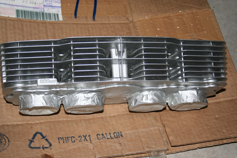

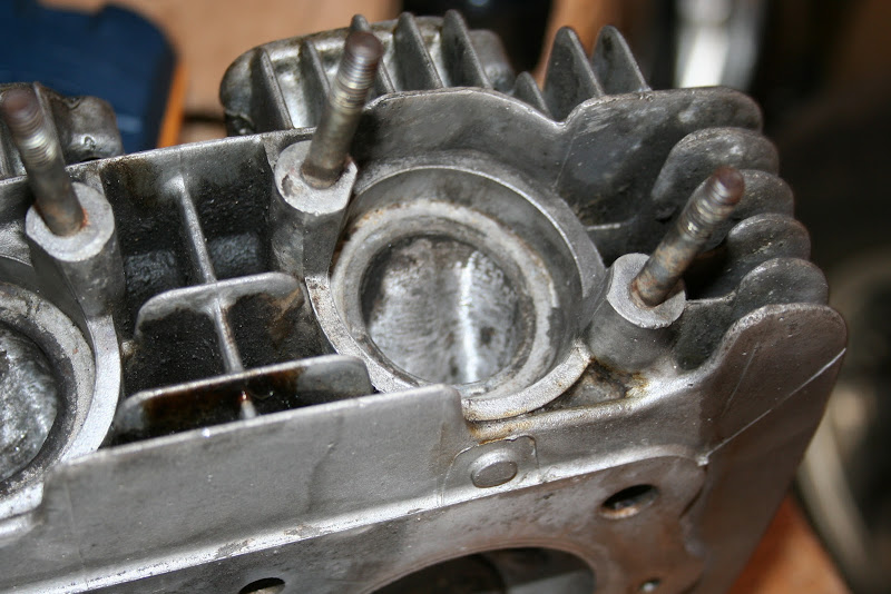

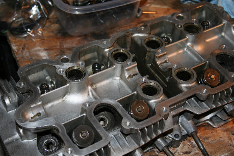

Time to tear into the cylinder head.

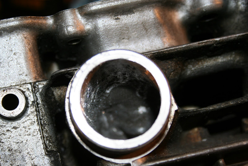

Brandon took care of cleaning up the head. He just used my cheap rotatory tool with a combination of the carbide bits and grinding stones to smooth out the carbon build up.
Looks much cleaner than when we started.

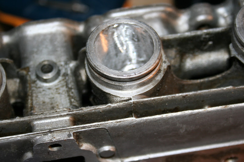

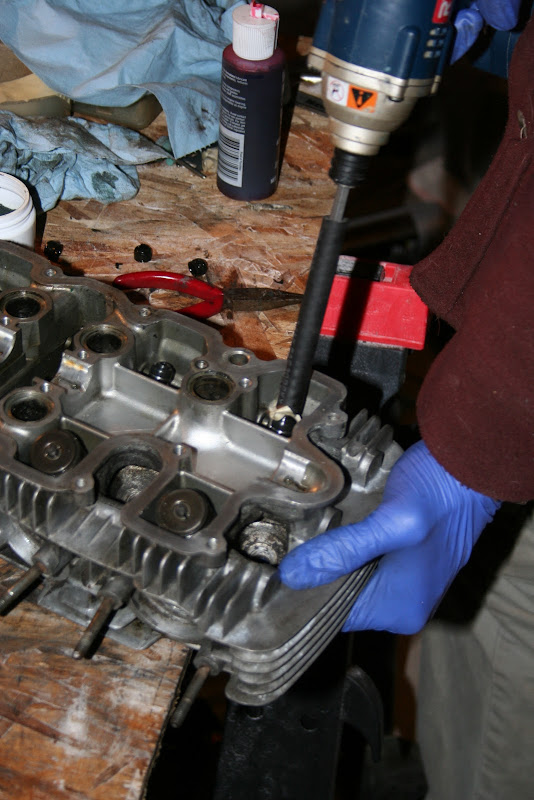

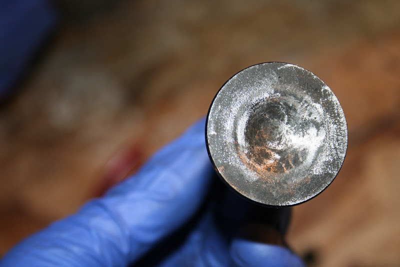

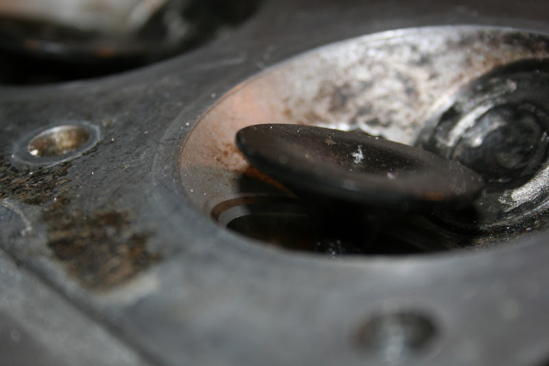

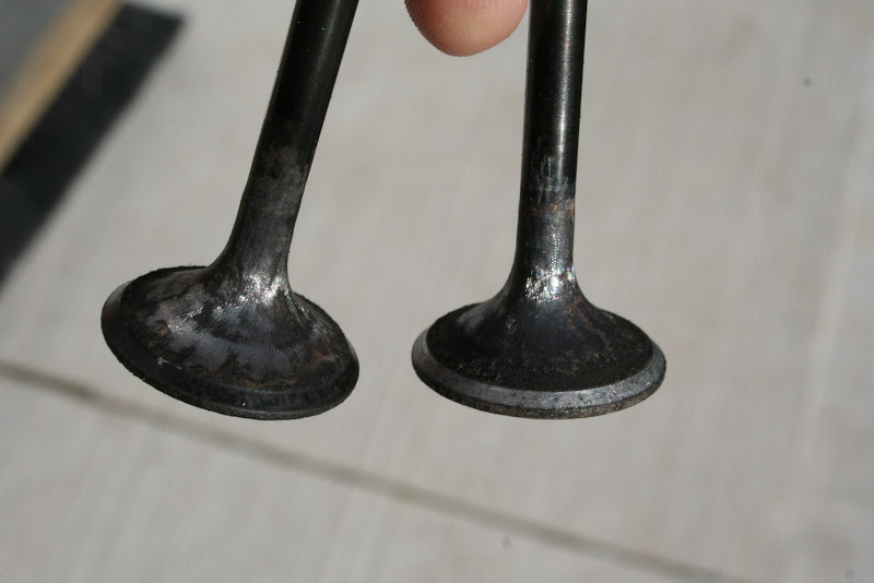

I got the carbon off the valves and got them prepped for lapping.
I picked up some lapping compound at Napa. It's seems I'm finally building up a good supply of compounds, greases, lubricants etc.
With the help of a drill, a piece of tubing and some masking tap to hold the valve in the tube tight, we started slowly spinning the valves.
A couple hours worth of work and we have what looks like a clean seal.

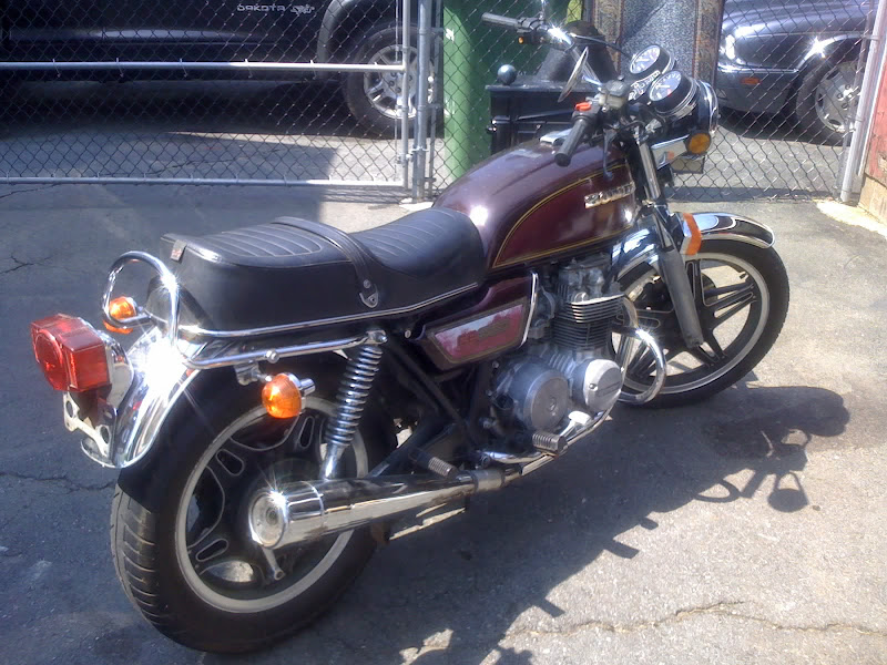

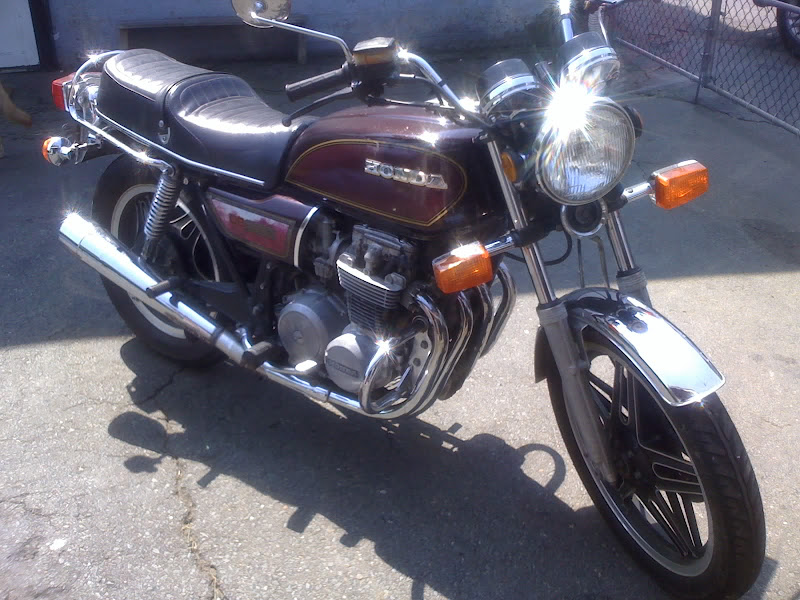

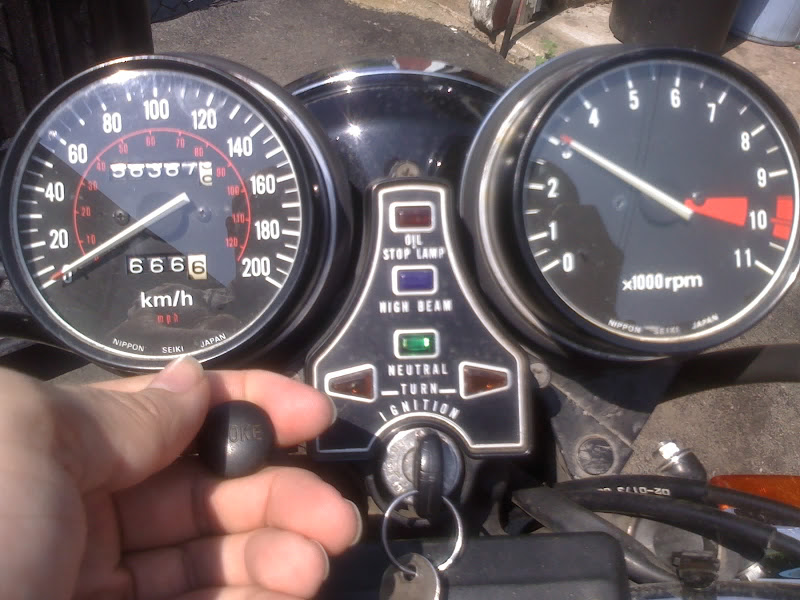

I pulled up a few more photo's from just after I bought the bike. These were sitting in an old back up I forgot about.
This is what it read when the speedo stopped working. Who knows how long that was broken for...

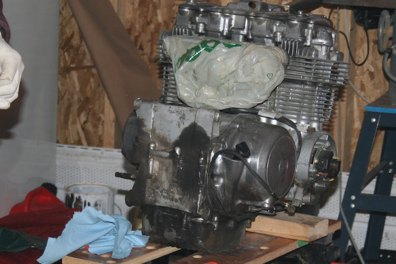

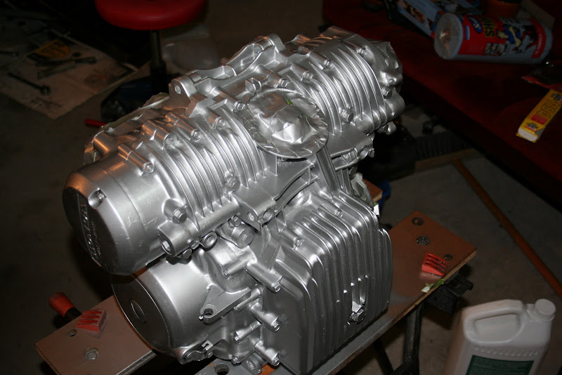

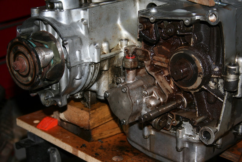

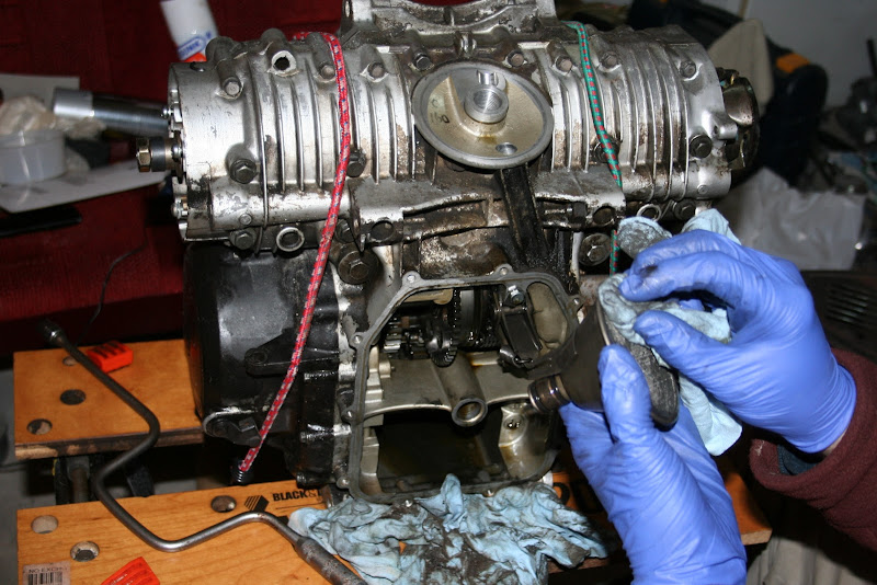

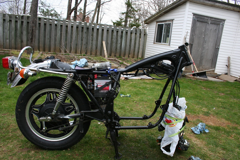

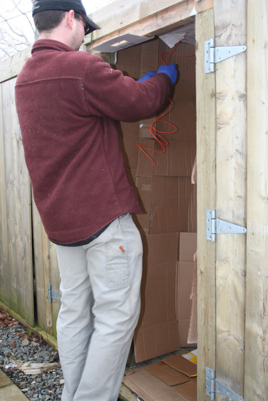

Cleaning the engine for paint was a real chore. It was filthy.
The oil pan off to be cleaned on its own. Those fins are a real pain to scrub.
First parts painted. The rest are almost done and ready to go together. Those engine covers are only on there to protect the innards. I have another set I've been polishing to go on.

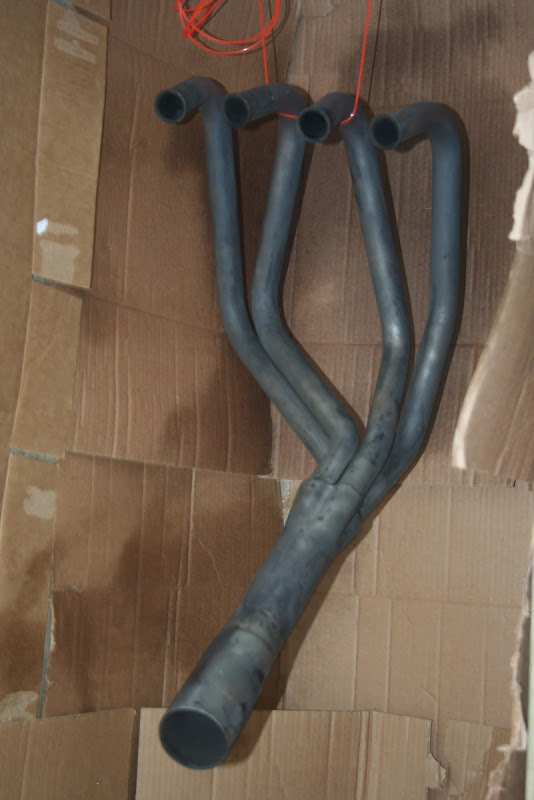

Brandon built a little paint booth by stapling cardboard to the storage space for my compost bin.
Perfect for hanging a set of headers :D
While the headers were being painted I was cleaning up the frame and shooting a few coats of gloss black Tremclad over the rusted spots. I was able to get a lot of the spots I couldn't get last year without risking black paint on the engine.

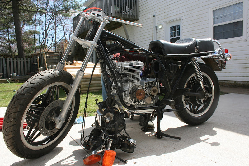

We have made some serious progress on the bike. We have the front end back on with the new triple trees and forks. Wheel is attached but brakes still need to go on and forks need to be filled. I haven't figured out where locally will be able to fill my forks with nitrogen for me, but I haven't really looked yet. The terrible black paint that was sprayed on them is stripped off but they are still begging for some tlc.
The motor is all back together and in the frame. Valves are adjusted. Static timing looks good. Carbs are installed, but without the airbox. We have the exhaust back on with new gaskets, and the muffler attached.
We gave it a few shots at running last night, but without any success. Splashed some gas into the spark plug holes, got one big back fire, and a little rumbling. The battery seems pretty weak so I suspect it may be that. I have it on the trickle charger so we will see.
I have a few things to sort out asap. First off is the front light cluster. When I swapped the triple trees I didn't account for the fact that the light mounts different on this front end. It has a big ugly bracket that attaches to holes in the trees. This has got to go and a cleaner solution is required. I have big headlight ears that attach to a chrome sleve and sit over the top of the forks, but they just don't look very nice so I'm thinking of a universal chrome headlight mount. I've found a few on ebay and other places.
The other mounting problem is the turn signals. This is a little more difficult. I'm not how I can clamp them to the front forks. I'd like to keep it as clean and simple as possible. I'm thinking I'll buy some small aftermarket blinkers and have to figure out a way to make them fit.
Once I've got that sorted out, the engine running, and the tank and side covers back, I'm on to mostly cosmetic work. I'll have a couple little things like attaching the chain and getting the last few things done, but it should be rideable soon.
Pictures to come.....

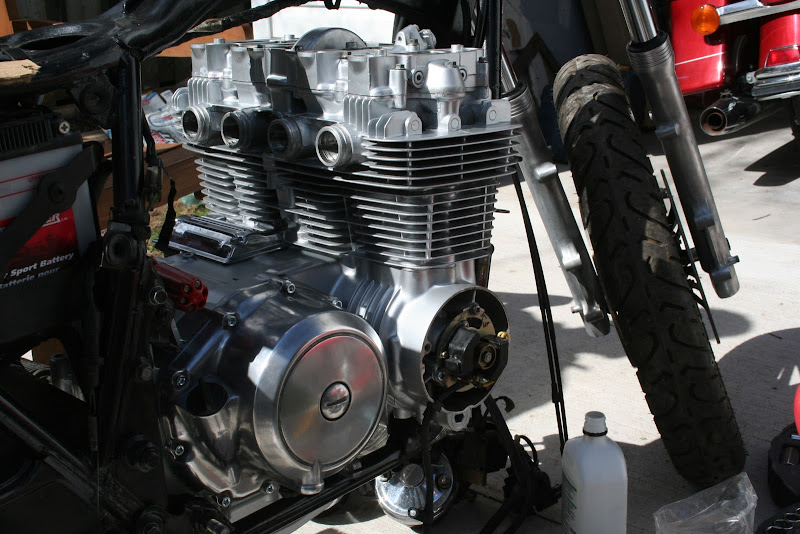

Offline IainC
  • Posts: 213
Re: IainC CB650 project log
« Reply #41 on: April 23, 2010, 09:41:15 PM »
Mmmm.... Pictures....

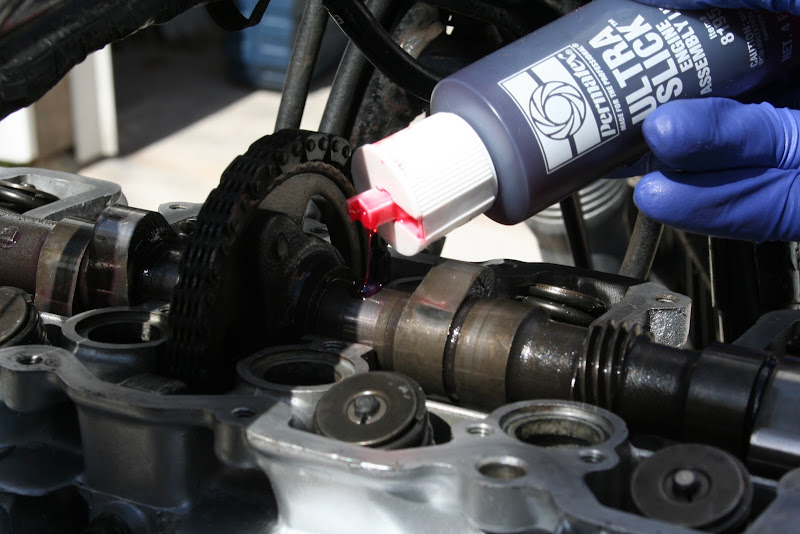

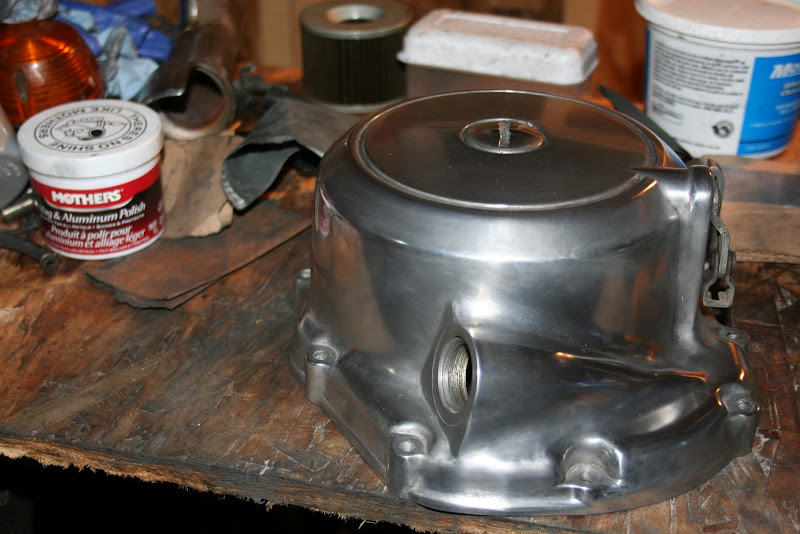

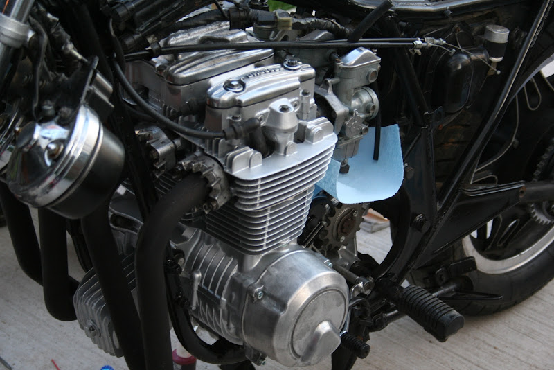

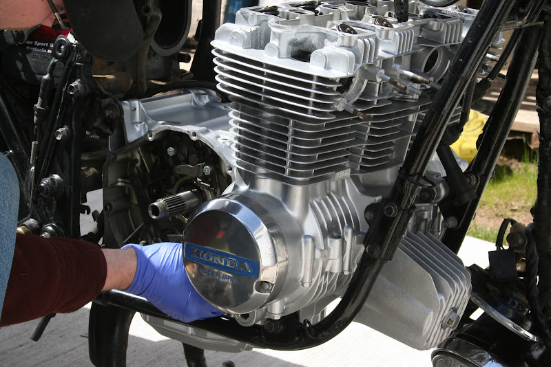

Polishing in a few steps. First sanding with 320grit paper, moving up to 600, then 1000, then mothers aluminum polish. Let's just say if it wasn't for the radio I would go insane doing this.
Wheeled it outside to work in the sunlight. Just installing the head here. My torque wrench doesn't like such low torque, so they are mostly tightened by feel. This is probably bad, but we opted to not take yet another trip to the store for more tools.
Gotta get those gasket surfaces nice and clean. I'm praying I have no oil leaks.
Cam installed. Was quite a bit easier to get right than I was expecting.
Don't forget to get that shaft lubed.  ;)
Once the head cover is on, we move on to the fun part....

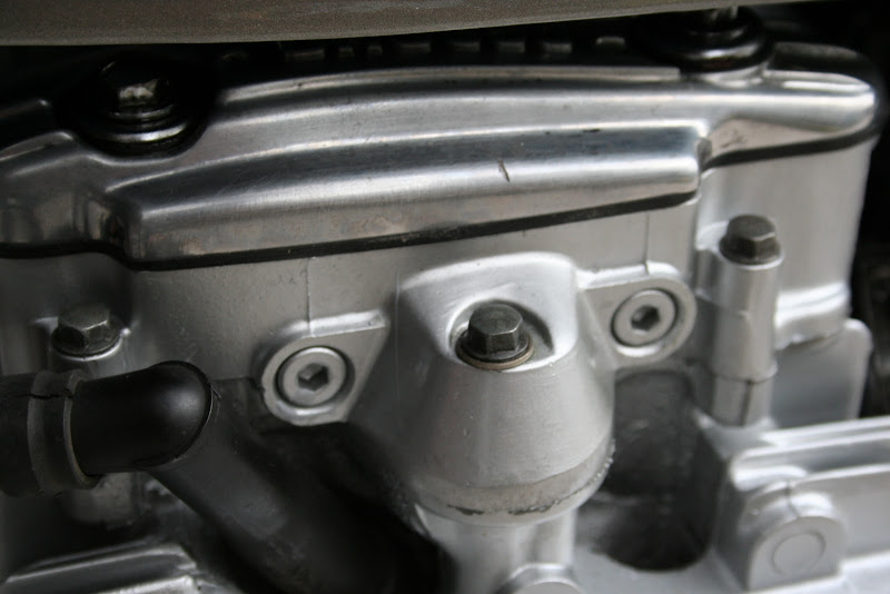

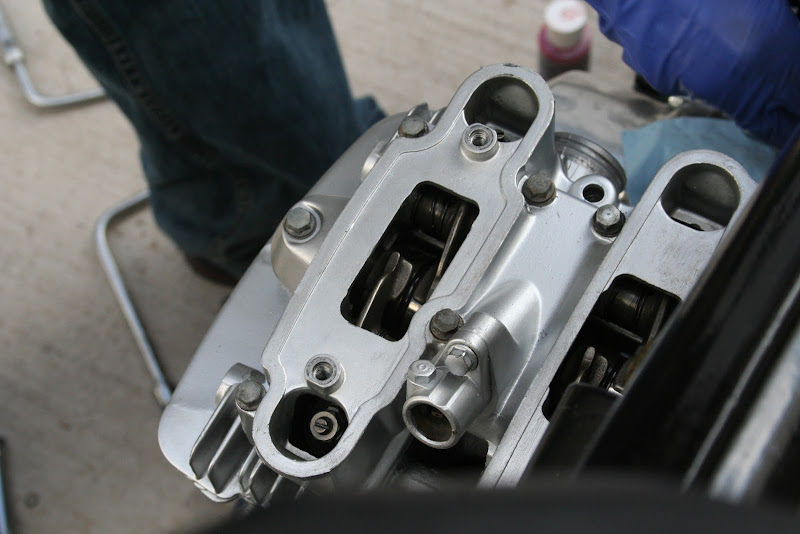

.... time to adjust the valves  :-\ They seem dead on, but I'll check them again after running it for a bit.
And it's back together!! Still have to finish polishing the valve covers, and the dyno cover.

yep, got to keep on cleaning and polishing things. Mothers mag wheel polish is good to maintain that shine

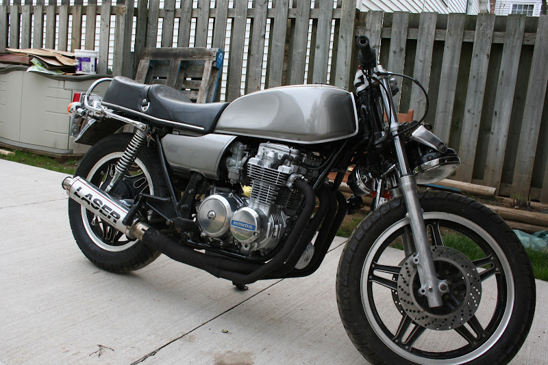

I took some pictures yesterday, there was a bit of sun out so they should look okay. Think I'll stay home tonight so I can get some stuff done and maybe upload some more pictures.  :)
List of things left to do:
Sort out front end. This requires filling my forks with fork oil, and replacing the seals. I'm sorting out my order for headlight and turn signal mounts, as well as new turn signals today as well.
I need to finish rebuilding the front break master cylinder, and get the brake calipers torn down, cleaned, painted and installed.
Haven't started with tuneup as I need to pull the head cover off to remove a bolt that sheared off in the cover. Must have been tightened down too tight and when the metal expanded from running it broke.
Chain needs to be cut down from 110 links to 102 links. Then I can install it.
I had my vinyl guy by yesterday, he came by with some mock ups for the side cover decals. We picked the colour, and he's going to get them cut for me for tomorrow, then we can see if the size looks right, if it does we will get the clear vinyl cut for them and get them applied.
Still lots of polishing to go but its just so terribly boring, and when your as tired as I've been its hard to keep your eyes open with the mesmerizing swirling polishing rag hypnotising you to sleep.

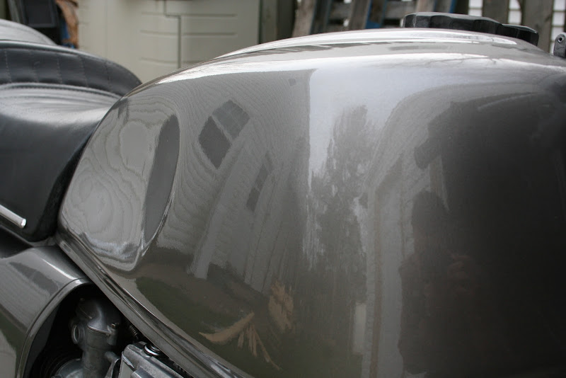

Offline IainC
  • Posts: 213
« Reply #48 on: April 30, 2010, 11:18:41 PM »

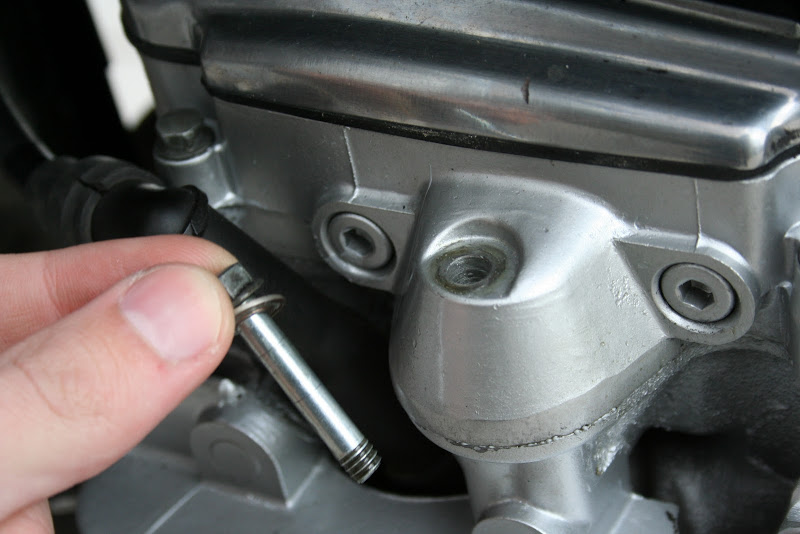

This bolt was leaking a lot of oil, so I went to tighten it and noticed it was super loose.
Oh look, it's broken.... hmmmm... good thing I have a replacement.
My freshly painted headers are flaking already. Guess that didn't stick well.

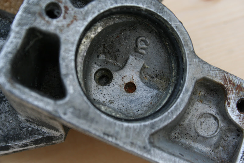

I'm rebuilding this master cylinder, should this small brown hole be clear? It's hard to tell if it will clean out.
Painted pieces are back. Thanks to Ron at http://www.greeneyedairbrushdesigns.com/
Two tone, the knee dents are actually a lighter shade. Hard to see but when you look closely it's there.
Found this in my mail box when I got home tonight. Going to see how the size looks tomorrow and then get the final ones cut.
