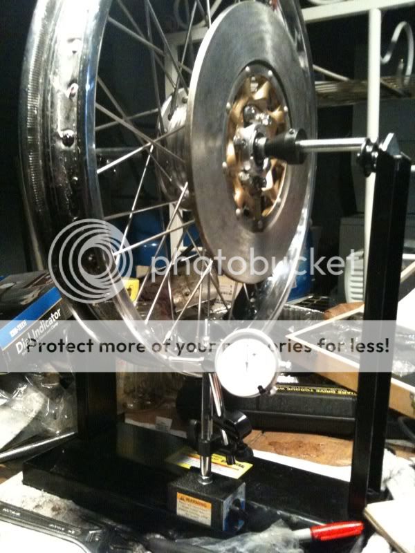

Here is a similar setup using Harbor Freight equipment:
Take pictures up close and full view before you take it your old spokes out:
And take some notes  ;D  Basically, once you get the first 4 spokes in, repeat the pattern 9 more times.
The FAQ has a great discussion on relacing and on truing.  I also found some good instructions through a Google search too.
http://forums.sohc4.net/index.php?topic=368.0
