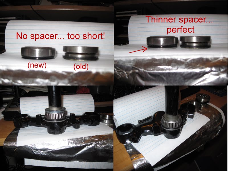

Today I also installed the lower tapered bearings on the steering stem.  More details on that below to go along with the pics.  This week I'm going to drop the frame and swing arm off at the powder coater, as my silver metallic powder re-order shipment came in on Friday.  So I documented all the points on the frame that I need to have masked off so the coater knows exactly what to do.  I not only marked them all with masking tape but took detailed pictures of the masking afterwards.  The masking is just there to indicate which holes to mask off; the masking tape is not the high-temperature kind so it's not a real mask job.  I also plan on dropping off a slew of bolts and miscellaneous small hardware parts at the electroplater down in Hayward to get stripped and galvanized (zinc plating).

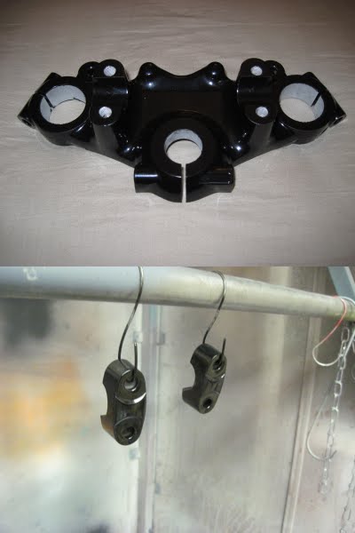

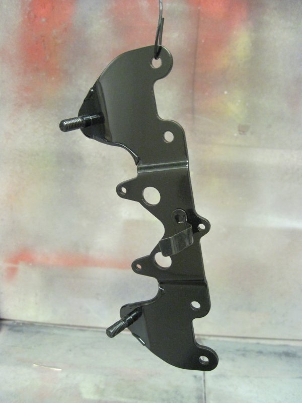

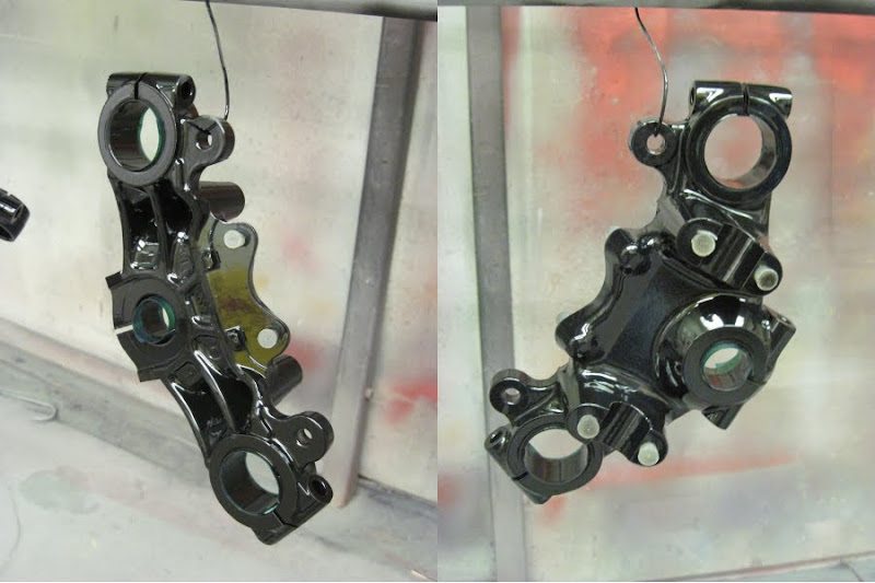

Okay, on to the pics.  The first handful are of the parts I powdered on Saturday.  I got the upper and lower triples done, as well as the center stand and a footrest bracket I missed from last time.  I also applied a second coat to the battery box in order to cover a few light spots that I missed the first coat.  I'll start there, since that part is now finished.  I bought some replacement rubber pads (about $1 each) and a new battery strap from BikeBandit:
Looks good, and I'm happy with the results, so it's now part of the "completed" stash.

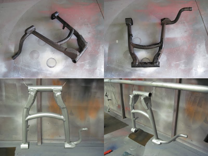

The center stand took some finagling to figure out how to get it to fit within the curing oven.  When carrying this by two small metal hooks, it's surprisingly difficult to hook properly onto the metal grate inside the oven.  Fortunately, I cook all my parts in the oven first before laying down any powder to drive out any stray oil/grease/water.  This allows me to test to see if the part can reliably be hooked onto the grate without much difficulty.  This center stand is about the limit in terms of size for that particular oven.  Its weight is also somewhat cumbersome.  You can't touch or even breathe on the part while transferring it into the oven, so there are practical constraints you have to think about.
You really see all the little weld splatter spots when blasting a part and coating it in a lighter color like this.  I really didn't notice them all that much when it was blasted, and I was trying to get it coated right away before any rust started taking hold.  Had I known these little nibs were sticking out all over the place, I would have filed them down first before blasting.  Oh well... it's a center stand, and they're original, so I suppose it's part of the bike's charm now. Certainly not going to do anything about them now...
Gauge mounting plate:

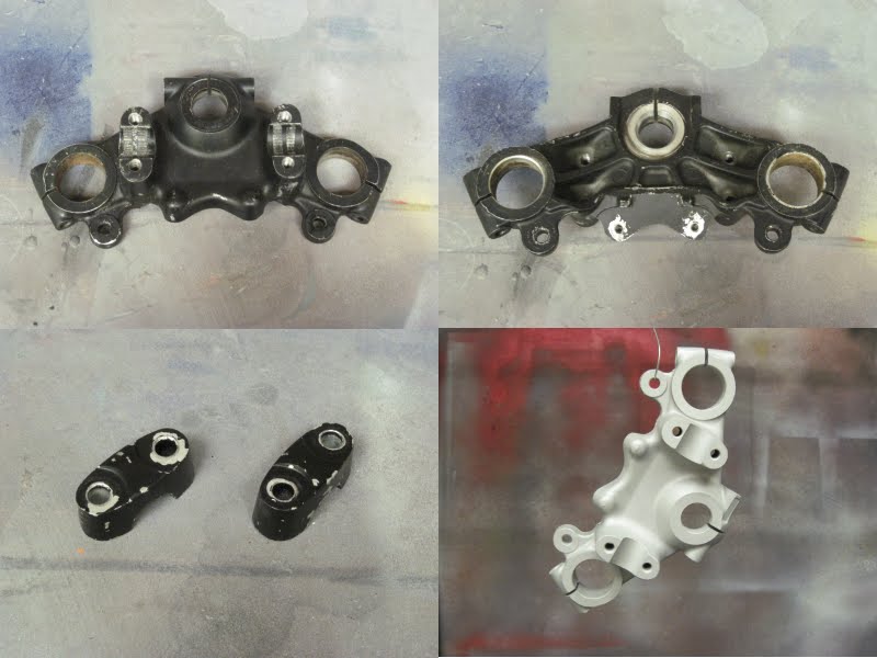

Upper triple:
... and lower:
I was satisfied with how the lower triple came out, so I decided to try my hand at the tapered bearing install today.  I followed this thread very closely while doing it.  Kirkn has done a marvelous job of documenting his bearing install, and it's far better than I could ever hope to do.  Mine basically went exactly like his, even down to which spacer was used.
I first bought a 3' section of 1.25" ID PVC pipe to serve as the distributed drift.  I then pieced together the old ball-bearing race and cone in order to figure out which washer from the All Balls kit to use.  There were only two choices, and I ended up using the thinner washer as it was an almost perfect match for the height.  I had the stem sitting in the freezer for about an hour, and put the new bearing into the oven at 200 °F for 30 minutes.  Dropped the spacer washer down onto the stem, then quickly went to work on installing the bearing.  Even with the expansion differences between the two parts, they still didn't just "go together".  I had to pound mercilessly on the PVC tube in order to seat the bearing all the way flush against the triple surface.  I used the broad face of a normal carpenter's hammer to do this after placing the thicker "spare" washer on the top of the bearing to serve as a buffer (visible in the lower-left corner below).  Two thermally-conductive metals at different temperatures in intimate contact with each other quickly come into equilibrium, and so I figure I had maybe 20 seconds before my heating/cooling was completely for naught.  Didn't really seem to make much of a difference, honestly, although I haven't exactly tried it without freezing the stem and heating the bearing, either.  After much pounding, the bearing was completely flush at the bottom, and I was done.  I then packed it full of waterproof (at least, water resistant) bearing grease and added it to my growing "completed stash":

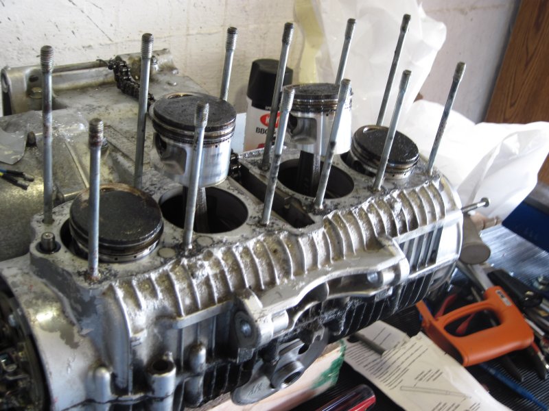

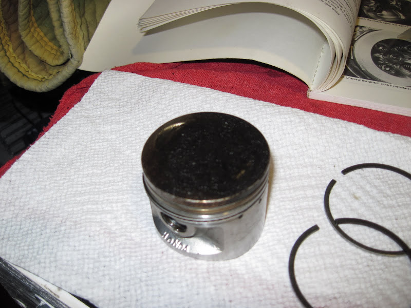

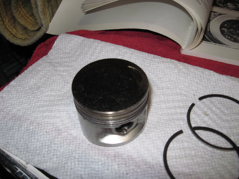

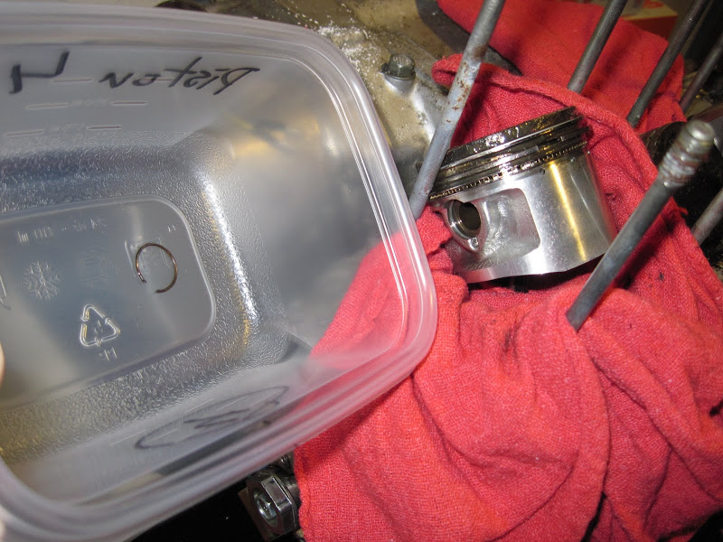

The last order of business tonight are a few pics of the pistons, which are revealed now that the stupid cylinder block has come off.  I'll post some more detailed pics of them after full removal, including shots of the steel cylinder liners.  I took some pics earlier of the liner walls, but my camera focused on objects on the other side of the tube and so there's no focus on the walls themselves... DOH.

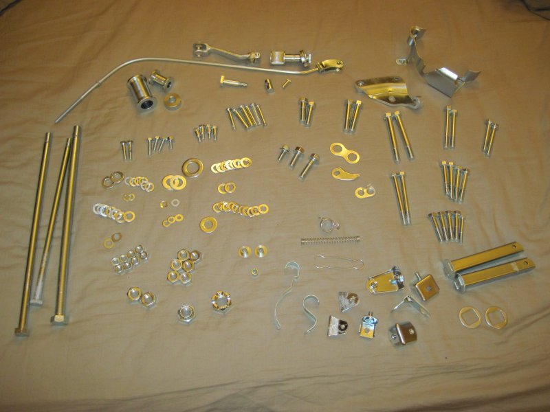

  • Get the bolts to the electroplater

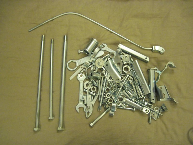

Also on Wednesday I dropped a big box of nuts, bolts, washers, and miscellaneous parts off at the electroplater.  I first took pictures of every last piece that I wanted done, and printed them off at actual size on my printer.  So my drop-off included this thick-ass binder of digital images, which the electroplater was really grateful for.  He said too many people drop stuff off with no documentation, and then complain about parts missing later.  Far too easy for stuff to go missing, especially with literally hundreds of small parts (I submitted a LOT).  Hopefully with the binder, they'll know whether they need to go looking for stuff before I show up.

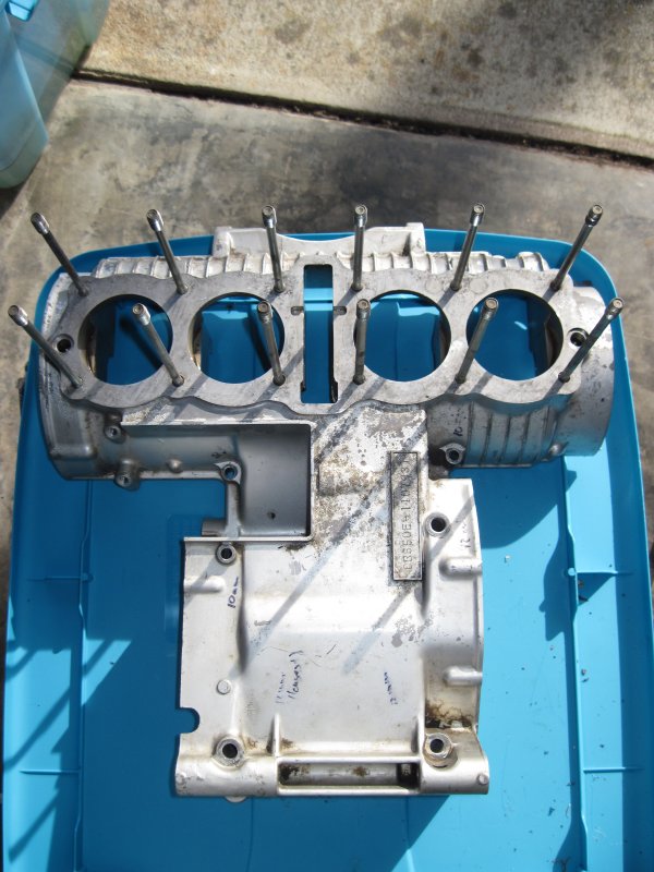

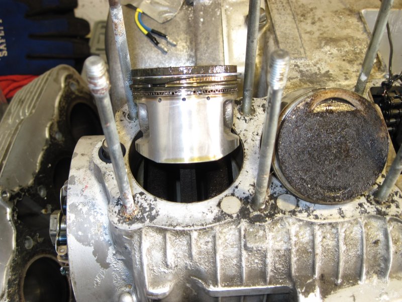

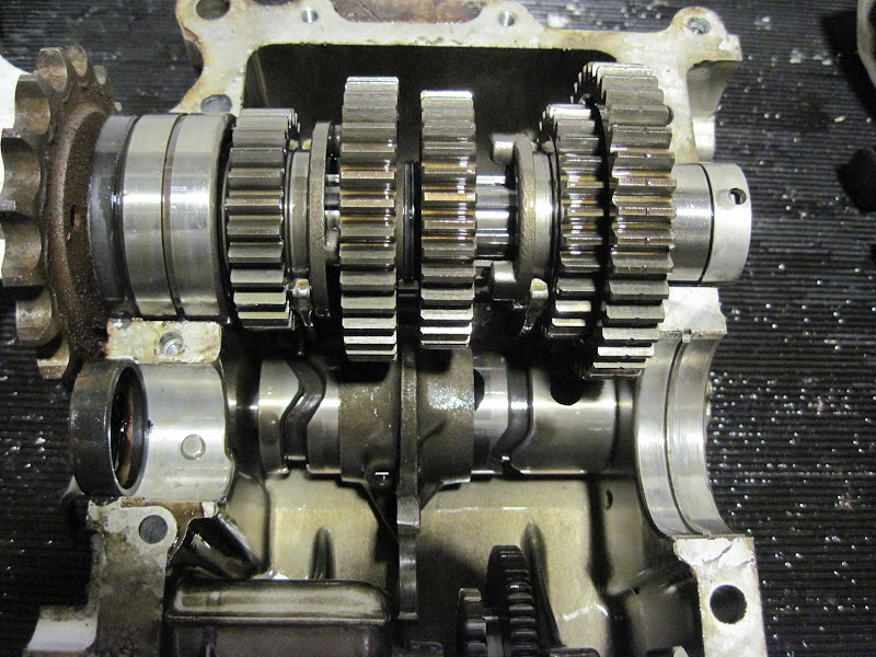

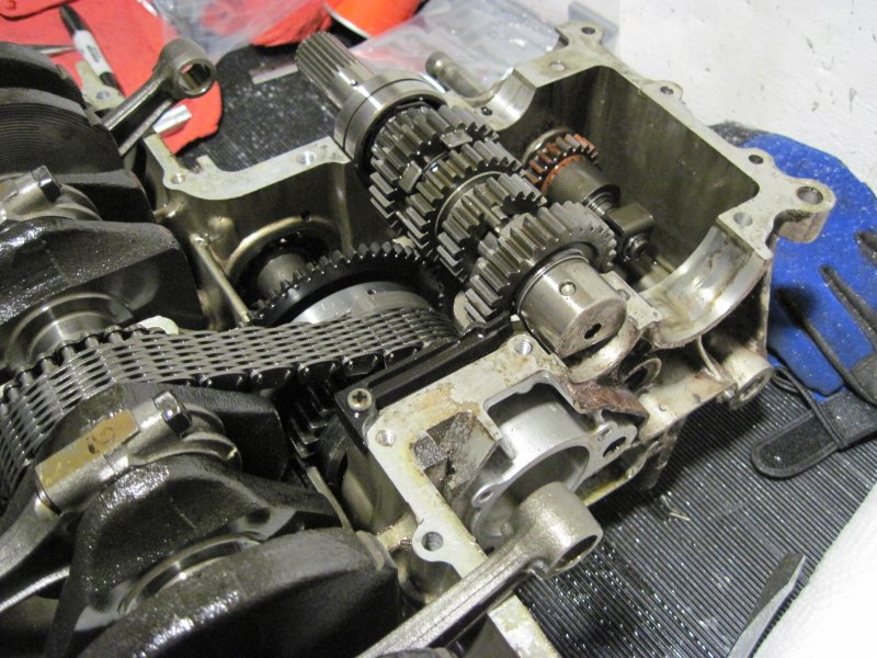

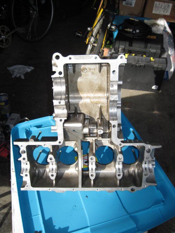

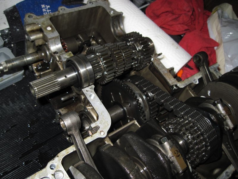

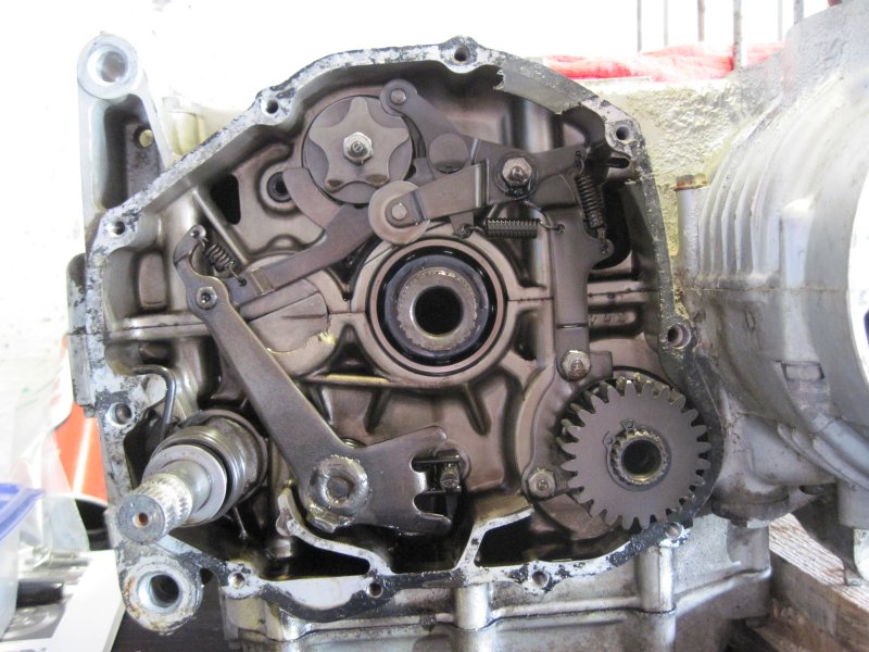

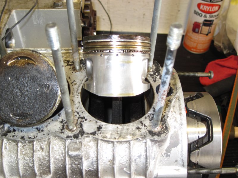

With the pistons removed from the crankshaft, it was time to split the cases.  Cracked off the clutch cover, yanked the clutch, pulled out the selector gear and related levers, and a number of plates and circlips inside that housing.  Found the 2,000 bolts that tie the top and bottom halves together and carefully documented them all.  Took a while to crack the cases in half, which is in line with my Achilles heel this entire engine disassembly process... getting two god-damned surfaces separated.  Had to use a small flat-head screwdriver as a wedge in an area with a thick spacing to crack them apart.  Managed to do it with minimal gouging in the surface.  Once they were cracked, it was smooth sailing.  Just pulled the top half right off and set aside!  What a tremendously rewarding feeling.
With the cases split, I went to town on the internals.  Pulled out the selector drum and gearbox, along with some other gear thing from the top half.  Followed the Haynes manual pretty closely.  There are some slight problems with the order of things, which I discovered just from not being able to extract something that should have otherwise been fine.  It's pretty intuitive, I'd say.  I took about 500 pictures during the entire process, a small smattering of which are given below.  Also made two quick movies to document some of the more tricky parts where pictures alone would not have sufficed.
After pulling out all of the gears from the top half, I went to town cleaning and degreasing it for paint prep with some simple green and hot water.  Scraped off the cylinder block gasket bits, the case mating surfaces glue, and tried to eradicate all of the grease and oil from the small crevices in the exterior sections.  Couldn't get it all out, but it will come eventually.  Just have to mask off the machined sections, mating surfaces, and tapped holes, then she'll be ready for blasting, priming, and painting.  Going with the standard duplicolor silver engine paint, as I want the engine to be as original-looking as possible.
Still trying to get the primary shaft out of the lower half.  That's the only thing holding me up at the moment from being able to clean and prep that section.
Okay, enough text... here is a sample of some of the pics I took along the way.
I'll post pics of the cleaned pistons once I get them all done.  Then hopefully the bottom half of the case once I get that damn primary shaft out.  I hope to be able to get everything prepped, primed, and painted by the end of this coming week so I can start engine re-assembly and time it well with when the frame comes back.

holy crap, all that stuff is clean. you don't really have to blast the cases to paint them, they are already so damn clean. I'm going to paint my case after assembling them. a lot less to mask off that way.
Offline TyMatthews
  • Posts: 102
Re: '75 CB550F restoration: Project Lolita
« Reply #159 on: May 24, 2010, 12:21:11 AM »
Nah, the pictures make them look a lot nicer than they actually are.  The gasket remover spray ate away the old paint, so it's peeling like crazy.  There's also some light pitting there on the top surface, near the starter cover.  Perhaps a strong blast with a power water washer would do the trick, though.
I'm concerned about painting over mated surfaces and gluing them together... they were hard enough to take apart with just the gasket; doubly so if there's paint in the seams, too.
« Last Edit: May 24, 2010, 12:23:10 AM by TyMatthews »

yeah, don't paint the mating surfaces, I'm saying that it would be easier to paint the case when it's all in one piece. mask all the holes or use crap screws, then I/you don't have to mask quite as much to not get paint on the inside or edges. that was my plan for mine.
whatever works, though. you seem to be cruising through this, you'll be done before me for sure.
Offline TyMatthews
  • Posts: 102
« Reply #161 on: May 24, 2010, 05:04:26 PM »
Not painting the mating surfaces directly, but the border between them.  That is, the gasket itself.  I'm afraid if I paint the cases when they're assembled together that paint will seep into the mating surface area and bind them together.  I've read complaints on these forums about some PO painting the engine while assembled and the current owner having to chip away in order to split something.  It also seems somewhat impractical to paint all of the engine while it's a giant block of metal.  Definitely easier in terms of masking, but the engine heft can't be discounted, either.  Having a nice rotisserie-style engine stand would make that point moot, however.
At any rate, I don't mind masking everything off.  I spent two hours on that top case alone, carefully scraping off the gasket and glue bits with a razor blade after scrubbing it down with simple green.  That's why it looks so damn clean ;)
I think I'll try the local power wash station and see if I can't strip off the outer paint with just a blast of water.  It flakes off pretty easily with a light brush, so it should be pretty straightforward.  Any rough/pitted spots I'll either sand down or hit with a stiff rotary brush attached to a power drill.  Media blasting would be fast, but I'm a little worried about getting aluminum oxide powder all over everything.  Maybe there's a hydroblasting company in the Bay area?

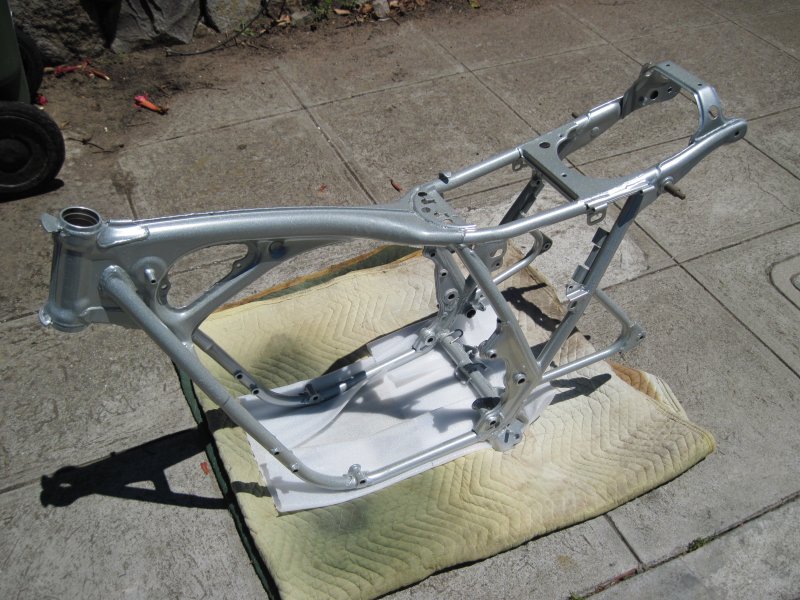

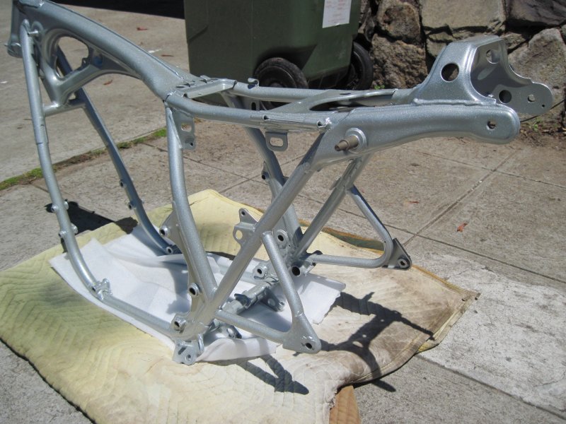

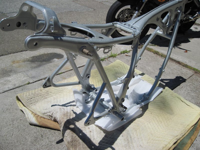

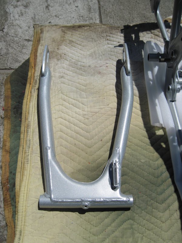

Day 63.5 update:
Hard to believe it's been 9 weeks already.  Man, how time has flown by.  I got the frame and swingarm back from the powder coater down in Hayward, and they both look fantastic!  Couldn't wait to share some pics, some I'm going to do that now before continuing on the rest of the afternoon.  I've already started putting small things onto the frame while working on the engine at the same time.  I'm not going to start throwing anything serious on there until the engine is back in place, so that I can do the "lay the engine and frame on their side" trick.  I've installed the lower tapered bearing race, side cover grommets, and the shock bushings into the swingarm.  The new bronze swingarm bushings and upper tapered bearing race are in the freezer awaiting their chance to get installed.

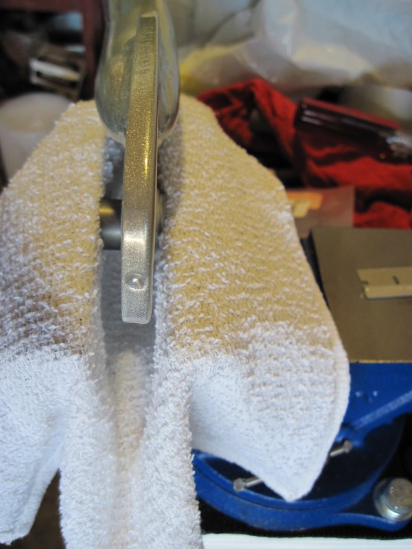

On with the pics:

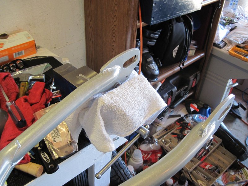

How I pressed in the shock bushings with the vise:

frame looks great!
So, what did you do with the frame tag?  Did they tape it off, or did you remove it?
~Joe
Offline Zaipai
  • Posts: 3,398
    • My Home page
« Reply #164 on: May 29, 2010, 07:11:44 PM »
I am so envious I so wish I had done powder coating.. Looks fantastic.. Love the color!

frame looks great!
I cut it off with the dremmel before handing the frame to the powder coaters.  They then masked off the two rivet holes.  I've since scanned in the original tag at as high a resolution as I could, and have started to clean up the image so I can have a new decal made up for it.  I'll then get a thin piece of aluminum and mate the two so that it can be placed back on the frame with new rivets.  There just wasn't any way to save the original without wrecking the aluminum, and there just wasn't any way I was going to let that area underneath the tag not get cleaned up and powder-coated like the rest of the frame.  I'm really happy with the way it turned out, so the extra effort in making a new tag will well be worth it.  At any rate, I've been told the DMV inspectors don't even care about that tag; the S/N engraved on the other side is the one that matters.
Yeah, well I'm envious that you're out there riding while I'm in the garage on a beautiful 70° day pressing bushings into a swingarm!   :)  My bike is in 8000 pieces right now... lol.  I also really like this color... so happy with the decision.  Which is good, since it's a little hard to change now!

Ty,
Frame looks fabulous! Lucky guy to have such a nice looking frame...
Bike's gonna look great when all reassembled.
David

Ty,
Did you get the primary shaft out?
There are some retainers in the case...look in the corners of the top of the case half and you can see the sliver of them between the shaft and the case.
David
updates?
No, the damn primary shaft is still in there.  I'll look for those retainers.  Nothing in the manuals about them, so I thought I had everything I needed out... but maybe not?  It won't budge at all, so maybe something is restricting it.

This morning the electroplater called and said my parts were ready, so I swung by there in the afternoon, giddy in anticipation.  I was not disappointed!  They did a really great job on all of the parts I submitted, with only a couple exceptions.  I ended up giving them some 150 metal pieces to do a clear zinc coating.  A couple small parts, like a washer or two, turned out a little whitish and not shiny like a mirror.  Then one of the passenger footrest pillions still has some problems on the far end.  But all in all, I love the results and am very happy... and, no parts were lost!
So I can recommend Electroplating Specialties in Hayward, CA for anyone who would like to get some parts plated.  They took about 2.5 weeks to get them done, but I told them initially that there was no big rush.  Their website is straight out of 1995.  They cleaned all the rust off of the parts first, and even took off some paint from a few pieces.  Almost everything looks brand-new; so shiny!
I first took careful life-sized images of everything and printed them out before dropping anything off.  That way if anything were to get lost, they'd know about it first.  It also helped me to re-organize everything once I got them back, since they took all of my carefully separated baggies of parts and threw them all together into a giant heap (see image below).  That's how they got plated... all at once in a giant batch.  Unfortunately for me, I have since discovered that I forgot a couple things that I'd really like to have plated.  That's the trouble with having parts all over the place.  Maybe if I scrounge everything together they'd cut me a deal for having done business with them before.
How I received the parts:
and after separating them for identification:
With the printouts in hand, identifying them was fast and easy.  Nothing left over, which is a good thing!

That rod for your rear drum isn't bent?
Just call me Timmaaaaay!!!
Offline Zaipai
  • Posts: 3,398
    • My Home page
« Reply #174 on: June 08, 2010, 05:36:21 AM »
Yea, looks bent to me, however I bet it can be straightened easy enough.. This is going to be a dandy restore, attention to detail is amazing..
