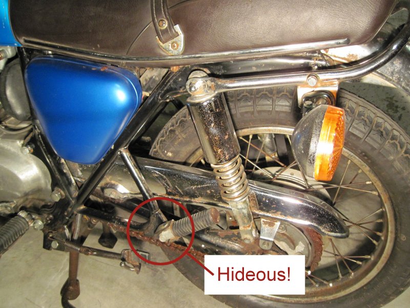

  • Get the frame sandblasted, then grind off the passenger foot peg mounts.  Those things look simply hideous.  It's like someone decided after the fact that they needed a place to mount the pegs, and simply tacked on a cheap steel plate directly to the frame in the cheapest method possible.  I don't like it.  So I'm going to fashion up a new mounting plate to fit flush within the inner contours of the bent tubing, then get someone to weld it in there for me.  This will move the rear pegs forward perhaps 3 inches or so.
    After that slight modification, I'll paint the frame silver.  All of the other chassis-related parts will be the same color.

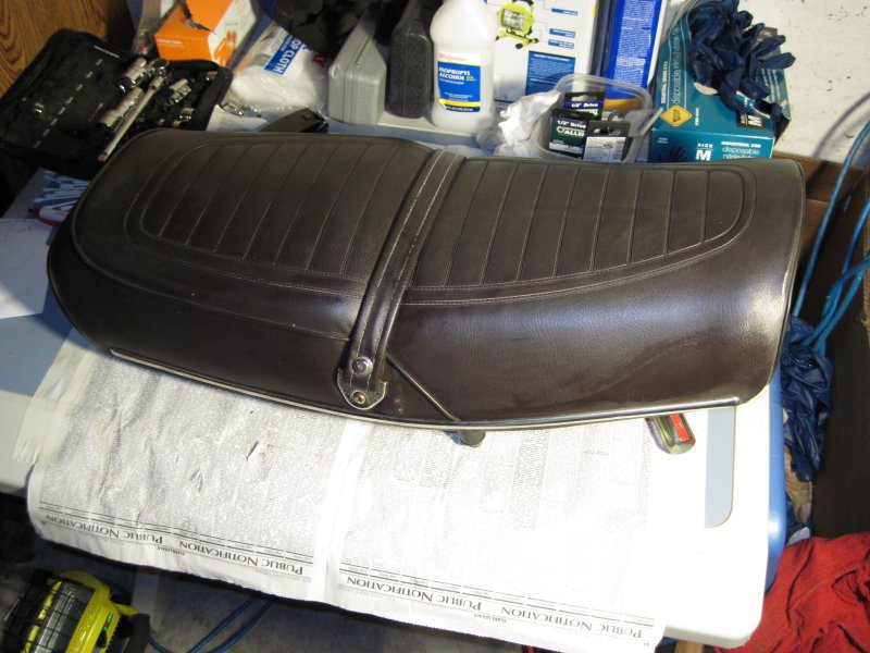

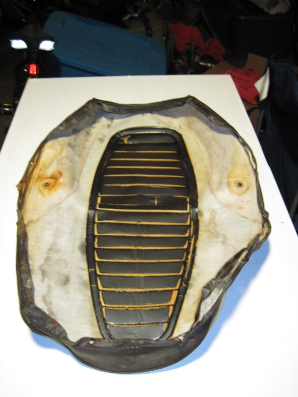

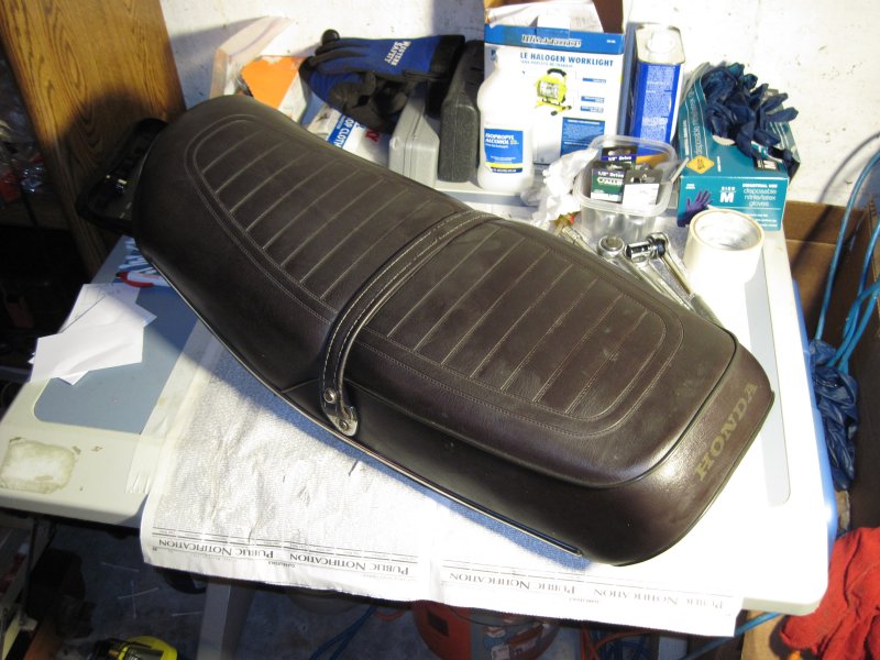

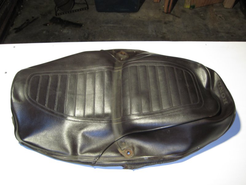

Day 17 update:
Spent this evening taking apart the seat in preparation for new vinyl.  As you may recall, the vinyl cover on this bike is brown, which is not desirable for my build (black is the target).  The vinyl is in really good shape, however, and I don't want to just pitch it.  So I carefully took it off tonight and made sure not to add any damage to it.  During the strip-down of the seat, I noticed that quite a few of the metal spikes that hold the vinyl in place were completely corroded.  Particularly along the side of the seat with the hinge.  Some were so bad they completely crumbled in my hands as I was wiggling off the vinyl.  I managed to extricate the cover without any problems, although it's apparent now that I'm going to have to do some kind of modification to restore the edge that is really gone.  Blasting and painting can't correct for something that doesn't exist anymore!
The foam is still excellent, without any tears, gouges, holes, or other missing bits.  It felt comfortable enough for me when I first test rode the bike, so I think I'll just re-use it after cleaning it up a bit (it has rust stains in quite a few places).  The seat pan looks solid aside from the edges that have corroded.  So I'll first blast the whole thing to bare metal and evaluate where it's at.  Maybe it'll be possible to cut out the corroded/thinned area and weld in a new strip. I  suspect no place sells just a replacement (stock) pan?  That would be swell if they did.  The replacement black vinyl cover and strap arrived today, so I'm good to go there.  The strap holders/screws were also heavily corroded, so I'll have to do some repairing there, as well.  More stuff to send off to get stripped and re-plated.

Nice build thread going.
Interested in selling the brown seat cover?

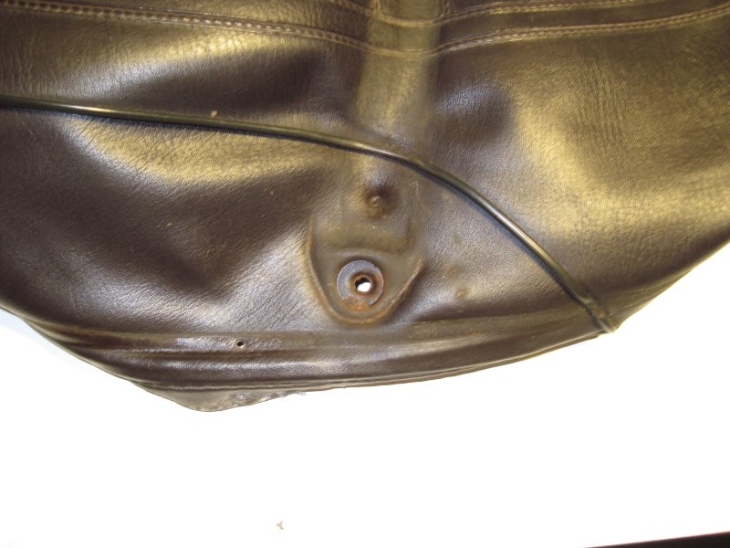

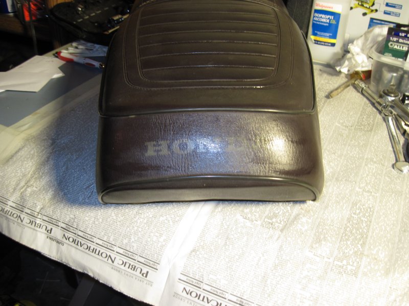

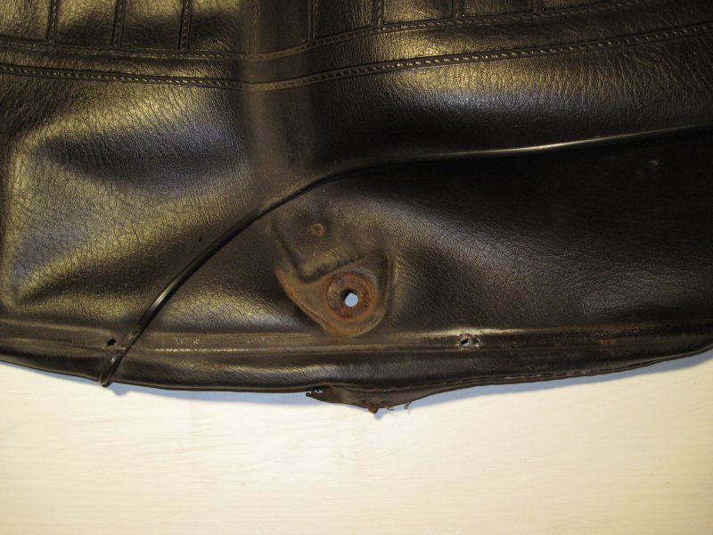

Indeed.  Here are some pics of the before and after.  As you can see in the latter images, there's some rust residue around the strap mounting locations, and of course around the rim where it directly latched onto the seat spikes.  Other than those rusty areas, the seat is in excellent shape as there are no tears or even evidence of previous repair jobs.  It probably just needs a good polishing.  I forgot to take a close-up pic of the strap itself, which of course would also go with it.

I say ditch the chain guard....ugly looking thing!

      How much for the seat cover?
      things seem to be progressing well.
