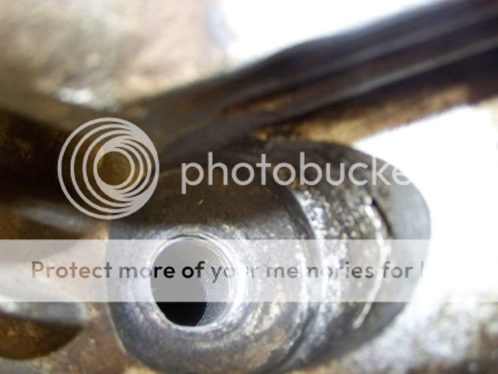

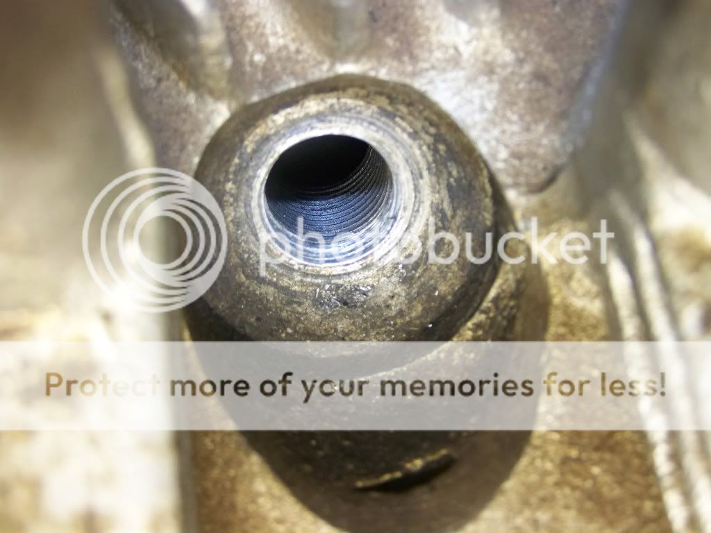

I recently pulled both plugs from my CB450 and on the way out either cross threaded or stripped the last 3 or 4 threads of each cylinder.  I am not sure which term to use being that the threads aren’t completely gone but rather spaced out now? The attached photos of my left and right cylinder might give a better idea of what’s going on with the threads.  My question though is, Can I chase the threads with a tap or will I have to run helicoils to repair the threads?

Hi.Try the tap first.Nothing to lose and may avoid a coil.

there is a tool available that will chase thread from the inside,out ie: good thread to bad.

Thanks, I found internal spark plug thread chasers for about $50.00, and they work from the inside threads out.  Does anyone have experience using these?  Will this repair the top threads that look to be crossed?

The top threads are probably history at this point, but it looks to me like you've got plenty of good thread left in the holes.  Chasing with a tap will probably result in the distorted threads breaking off, they're compromised now anyway.  Clean and de-burr the holes and threads well after you chase the thread, and you shouldn't have a problem imho.  Use care when installing plugs from here on out since it may be easier to cross-thread them in the future.

FYI in case anyone runs in to the same problem I did and would like to try and do the repair themselves.  On the suggestions of other members, I picked up an internal thread chaser from my local auto store and ran it through a couple of times and it worked.  I was able to insert the spark plugs without any problems, and the best part about it is that I got it for $20.00 on clearance.  Now I can finally work on getting it running again.
