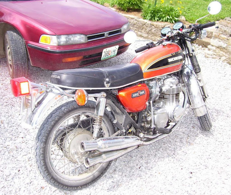

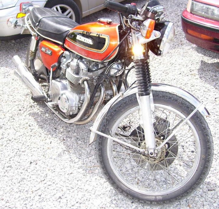

This is the condition I bought it in, no changes.

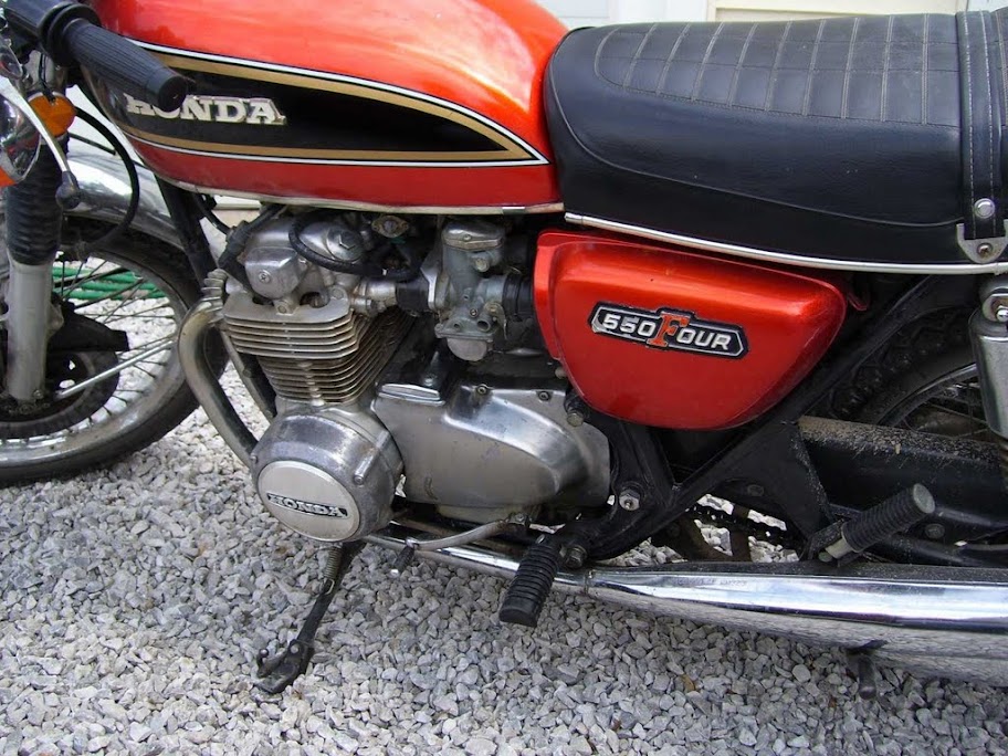

The paint was in bad shape:
Leaking oil and dirty carbs:

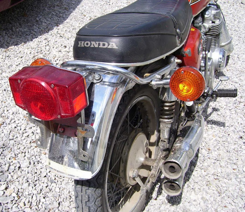

I have nightmares about this taillight:

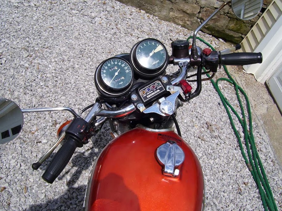

The previous owner added the clubmans, most of the stock switches didn't work:

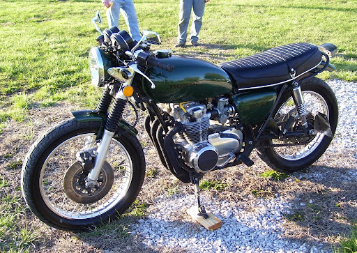

So this is what I had to work with, I had never done this before but I decided to just jump in. It has been a while since I did it, and this is already a long post so I'll just skip to the after shots :). If you have any questions about the build please ask!

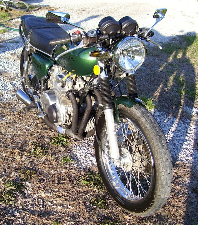

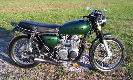

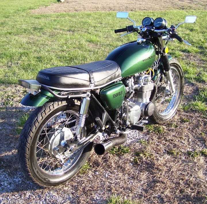

Nice and clean:
I fabbed the exhaust after the 4-to-1s myself, the taillight is from a Ducati Monster- the mounting bracket is custom:
I fixed all of the stock switch gear, I had the decals custom made:

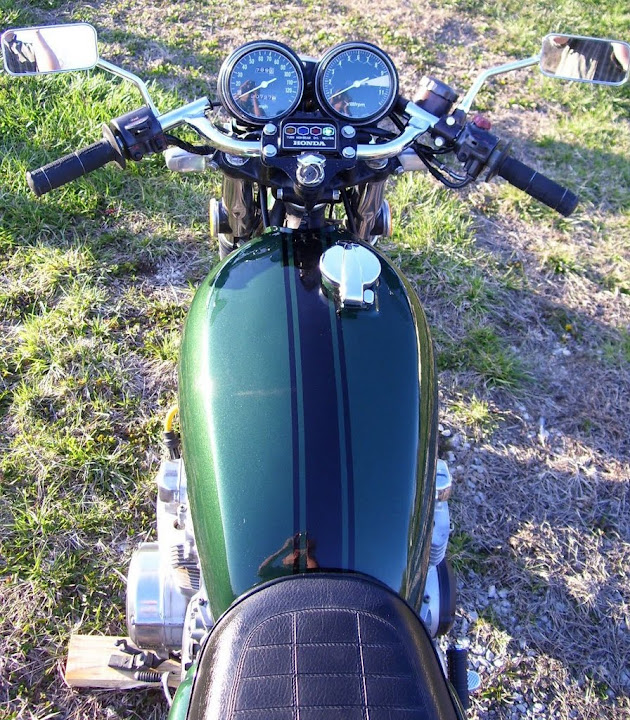

A view of the racing stripe. I did the paint myself, It was scary but not as hard as I expected. The taillight is all LED with integrated yellow turn signals:

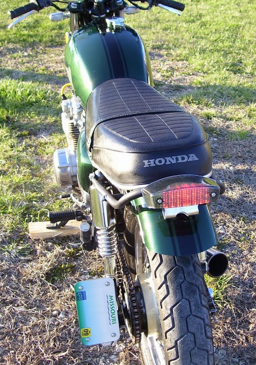

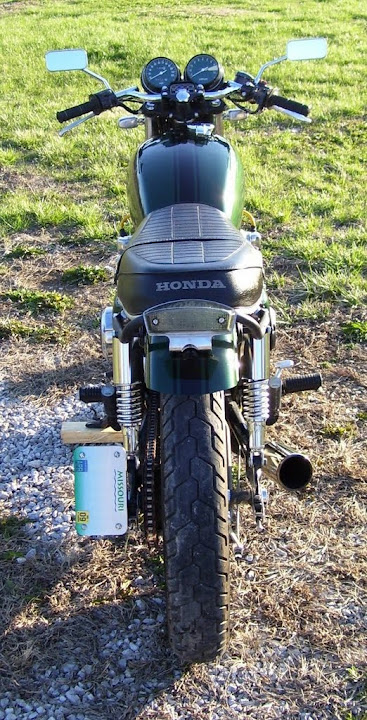

A lot of polishing- my fingers are still sore :P. I made the license plate bracket also:
Still need new gauge faces:
Tail light lit up:
   I couldn't wait till winter to do it so I lost about 3 months of prime riding season, but oh well. There is still a little to be done- I really want to paint the engine, but that can wait 'till winter. So what do you think? I just picked up an '80 CB750F that needs similar treatment so any feedback is appreciated ;D

  The exhaust started out as a MAC 4to1 from Dennis Kirk, I took off the muffler and brought it in to a muffler shop where a guy charged me $10 or $15 to bend a piece of 2.5" pipe to match the bend of the MAC. After I had that, I welded on a stainless steel exhaust tip-resonator from a diesel truck, welded on the mounting tab, wraped it up and that's how it turned out ;D
