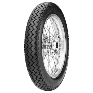

Tires... they're not too far down the road on the to-do list.
I want a vintage look, so I was leaning towards Avon Speedmaster up front, but I am not crazy about the matching rear for an 18" rim:
Coker has a Firestone rear that I like much more:
Or should I go with something more contemporary in the name of safety, like Metzler Lasertech:
Gimmie some input.

Hey Digger.  I've been pondering the same vintage tire look for my RD350.  I like the Avon.
I may go with Bridgestone L303, but I need an 18" front, you prolly don't.
http://www.jcmotors.com/p-27675-bridgestone-exedra-l303-oem-replacement-cruiser-front-tire.aspx#tab1
What about K70 for the rear?   16"??
http://www.motorcycle-superstore.com/14/72/963/20557/ITEM/Dunlop-K70-Rear-Tire.aspx

I like the Dunlop for the rear.  If I was running a 16 instead of an 18, there would be a lot more out there for me.

That vintage avon up front with the zig zag treaded rear would look so perfect on your bike dude. I feel like that would just work so well. Also, your frame is just plain beautiful.

Most of the people I've talked to who picked tires based on how old school they looked have told me that they regret it.  Specifically those FireStone-alike Cokers...
I rock a set of Avon RoadMasters on my CBX, and I am very pleased with how they work, and not unhappy with the look.
Re: 78 750F Chopper/Digger - Frame Painted
« Reply #270 on: August 15, 2013, 01:22:21 PM »
+1, I know of a guy that have to have Firestones, 2 weeks after fitting them he had his mechanic take them off and throw them in the bin... I think Dave500 knows a guy thats currently doing the same thing....

It's a shame, because they're a really beautiful tire IMO.

Anyways, here's where it's at.  Wiring is half done.  Tank is mounted, front end is together, MOST of the sandblasting/painting is done.  For the most part, we are down to final assembly.  The wheels on the bike are not the ones that will be used.  Those have been cleaned up and are waiting for new rubber.  I am leaning towards the Avon Speedmaster front/ Safety Mark II rear.  Brakes still have to be installed along with a bunch of other misc stuff.

Looking great Digger.  I like the Avon Speedmaster, not familiar with the Safety Mark.
