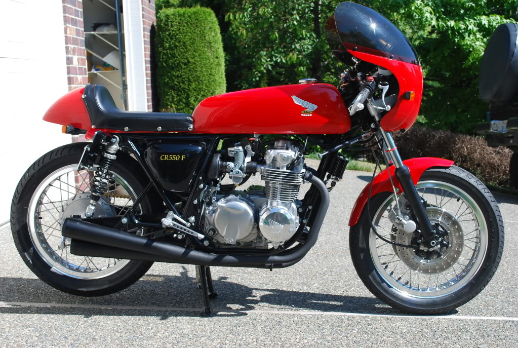

Pretty excited to have just discovered your build.  I love the commitment to quality you've put into this project and I'm really looking forward to seeing you on the road on this beauty!
1975 CB550 cafe
1971 CB500 stocker
