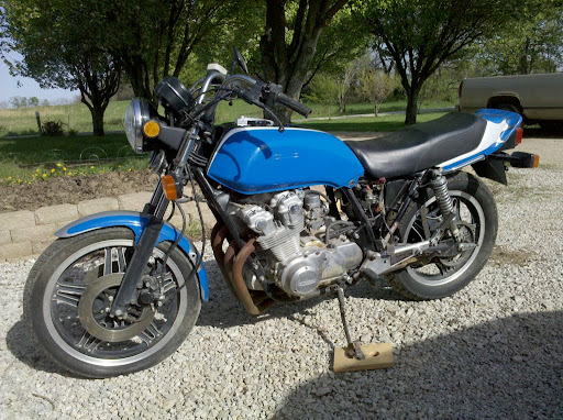

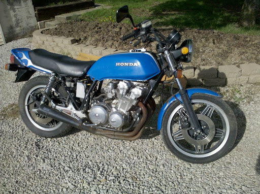

    What I was really looking for was a blank slate, just an engine and frame, something I wouldn't feel guilty about tearing up. This is what I found:
    Not running? Check. Missing parts? Check. Paint-by-numbers flame job? Check. Absolutely perfect!

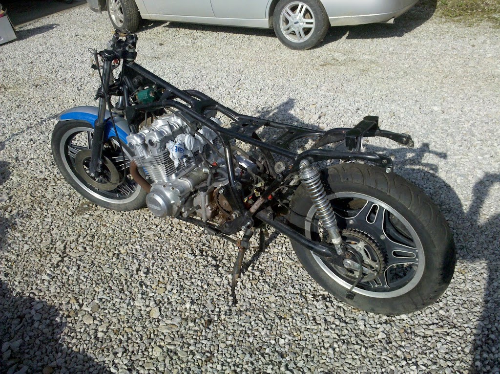

    It was sitting for quite a while; outside, but under a carport

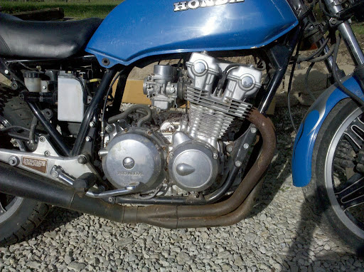

    And the main reason I bought this bike: the big, beautiful engine
    Admittedly this was a risky buy. I brought my compression tester to the seller's house to check the engine, but the starter wasn't working, it has no kick starter, and to top it all off: no chain! So there was no way to even see if the engine was a solid, melted-together chunk of steel and aluminum inside :-\. The guy who was selling it, Steve, told me it had been running not long ago when it was owned by a friend of his. This guy had torn it apart to paint it, but before he could put it back together his house got foreclosed on so he had to sell it for some extra cash. Steve bought it because his wife has a bike and he thought it wouldn't take too much to get this one running; he thought he could use it to learn on and then go on rides with her. Well, Steve had some medical problems so he put it off for a while, then he found out that this was a sport-bike and probably not the best thing to learn on. To Craig's list it went, and after talking him down $200, it came home with me. As an interesting addition, he picked up a front end from a swap-meet that appears to be from a '85 CB700 nighthawk. It's pretty cool, and I think I'm going to use it... more on that in future posts.
    The first thing I did when I got home was hot-wire the starter to see if the engine turned.... success! It turned over strong and it sounded like it should; so it wasn't seized, check it off the list. Next I drained the oil, luckily it was full, and it didn't look too bad. No gear teeth came out, and the oil was black and had no signs of moisture inclusion. Check two. Now the wife and I are really getting into it, tonight we check the compression and continue the tear-down.

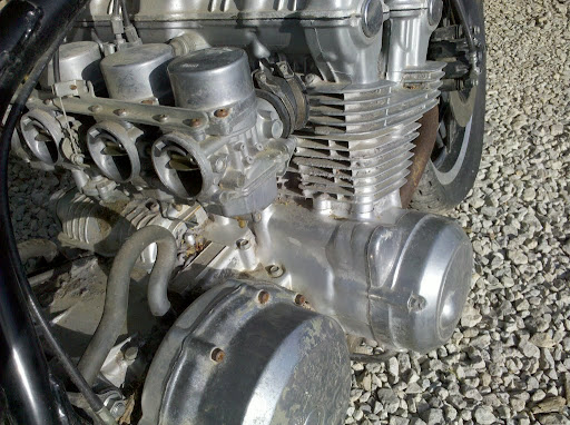

got the carbs soaking-
all that's left is the engine-

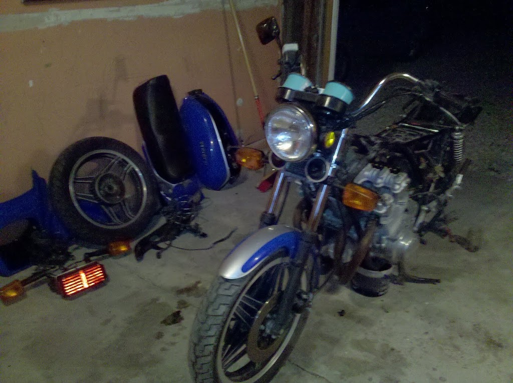

I mentioned that I got the front end of an '85 CB700 with the bike which I wanted to put on, but after much deliberation I decided that it will be too much trouble to make it work. For starters, the triple clamps that came with it have the wrong steering stem, and both the old and the new are welded into the lower tree so no-swappy. Also the '85 shocks are a good 2" longer than the '80's, so it would look funny with that much shock sticking out above the top clamp. Oh well, they'll probably find their way onto ebay :P.

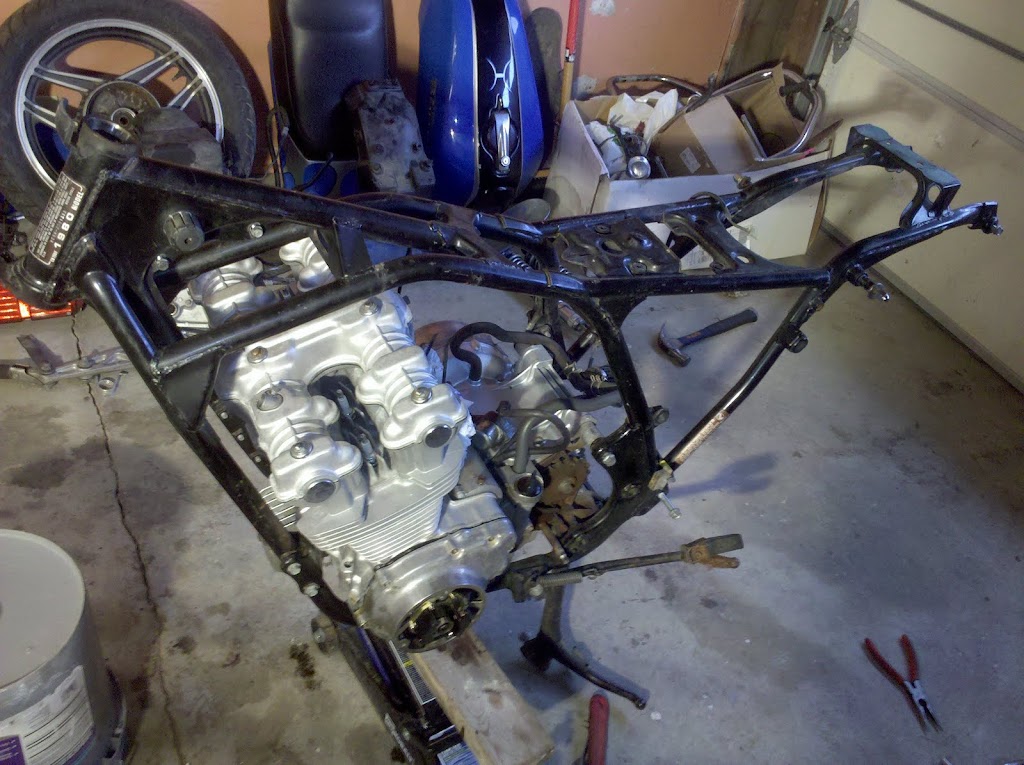

We started rebuilding the breaks. The master cylinders are trashed, but the front one that came on the spare front end is in good shape, so it wasn't all lost. Up next: pull the engine out and lift off the valve cover, here's hoping I don't need to replace 16 shims!

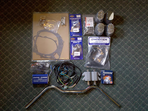

New parts! The UPS guy has been making more trips down my long gravel road lately to bring me motorcycle goodies:

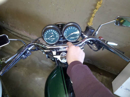

Some maintanance items- master cylinder kits, gaskets, exc... some upgrades- Dyna 2000 ignition, Dyna 2.2 ohm coils, plugs, wires, filters... and a couple of appearance upgrades- a stainless steel bolt kit, and Norman Hyde "M" bars. I'm really excited about the bars, I think they look great, and they have a very similar bend to the ones on my CB550 which I find very comfortable.

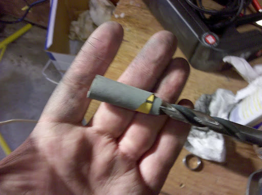

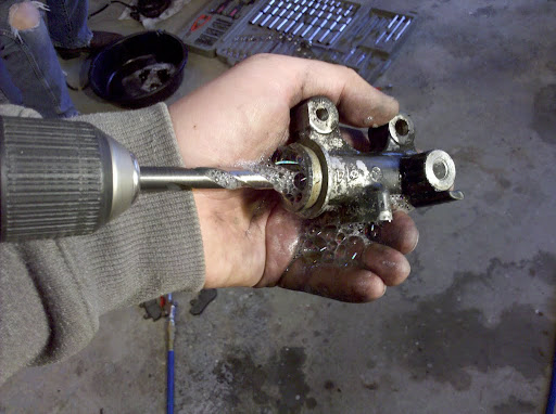

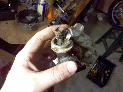

It was not pretty, the retaining ring was so rusted I broke both of the circlip eyes off and busted the tip off of my circlip tool in the process. I finally worked it out with a screwdriver and a lot of WD-40. It took a claw hammer to pull the piston out of the cylinder, and inside was some nice thick and chunky mud. The cylinder wall had a good bit of corrosion and pitting so I used my tried and true small cylinder honing technique to polish it up. I take a drill bit that is a good 1/8" smaller than the I.D. of the cylinder and I wrap it with 2000 grit wet-dry sandpaper. Just take a strip about 2"x8" and fold it in half long-ways so it is 1"x8", then wrap it really tight around the bit in the direction of rotation. I add or remove some sandpaper so it fits snugly in the bore
Then I work it back and forth at about 300 RPM with a drill and flush it with a lot of soapy water to keep the sandpaper from loading up and to keep any chunks from scoring the wall
It works like a charm every time, you may need to do it in a couple of steps depending on how bad it is. I would have taken an after photo but the master cylinder is in a nice bath of MEK to prepare it for paint.
