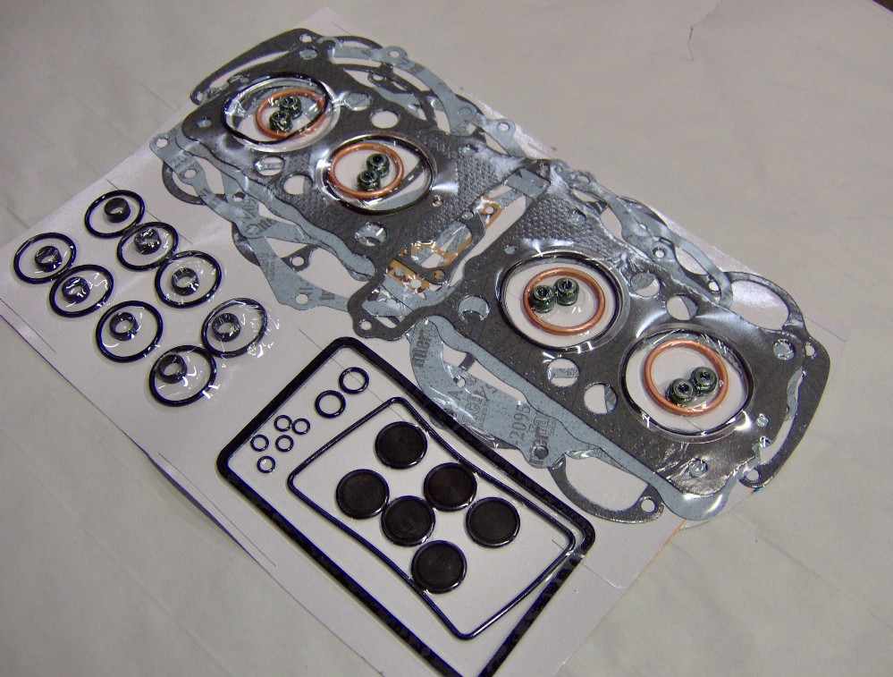

They specifically say in their blurb
Athena gasket sets are missing the  "o" rings for the valve inspection covers.
Vesrah gasket sets are missing the 6 cam tower plugs ( quarter size plugs under the cam tower )
Our gasket sets are COMPLETE, with all necessary gaskets and "O" rings for a rebuild. ( oil seals are separate )

can't wait to hear the report there SKTP!  and vorhese, i meant that if you scroll down some, there's a kit for $88 that includes the oil seals too, not too bad!

Oh, so it's probably just an Athena set with the o-rings, sorry about that.
I dunno, I'd probably try to go all Honda or Cometic if it was me on a rebuild.

I have heard of the Athena and Vesrah gaskets not being of great quality.

i've heard the same.  i've seen pictures of the athena's straight out of the box with severely warped bores and other gaskets not even being close to fitting and true...  but Ken doesn't like to sell really crappy parts, and it looks like he bunches them all together and shrink wraps them all before shipping, so maybe you're getting decent quality?

I just did mine with Cycle x's kit.So far so good,I just put about 100 miles on my rebuild and no leaks.(HD studs probably helped)Nothing like a Carpy pipe and fresh compression,SAWEEET!
