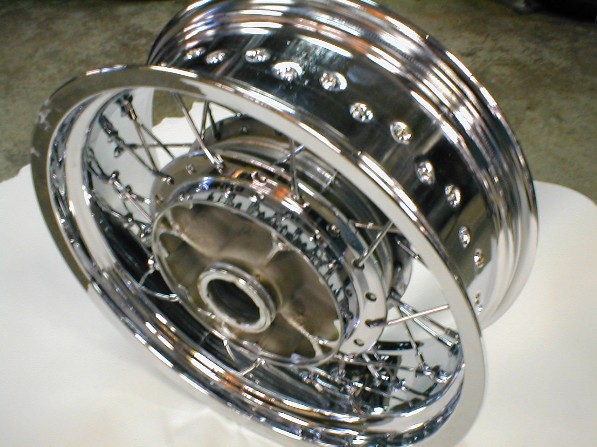

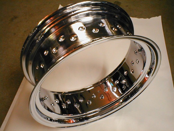

Hmmmm, if i am correct the K8 output shaft sits further out than on the earlier K models, they have a wider rear rim as well and a wider rear sprocket carrier, so maybe no offset front needed.... Give Ken a call at Cycle x and ask him, he has been doing these conversions for years.
http://www.cyclexchange.net/Wheel%20Page.htm
http://www.cyclexchange.net/index%20pics/newest%20wheel%205.JPG
http://www.cyclexchange.net/index%20pics/big%20web%20rim.JPG
