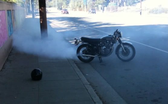

I found the thread I was thinking of, along with another one.
This one may need to go into FAQ  AND TRICKS AND TIPS  for people getting read up on doing a top end! It might save someone a lot of hassle.
Rebuilt top end burning HUGE amounts of oil.
http://forums.sohc4.net/index.php?topic=60893.msg695085#msg695085
"350F puking oil"
http://forums.sohc4.net/index.php?topic=7016.msg64957#msg64957
I figured it would burn off after a few minutes. But it did not. In fact, it filled my neighborhood with noxious smoke.
I coasted it down the hill to a wider, less populated street and started it back up. Let it run for 20 minutes. Still churned out the same amount of smoke with no signs of letting up. And it appears to be coming from all four cylinders more or less equally.
When I got it back home, I checked the oil. Dipstick was bone dry, though I had refilled the crankcase after reassembly.

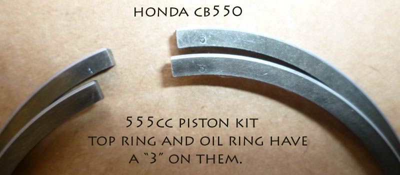

Oh boy now you've got me wondering.  I have a 555cc kit from E-bay too.  The oil ring is one piece, seems like there's no right side up or upside down.  Still putting the bike back together so I don't know if it's going to smoke.
Offline faux fiddy
  • Posts: 4,810
  • bike in a box
Re: rebuilt top end - white smoke on first startup
« Reply #18 on: June 12, 2010, 04:15:32 PM »
Look real close near the gaps if the rings are not installed yet, the marks are very tiny.
One of those threads describes a difference in the shapes of the edges,  too.

For anybody else with one of these kits, here's a picture of the top ring and the oil ring.  The middle ring is pretty easy to figure out because it has that cutaway at the bottom.
Good thing I read this thread before I finished putting the bike back together!
