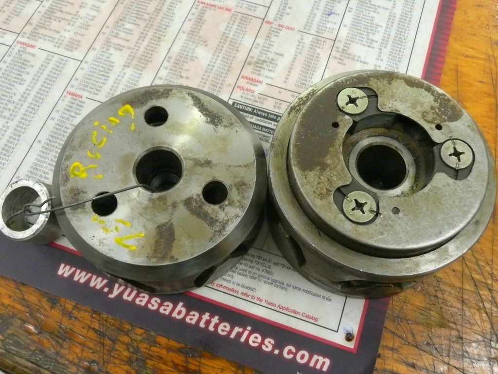

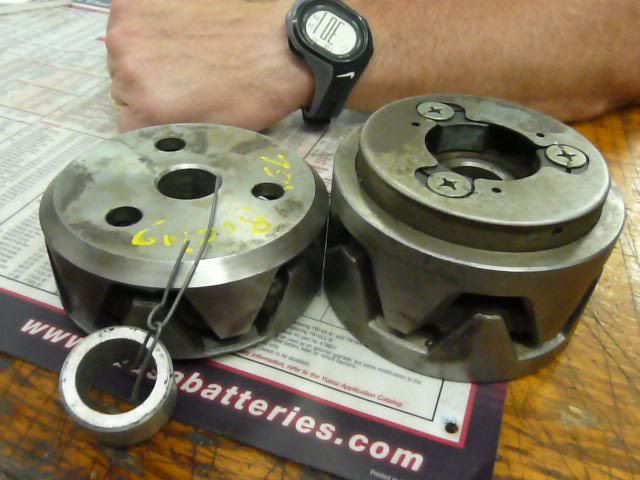

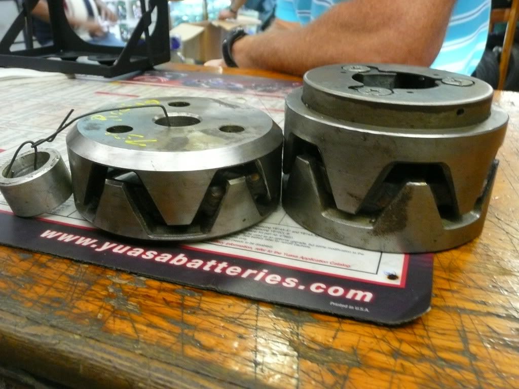

There's been some discussion here lately about light weight alternator rotors so I thought I'd do some digging and get the factual information.
Comparing a stock late model rotor to a RC Engineering light weight rotor you can easily tell the difference. This stock rotor with the starter clutch intact weighs in at 5lb 12oz while the RC rotor without starter clutch weighs in at 3lb 6oz. I first thought the RC rotor might have actually been from a smaller bike ie 350/400 but I did not have those to compare to. It could perhaps be but it can be turned down from a stock 750 rotor as witnessed by the comparative pictures. You'll also notice what appears to be a spacer to make up for the shorter width of the RC rotor.

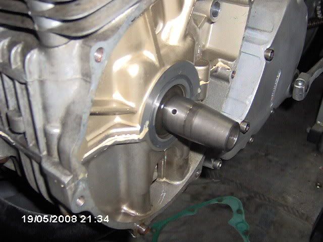

Think the spacer is not to compensate for the smaller width, but to 'plug-off' the oilchannel in the crank. This channel provides oil to the starterclutch.
This is my rotor.
Oil channel
My spacer is a innerring from a ballbearing.
Cheers, Rob

This is a 750 rotor that I lightened, nothing done to the crank.
Rob
