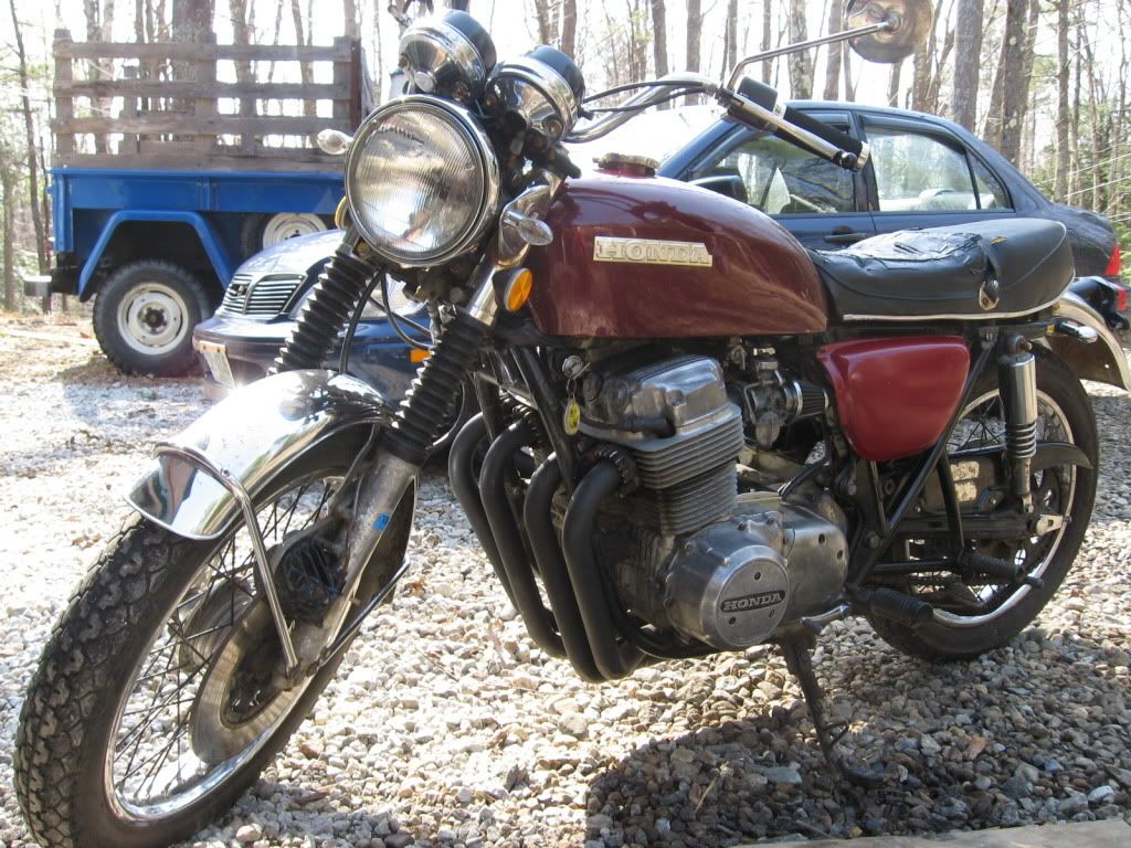

Meet Ol' Rusty. She's a 78 750K. Got her a few months ago. A definite work in progress, but running half decent. I have the whole rugged, worn look thing going on until I can decide on a new seat which I'll than paint along with the tank, til then, the Buick Regal of a stock seat is serving as a** cushion.
I added billet clipons and love the look and ride position.
