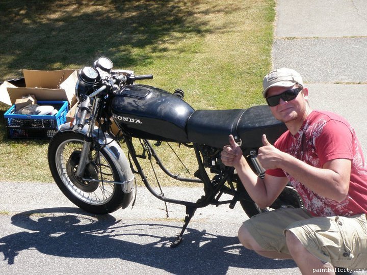

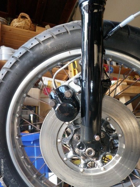

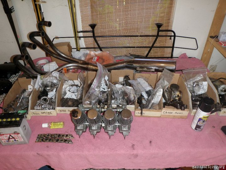

« Reply #6 on: July 16, 2010, 10:35:02 PM »
so here are pics from when i just got the bike home.
« Last Edit: July 16, 2010, 11:59:23 PM by Roach »
1978 CB550K Cafe Racer

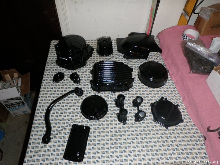

« Reply #7 on: July 16, 2010, 10:50:52 PM »
cleaning stuff up

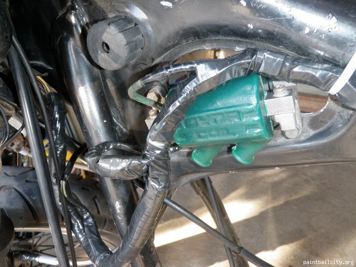

so i put on my new dyna coils but now i need new wires... what should i get?

« Reply #9 on: July 17, 2010, 03:25:02 AM »
why not dyna wires. z1 carries them at a good price too.

Nice! Do you have the black parts powder coated or they came like that?
Offline Roach
  • Posts: 760
Re: Roach 78 cb550 build
« Reply #12 on: July 17, 2010, 02:45:58 PM »
I got them bead blasted then primed them and used like 3 coats of caliper paint sanding between coats turned out amazing.

Aren't the green Dyna coils 3 ohm?
If so, they suck two much power for the 550's charging system.  You can expect dead batteries, (and dead bike) frequently.
Trade them for 5 Ω primaries.

so you were right about the coils they drain my battery alot.... question is what can I do about it other than changing them out. they abviously can work some how..cant they?
other question got new mini indicator markers. got them to blink for a bit then they went dead.checked my flasher its fine. the wiring diagram says that theres a (black,gray and green wire) the black and gray are hooked up to the flasher where does the green wire go? dont see anywhere for it to plug into.

You can reduce the coil power draw some by inserting a 1 ohm resistor in series with the coil power input.  But, it still won't be as low as 5 ohm coils.  I didn't notice if you are using points or a dyna ignition.  The dyna-s will make all coils draw ~30-40% more power than the points do, as they provide far less "off time" to the coils than points do.
Some flashers are three terminals types.  The green wire is a ground for those to use.  Honda says, "you're welcome".
Some flashers are load and voltage sensitive.  As the battery drains away from peak charge, they slow or stop flashing.
The stock flasher was selected to match the stock lamp loads.  Want to be an engineer?  Deal with design changes.  ;D
