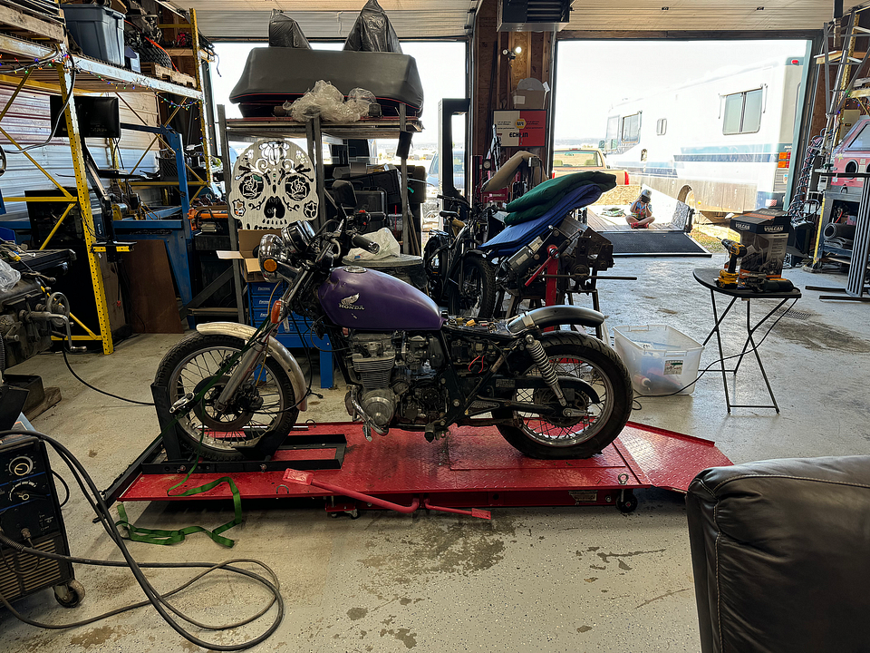

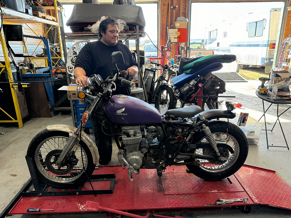

Cash Machine Updates: Background
« Reply #111 on: September 07, 2024, 08:45:55 PM »
OK. Fair warning: I plan to catch up on non-motorcycle things that are woven into motorcycle things. This is therapeutic writing for me, just as much as it is a project blog.
A 12-year gap in a project blog means there's a lot to bring you up to speed.
Since my last project post in 2012, the Cash Machine has mostly just sat in a shed or storage unit. It's primary purpose has been engine holder and a dream deferred. As mentioned in my mini-update, the Custom was the rider, and that's what we did: ride. My wife rode it to work. I rode it all over the Black Hills of South Dakota, our home. Some guy on a bicycle tried to cross the highway in front of me, and I had to choose: hit him, or take my chances with my handling skills in the ditch. I chose the ditch, and ended up barrel rolling through the ditch while the bike ended up in the middle of the highway. That rattled me, and I took a little time off of riding. The bike was minimally damaged because I had gotten down to about 10-15 mph before the back end slid out from under me. I was minimally damaged, too - just a few scrapes and some torn jeans. I was able to ride the bike home, though the fork was slightly twisted and the tank dented.
I ended up buying a 1981 Goldwing GL1100 sometime in 2016, I think. I applied the same meticulous approach I did with the Custom, replacing many parts before I felt it was safe enough to ride. It was a gift to myself for losing 70 pounds, but when I gained the weight back, the brain gremlins convinced me that I didn't really deserve it, so rendering it roadworthy took 2 years. A lot of the skills I gained working on the CB650 applied, particularly rebuilding the carbs. I was really happy to ride it. I take a lot of pride in knowing my bikes inside and out.
Around this time, in 2018, I noticed during oil changes on the Custom that the oil was a pretty glitter color. I was weighing my options, thinking I would do a top end on the engine that came with the Cash Machine. At one point, another CB650 popped up on Facebook Marketplace. The owner was a young airman who had half a mind to make a cafe racer, but he didn't know his ass from his elbow when it came to this bike. He had it listed as a "500 nighthawk", but I knew what I was looking at in the pictures. He must have had to get out of a storage unit, because he went from $1000 to $500 to $100 to free in two days. I was quick on the draw and snapped it up for free. It was a rolling frame with the engine in it and a box of random parts. After hauling it home, I tried turning it over, and it spun freely with good compression. I did a quick engine swap into the Custom, and it ran and rode just fine! Not a bad score, if I do say so myself. The Cash Machine remained an engine holder, for its own seized engine.
My wife rode the Custom from time to time, but we were trying for a family. She felt that riding was an unnecessary risk, and it spent a lot of time in the shed/driveway/garage. Then the pandemic hit, and we were forced to stop fertility treatments. We went on a few rides together, her on the Custom, me on the Goldwing. The last one was on July 25, 2020. Coming around a gentle curve in the hills, we saw a car coming from the opposing direction that looked like it might have been her parents. They were a little over the line. I glanced in my mirror and saw her headlight behind me. A few moments later, I looked again and she wasn't there. I pulled over, and after a minute, she didn't catch up. I had been working on my slow speed skills, and I U-turned that Goldwing on a 2-lane road, feet up, no duckwalk and went back. She was in the ditch, and I will spare you the details beyond there were bones on the outside and a lot of blood. Of course, since it was during the pandemic, the hospital wouldn't let me in to see her, so it was a long 4 days before she got to come home. That really rattled me, and I didn't ride again for another 2 years.
Come 2022, I was just getting my nerve to ride again, going on longer and longer day trips around the Hills. At the time, I was a staff developer for the local school district. Basically, I taught teachers. A few days before school was supposed to start, I was informed my position was dissolved and I could either return to the classroom or resign. I chose to resign. To keep us afloat, I sold the Goldwing (for a tidy profit, nonetheless, even with what I had spent on parts). The Custom and Cash Machine remained in the shed; the Custom actually sustained fairly minimal damage in the wreck. A new instrument cluster, brake master cylinder, and maybe some time trying to repair the fork stops would have rendered the bike rideable. I just couldn't bring myself to fix it and ride it again, after seeing it upside down in the ditch next to my badly injured wife.

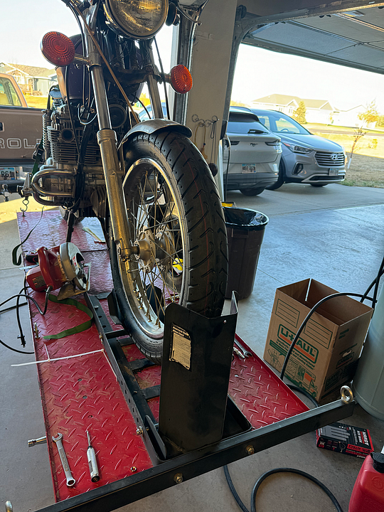

Where we're starting:
If you look carefully at the instrument cluster on the purple bike (aka the Custom), you can see the clocks are pushed back at a funny angle. Results of the wreck.
Seized engine out of the Cash Machine. If the odometer is to be believed, this engine only has about 10,000 miles on it.
The results: A machine with no engine. Go me. Also, I think you can really see the difference in rake. Remember, the Cash Machine is raked an additional 5 degrees.
Turns out my little Black and Decker convertible hand truck fits the engine quite nicely for moving about the shop.

The fork tubes were not obviously damaged in the wreck. This supports our theory that T was going slowly when she went off the road. Both bikes, no forks.
Alternate view of the headless bikes.

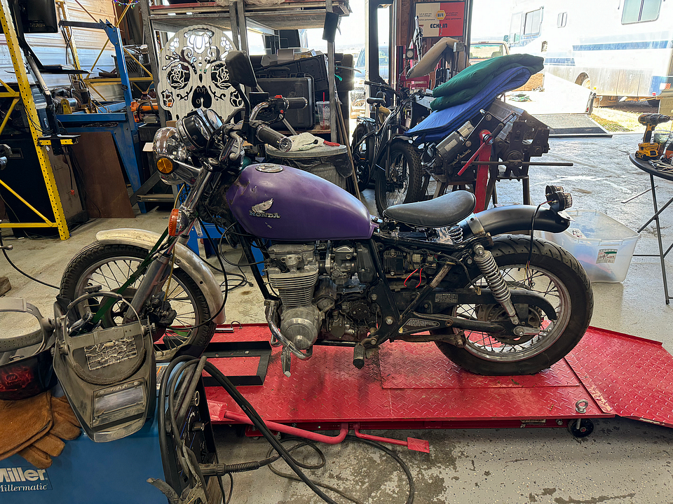

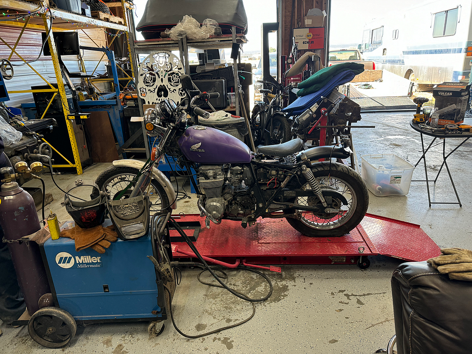

The Custom, with standard forks. These are 3 inches shorter than stock, and the whole thing leans forward. Pulling it off the center stand slams the kick stand into the concrete, and the kickstand basically makes the bike stand upright, in danger of tipping over.
The whole stance of the Custom is different.
The Custom's forks installed on the Cash Machine. Brake parts and the wheel seem to be interchangeable.
Where we finished the night: Forks successfully swapped. The stance of the Cash Machine is subtly, yet noticeably leaner than before.
Gotta sit on it, just to taste the flavor. Get your mind out of the gutter. Ya perv.
A second look.
Side by side comparison. Where we started on bottom, where we ended on top. Notice the back wheel of the Cash Machine is a little closer to the back of the lift in the top image. Subtle... but the difference is there.

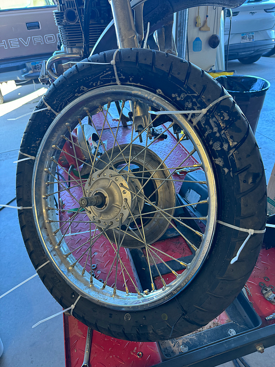

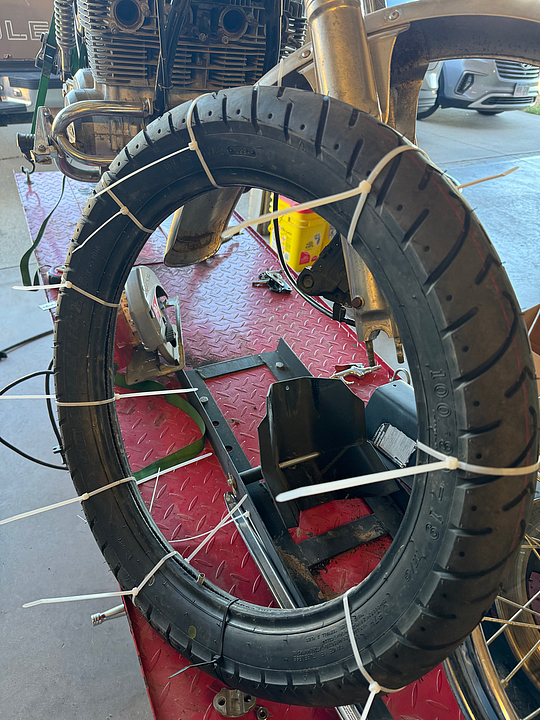

I reread my old posts and noticed that I had a running total of parts, so I figured I could start that up again. Here, in no particular order, are the parts I've ordered so far.
Spark plug boots - $22
Rear tire - $96
Rear rim strip - $7
Front tube - $19
Integrated tail light - $19
Front rim strip - $6
Main fuse - $8
Spark plug wire - $12
Front tire - $72
Rear fender - $42
Sprung solo seat - $36
Dyna beads - $21
Total: $360

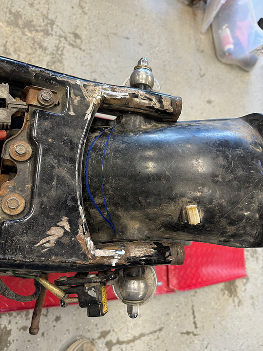

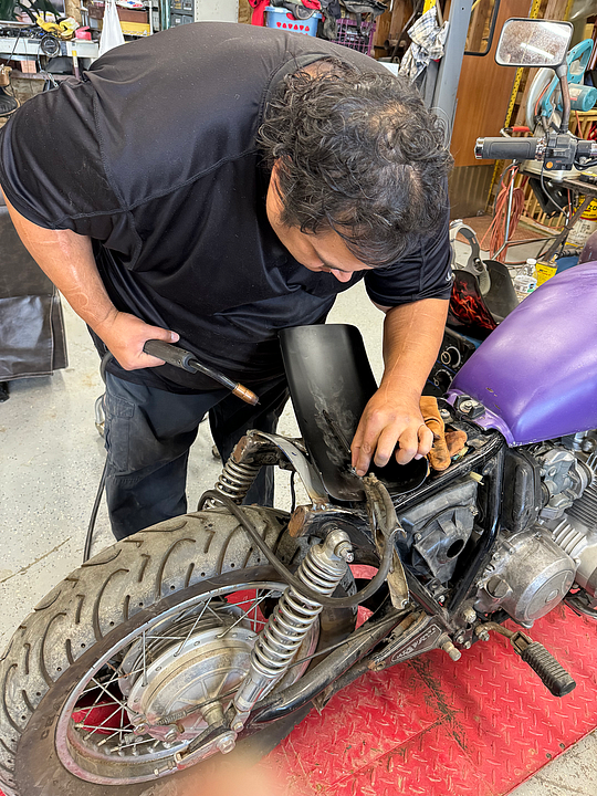

We started with the rear fender. When I modified the frame in the first place, I cut off the butt of the bike. This meant the plastic inner rear fender needed to be adjusted. I placed the plastic fender in and used my calibrated eyeball to draw a cutting line. I was able to use tin snips to trim the ABS inner fender to size.
IMG_1714.HEIC
Hook 'em while they're young! My son, Owen, wanted to see how he fits on Dad's motorcycle.
IMG_1715.HEIC
I figure if I get him hooked on motorcycles, he won't have money to get into drugs.

We placed a bracket (the gray piece spanning the gap between the upper shock mounts), then drilled through the bracket and fender. We welded a nut on the inside of the fender to anchor the fender down. I also drilled holes for a couple of small 10-32 screws and fender washers to connect the metal fender to the inner plastic fender.

From the side with the fender mounted. I am very pleased with the lines. Not bad for using a generic fender from Amazon.
IMG_1720.HEIC
Seat mounted. It's a sprung solo seat, generic from Amazon. I attached the front to the gas tank bolt and welded a couple of studs for the springs to mount to. I'm a big 'ol boy, so I squish the springs quite a bit.
IMG_1721.HEIC
We then mounted the taillight/turn signal. I haven't decided how I will run the wiring, but I plan to use some throwover saddlebags, so I'll probably just let them run on the surface. Function over form.
IMG_1722.HEIC
Caleb also has a tire machine, so we went to mount tires. We were... mostly... successful. We got the rear tire and tube mounted with little struggle. The front tire put up a fight, and ended in us discovering we pinched the tube. So, I'm saying we were 75% successful in mounting new tires.
IMG_1724.HEIC
A few days later, I got a couple of Harbor Freight tire irons and a new tube. I was very careful to not pinch the new tube, and as gently as possible wrestled the tire onto the rim. I aired up the tube to seat the bead... and heard a hiss.
The hell with it. I went to the farm store and got a tube patch kit and patched the hole. I know this is potentially a questionable practice, but I'm doing it.
To figure out how to mount the tire with the tube and not pinch it (after all, I'm far from the first person to do this) I went on YouTube and checked out some videos. The only tip I picked up that I hadn't tried was to slightly inflate the tube. Then I remembered the zip tie trick, and just happened across a video of someone doing it with a tubed tire. The video went pretty slick; the guy was able to get the tire on the rim without irons. So I tried it.
IMG_1850.HEIC
The trick was to get the tube inside the tire, then pinch the beads together while tightening the zip ties. The goal is to get the beads to act as a single bead that can ride in the center groove inside the rim. Once I got the zip ties placed, I put a squirt of air in the tube to make the valve stem stand up a little firmer. It went almost as slick for me as it did in the video!
IMG_1851.HEIC
The new tire seated on the bead just fine, held air, blew up and deflated just fine. Now the Cash Machine has new shoes!
IMG_1852.HEIC
