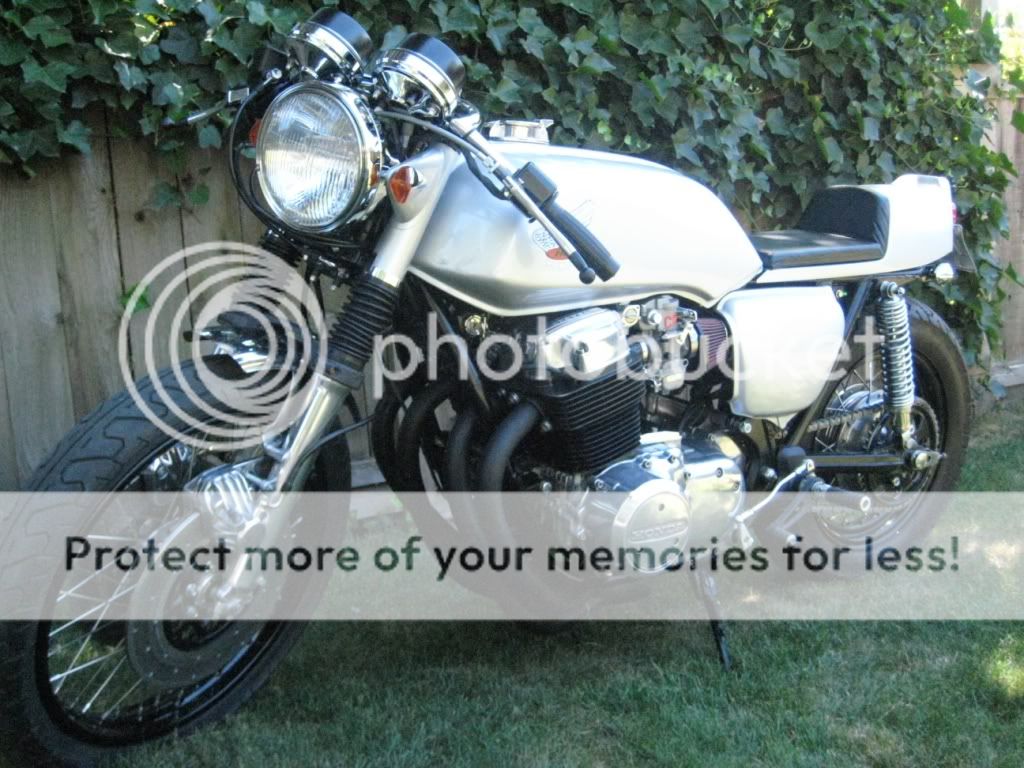

Hey Guys, first post hoping you can help.  Here is some background.
I have spent the last two years building a cafe out of a 73 cb750.  My teething process has been long and painful thus far.  I am not new to restorations (cars and bikes) and for the most part consider myself amply qualified to wrench.  I will do everything except tear into an engine.   That being said i have reached a level of frustration here and am close to putting the bike away for awhile.
Here is what i have done to the bike:
836 with dynoman cam
29mm cr smoothebores
Dyna ignition and coils
New wiring harness
everything is new or rebuilt.
When i first got it together it started to smoke almost right away and was pissing oil out of #2.  Tore it down and found the head gasket went.  My mech wouldn't warranty it and i ate it.  Rebuilt it and put a mild cam on the second go around.

Good looking bike and I like your tank! How did you get it to fit?

Thanks for the compliment Andy,  At last someone who shares my pain.  I have a multimeter and have done a multitude of tests, hence the part replacing.  I could throw down for a new batt but i'd like to be sure it's nfg.  More testing i guess.
As for the tank,
It involved a lot of cutting, grinding, brazing, welding, filling, sanding and painting.  I do like it tho, it really matched the cowl.
I cut most of the factory mounting points off except for the front frame mounts.  I then brazed some threaded pieces that aligned with the airbox mounting tabs.  I had to ease some of the pinch welds to clear the carbs too.
