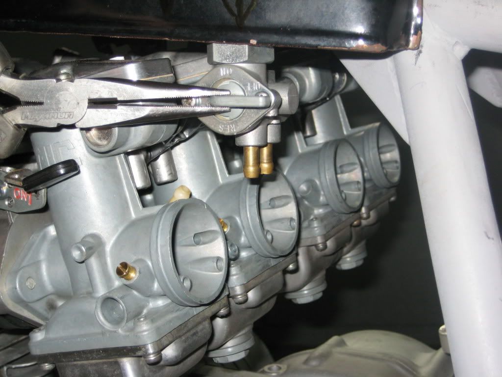

I fiqure something catchy might cause the right person that can help, take a peek.  ;D
Check the picture. I need to change location of the tank nipple to accomodate my carbs. Naturally the petcock I have (already bored also  :P) to feed these runs the fuel lines down in front of the intakes.
Can anyone tell me if there is a Honda dual port petcock with the nipples 90 degrees to these? The tank is a 400F with a 20mm boss, but I can change boss size to suit a different size petcock.

if it is a 20mm boss you can buy a late model harley petcock and tee it to run to your carbs.now when i say late model i mean early 80`s to late 90`s.

Thanks Mark. Is there a good place to go online where can get a view of such a valve?
