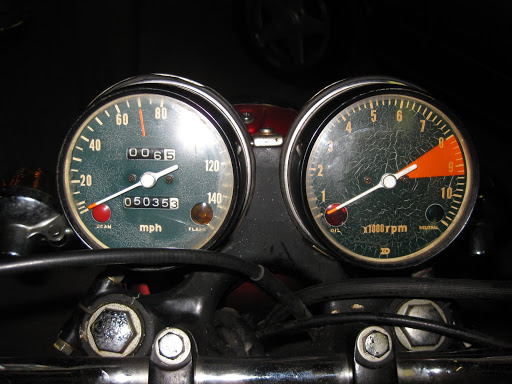

I have two nice K1 gauges on my late K0. I am wondering if these gauges are convertible to K0 gauges by replacing the faces and the covers? With other words: is the inside and the lower half the same as the K1 gauges? The signal lights are located at the same position and the diameter is the same.

I have thought of doing the same thing, the gauge frame or the bottom case is different and slightly higher on the K1 than the one on a k0 but if the rim that the the stainless crimp ring  crimps over was ground off it may work, i am not sure if the diameter on the K0 is less than the K1 it would be worth checking that first Mt

The face plates are obviously different. The faces I have are unfortunately worn by the sun. :

Thanks for the picture. Your K1 face is about the same condition as mine, so I'll pass.
The biggest problem I'll face in replacing just the Speedo Face is: will the colors match the NOS Tach? That may be why Yamiya only sells them in pairs.

Compare both images:
The stripes are too close to the edge
Some figures are located on a slightly different position, like 140, 80 on the speedo and the 8 on the tacho.
The red surface must stop with the stripes, on your faces it stops at the edgo of the face.
the letters of the 'mph' and 'rpm' signs are too close to each other
there is too much space between the two middle stripes between 1 and 2 on the tacho
Some people would say: what are you talking about, but these minor differences are for me very important.
