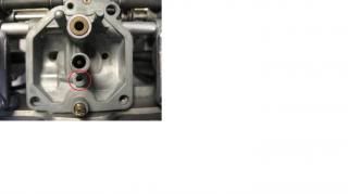

i know this thread is old, but im just starting on my first bike. how did you remove this piece?

Spiffy, that is the pilot jet hole.  There is nothing in that picture to remove, but if yours has something in the hole, it's the pilot jet.  Just grab the jet with pliers and pull straight out.
