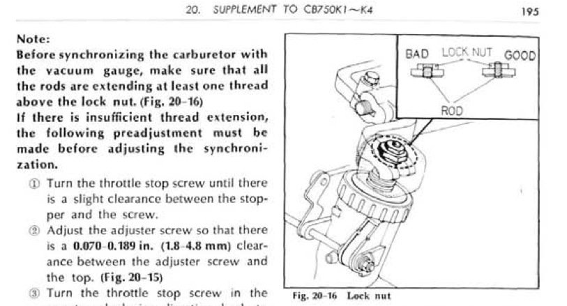

Was doing a bench synch on a set of 72' 750 carbs last night , went with the flash light method , and got em' pretty dang close to lookin even across the whole rack, but, according to the SALOCAL web site , they want " no more then a couple threads above the lock nuts, NO MORE!" is this absolutely impaerative ? if so, why ? I keep coming up with a few more threads on one side then the other and its driving me nuts , or am I just over thinkin' this ??

The manual says the same thing.
I imagine that if there's too many threads above the nut the slides and needles might not be able to close fully.

Thanks cycleranger, I have the 657A, where did you get that page ?  It is not in my manual, I have the downloaded Honda one, must be missing ,guess i'll  have to give it another try, clip is in the 3rd notch down , if that makes a difference.

Full CB750 shop manual in PDF available here: http://www.honda4fun.com/man_officina/man_officina.html
Here's the part that has the info about K1-4 carbs where I got that image.
http://www.hondacbfour.com/download/man_officina/pdf_manuali/CB750_K-F/CB750_5.pdf

Keep comin up with pretty much the same results, #1 - 2 threads, #2 - 2 threads , #3 - almost 3 threads , #4 -3.5 threads,.thinkin im just gonna put em and see what happens, im just overthinkin this waaayyyy to much  >:(

The arm that lifts slides 3 and 4 may be cocked lower than the arm that lifts 1 and 2.  Their is really nothing you can do here as the arm is located by a bolt and a flat on the rod it runs on.  Sorry if this sounds strange but when you look at the carbs with the tank off you will see what I mean.  Try to adjust the location of the arms by loosening the lock nut and looseneing and tightening the locating bolt on both arms.
