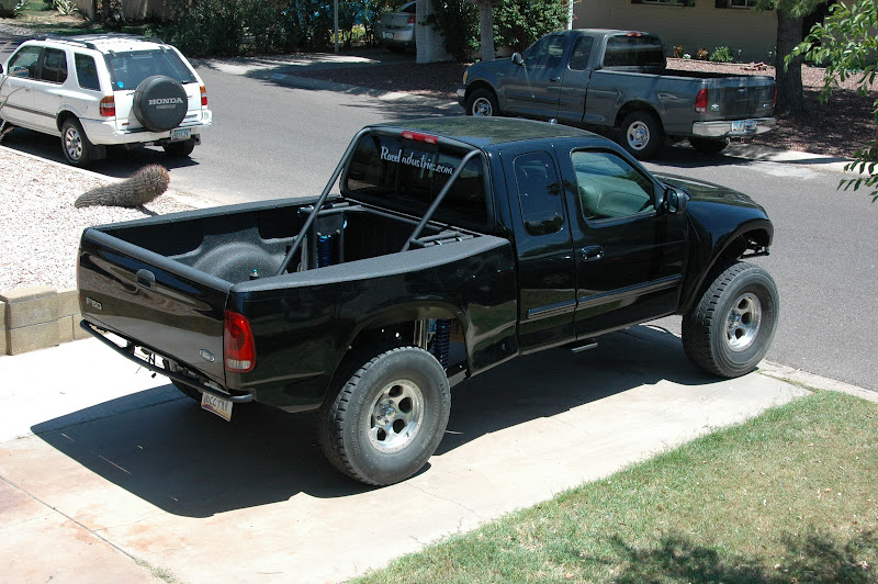

Yah was contemplating copper. Don't know why, maybe because it's different. I build industrial furniture for a living and am always looking for something unique.
The single shock doesn't sound that hard to do, would look pretty nice too.

A monoshock should be easier than my truck build, probably...
