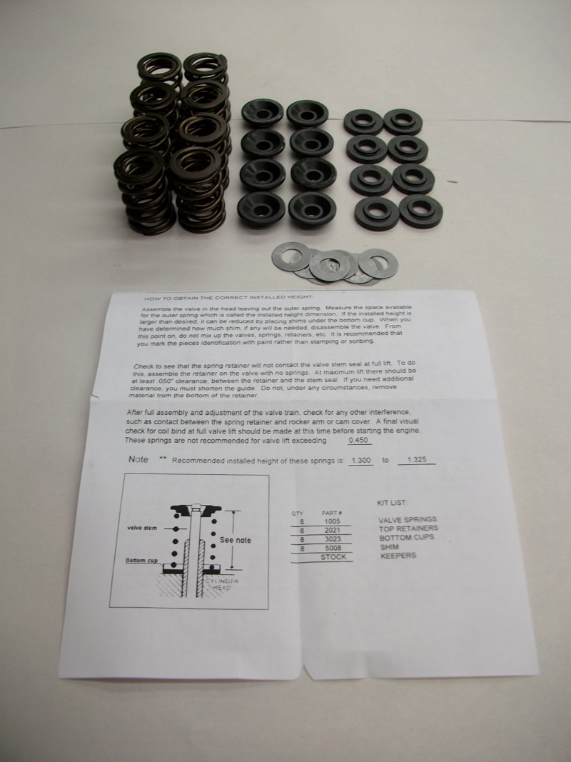

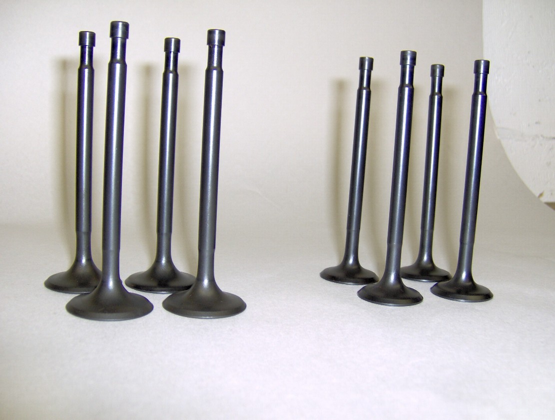

Would this setup be okay?
Cyclex springs/alloy retainers:
http://www.cyclexchange.net/index%20pics/hondacb750racingsprings.JPG
Cyclex superflow valves:
http://www.cyclexchange.net/index%20pics/our%20valve%201.JPG
F2 carbs
Stock bottom end (F2 bolts of course, but stock rods) + 836 10.25:1 compression + APE head studs?
I have all of these parts, I just don't want to overpower the bottom end, or end up having the bike run like crap just because it's the cam I have on hand. I have an F2 cam otherwise I could run, or I could sell/swap this cam if you guys think I shouldn't run it. Would the bike idle okay, and would I make power without pushing the bottom end too far?

 If you really dont want to run it, I would trade for a new stock cam.. Are you in Canada ?

It's not that I don't want to run it, I'm just paranoid (because I'm not upgrading rods) that one of my rods is not going to be happy and buckle, or just peace right out  :o I'd love to eventually build this engine up, but considering this whole project was a basket case, I'd rather put the engine together and see how it runs, then go back and start replacing the big money items. I do have a several stock K cams and an F2 cam to run if this doesn't work out, but at the same time I'd hate to loose performance just because I'm intimidated by a big cam  :P

There is 2 836's in town here with cams, springs, stock rods, that have made  at least 500 runs at the strip, and stayed together.. yours could too, No guarantees, but it has been done a lot..
 What do you have to lose.. ???, used motors are 100-150 bux. If you can afford good rods run em..if not, stick to small 836 motors..
