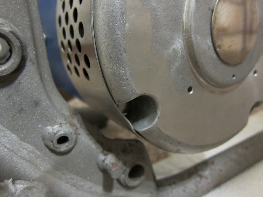

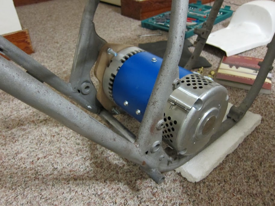

Had a chance to try out a mockup of the front motormount. It's made out of MDF, which was strong enough to hold the motor up for the purpose of a mockup, but barely. I also tossed the battery analogs in to see how much clearance I have. I think I'll be okay, but the rear mockup is a sort of "clamp" that goes around the whole motor, so I'd rather mock that up as well just to make sure I have enough clearance before milling it.

That motor looks a bit open to the elements.  Is the plan that it will be a fair weather only bike?  What about dust?
Luckily the majority of the motor is behind the batteries, but I may consider creating a shroud to cover the ports that seem most susceptible to the elements. I'd hate it to be just a fair weather bike, but that may be something to discuss with the guys on the other forum who have more experience. I know a few of them got caught in the rain and didn't have anything bad happen to their bikes.

1. You must know this, but the photos remind me... You want the shaft of that motor located as close as possible to the stock countershaft location, to maintain good chain geometry.  I don't know enough about these bikes to be able to tell from those pics.
2. Even when you're just mocking up, use washers.  If you use some nice big fender washers that MDF mount is less likely to break and cause you heartache.
I based my mount off the original chain location, so I'm hoping it's pretty close. The other guy I know who built an electric bike on this frame had a very similar shaft placement. I don't have my sprockets or chain yet, so I can't guarantee chain placement until those ship. I'm ordering from a company called Rebel Gears, who cuts custom sprockets for a good price.
